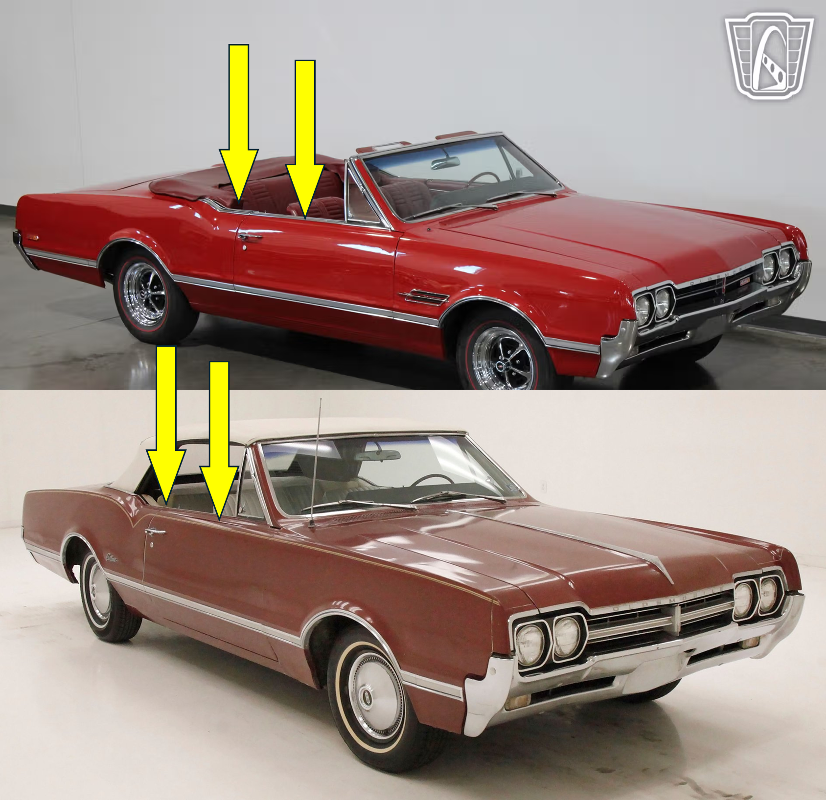

I am struggling to find new window sweep/fuzzies for my 66' 442 Convertible.I am just looking for the outers as the inside sweeps are attached to the inner door panels and inner qtr window panels. Are these what they call special moldings or OEM style. Most repro places sell an 8 piece set.... and OPGI sells a 4 piece set that I am not sure if that is what I want? My car is in storage and hard to go see right now. Have others struggled with this also?
Old Mar 12, 2026 | 06:41 AM
"Special moldings" are the RPO B85 wide anodized aluminum trim on the tops of the doors and quarters. The red car has B85 trim. Otherwise, there will just be the thin stainless bead on the outside of the rubber sweeps, as seen on the brown car.

Thanks Joe... that's what I wanted to see!
