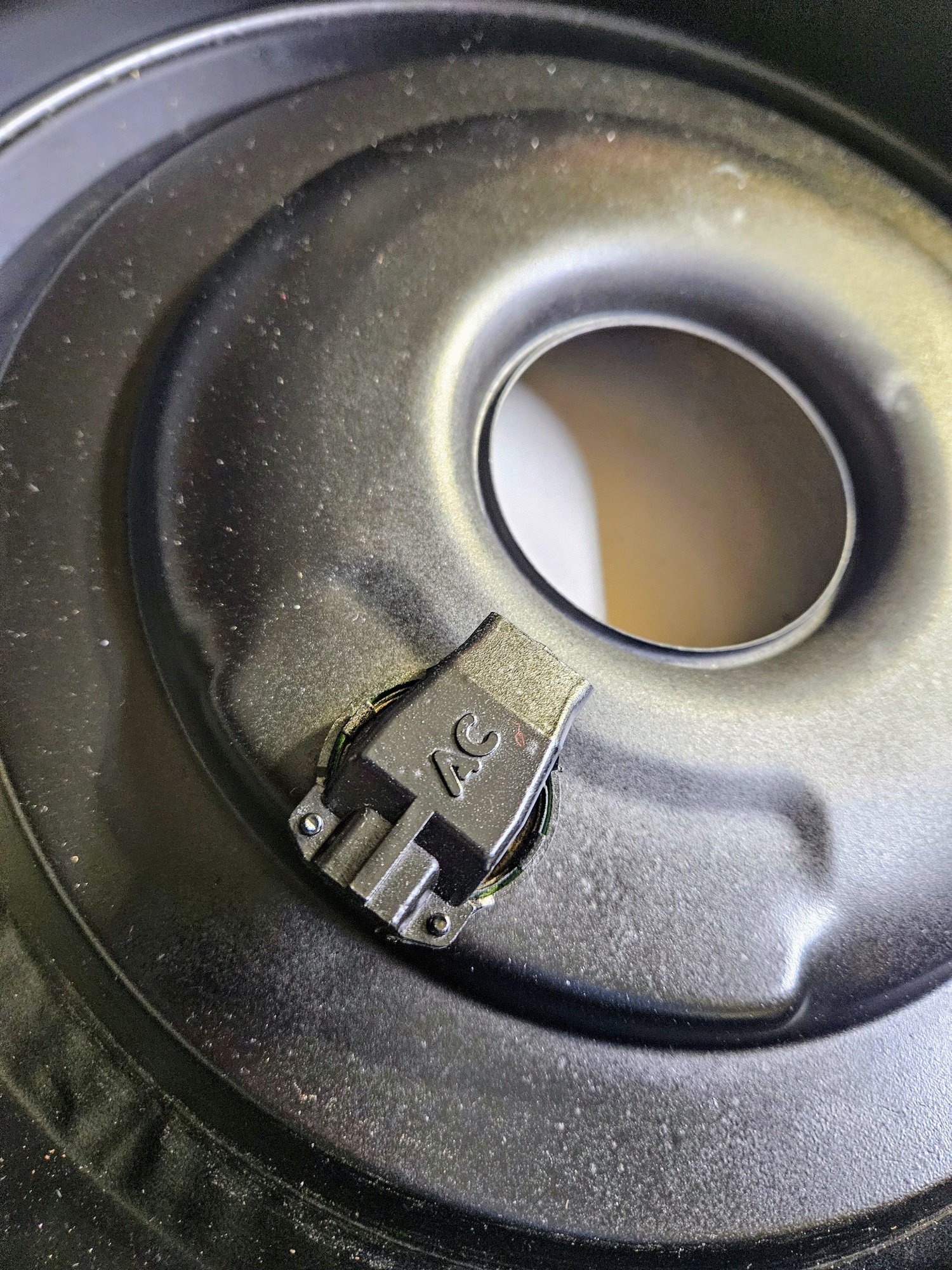

What is this part called?
Old Feb 22, 2025 | 12:52 PM
Cpmman's Avatar
Joined: Dec 2024
Posts: 26
Located inside the air cleaner with two hoses attached underneath.
Also what is the purpose and where can they be bought today?
Old Feb 22, 2025 | 01:49 PM
Loaded68W34's Avatar
Joined: Jul 2020
Posts: 1,942
From: Pennsylvania
It is a thermal vacuum switch. It operates the door in the air cleaner snorkle. It keeps the snorkle door closed to pull hot air off the exhaust manifold until the engine warms up. Once the engine is at operating temp, the switch allows the snorkle to pull fresh air. If yours is broken, here is a link to a new one:

^^^ Air cleaner thermal vacuum switch.

Old-school analog version of the IAT sensor.
