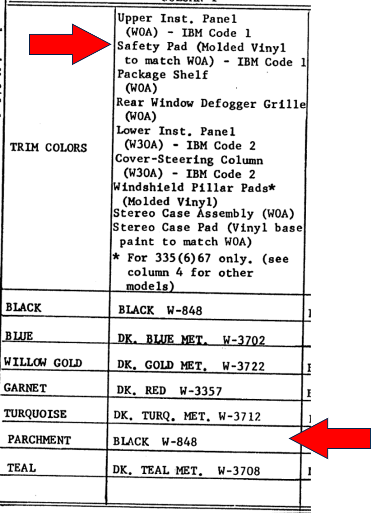

Thank you for the replies. Could you get a white dash?
No. Cars with white interior came with a black dash. The table in Section 0 of the 1968 Product Information Manual documents this.
I'll also add that while the VINs were different, the Supreme is obviously just another Cutlass/F85 body shell. The only substantial differences between F85, Cutlass, and Supreme were exterior trim, interior upholstery pattern and material, and standard equipment included in the base price. For example, the Cutlass came with either an I6 (335...) or L65 350 2bbl motor (336...) as standard equipment. The Supreme came with the L74 350 4bbl as standard equipment, however the L65 2bbl was available as a $33.70 credit option.

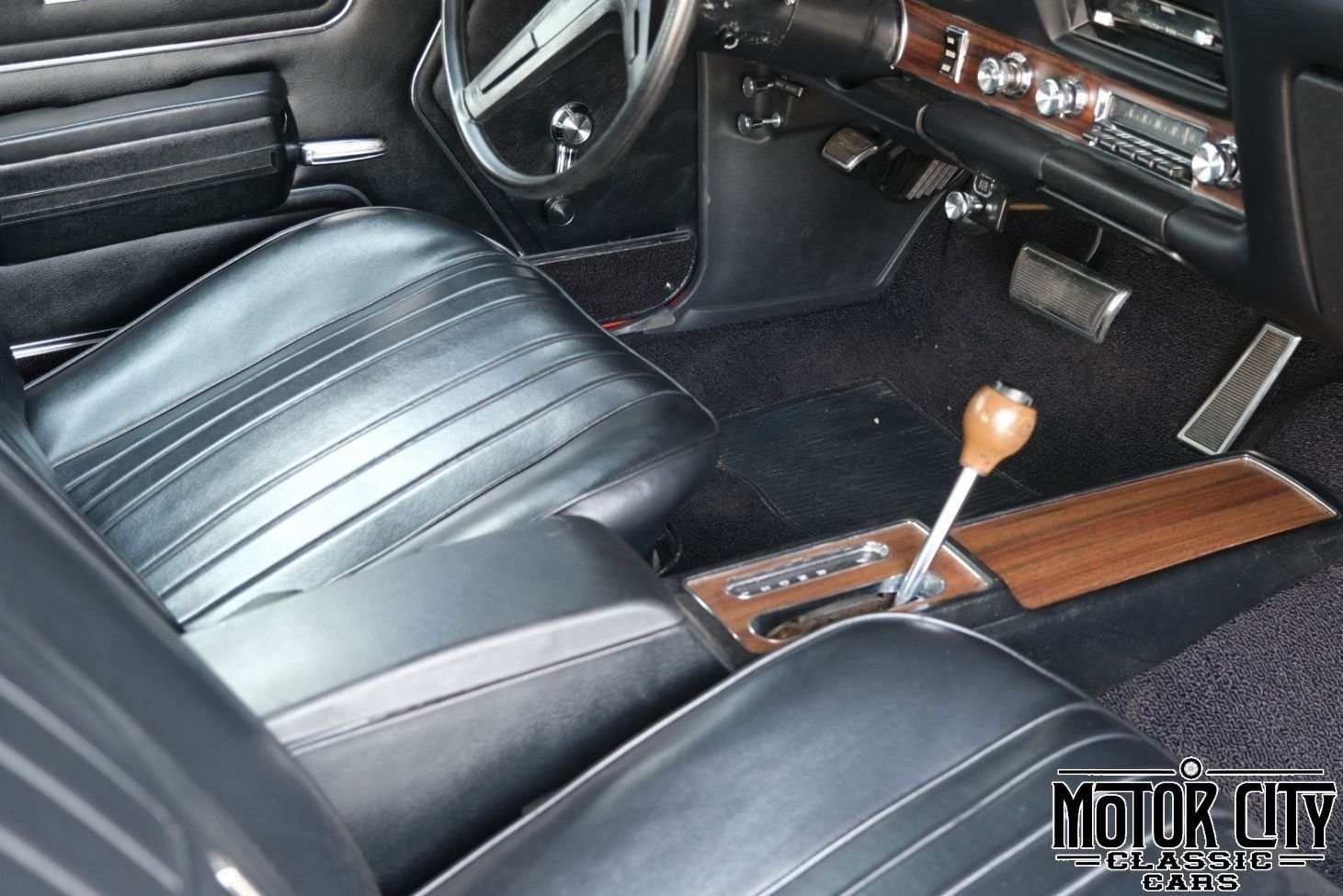

It looks like the console is missing the top portion of the glove box, the door panels look to me they were recovered
Old Jan 27, 2024 | 08:18 AM
Posts: 15,409
The console looks odd like unlike a 70 console.
I agree. It is missing the lid, but still does not look like the console in my car.
Old Jan 27, 2024 | 08:20 AM
That's a Pontiac console. Just look at the width of the woodgrain in front of the shift lever. Not even close to a 70-72 Olds console. Apparently hacked up to fit the Olds shifter.
Old Jan 27, 2024 | 08:42 AM
That's exactly what I was thinking Joe. You can tell if you look close.
Old Jan 27, 2024 | 09:22 AM
Bfg's Avatar
Bfg
Posts: 2,288
Joe nails it again! The car is definitely hodgepodged

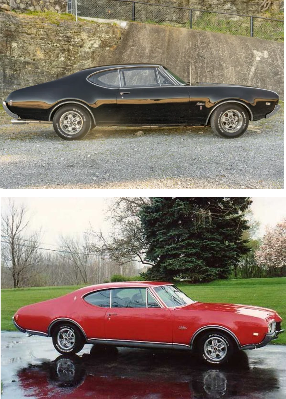

The only difference that I see is the Supreme has moldings running down the lower side of the car and a CS in the roof, other than the different interior. I wonder if there was any weight difference?
Old Jan 28, 2024 | 12:11 PM
  #35
For 1968, the Supreme came with the lower stainless and argent paint below that, per the photo I posted. Cutlass S (and 442) got the stainless along the top of the fender. Emblems were different (CS on the sail panel vs S under the Cutlass script on the fender). For 1968, Supremes got the same "single loop" tail light lenses as did F85s and Cutlass four doors. Cutlass S and 442 got the "double loop" lenses.
As noted, upholstery patterns were different. FYI, the Cutlass S and 442 used the same interiors and exterior trim, which is why the 68-69 442s initially came with 336xx cowl tags. For 1968, the Supreme 2drs came standard with bucket seats; the RPO A65 bench with arm rest was a no-cost option. The 442 also came standard with bucket seats, but the credit option RPO A52 bench seat was the normal non-armrest version from the Cutlass S. Cutlass S cars came standard with the bench seat (except the convertible, which got buckets); buckets in the S were a $68.46 option.
The big difference was in the standard engine. The S (and all other Cutlii) came standard with either the I6 or the RPO L65 350 2bbl. The Supreme wasn't available with the six and the standard engine was the RPO L74 350 4bbl (though the L65 350 2bbl was a $33.70 credit option in the Supreme). Both S and Supreme came standard with the Saginaw column-shifted three speed and manual drum brakes.

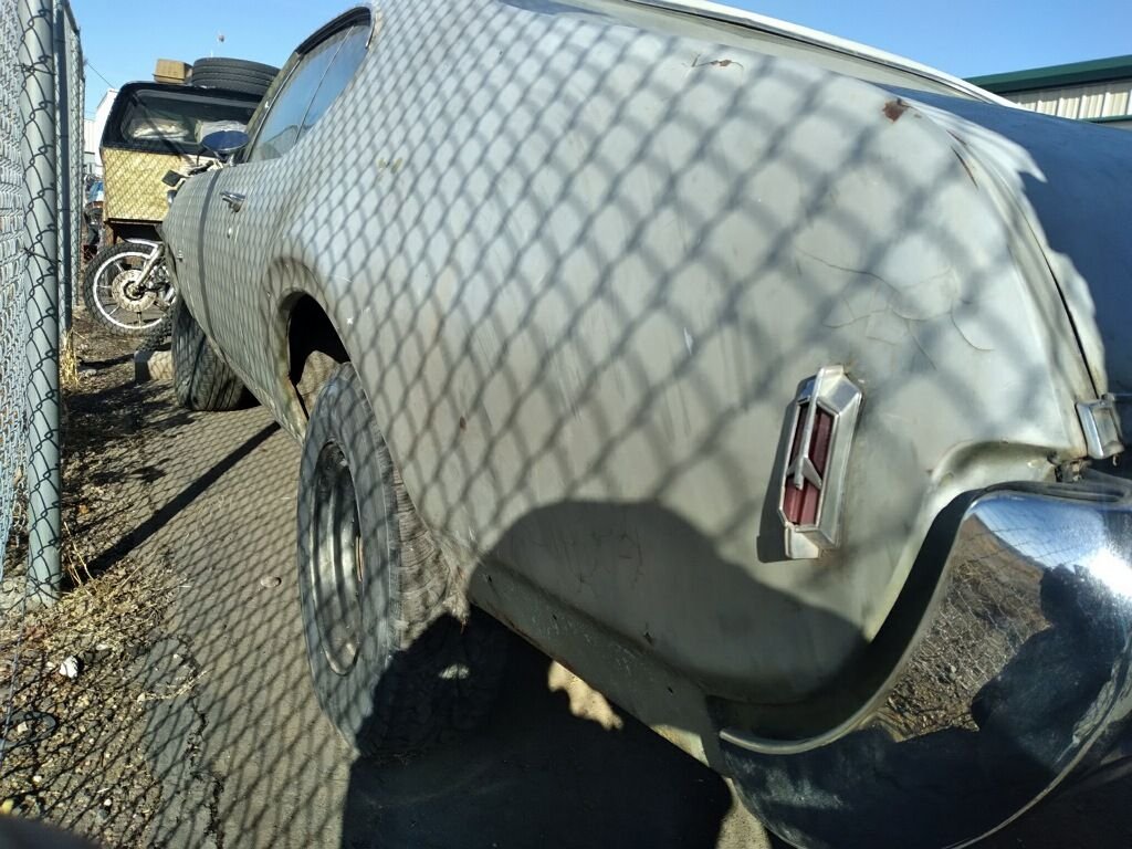

This car appears to have the holes for the Supreme trim. I don't have good pictures of the driver's side but in the one I have you can see the holes.
