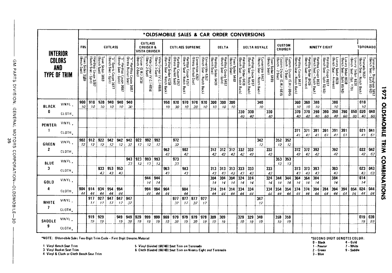

Here's the specs sheet for the model. Quite a lot of options were available for the straight Cutlass.

There were no "options". Each model line typically got model-specific upholstery patterns. Low-rent F85s got different upholstery and door panels from Cutlass and Cutlass S, which where different from Cutlass Supreme. Vista Cruisers typically got the Supreme patterns. Trim code on the cowl tag will tell you exactly what the car was born with.
