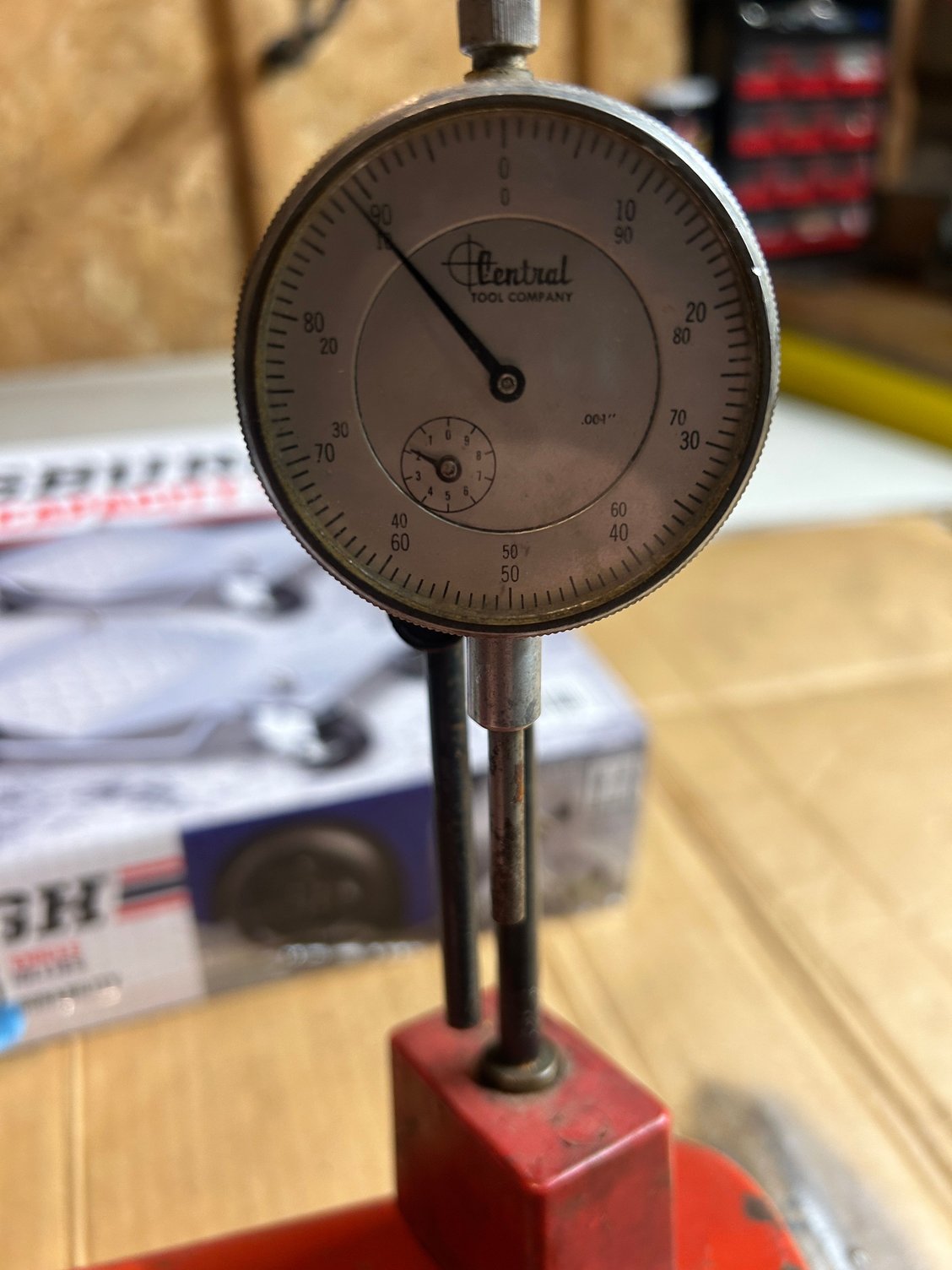

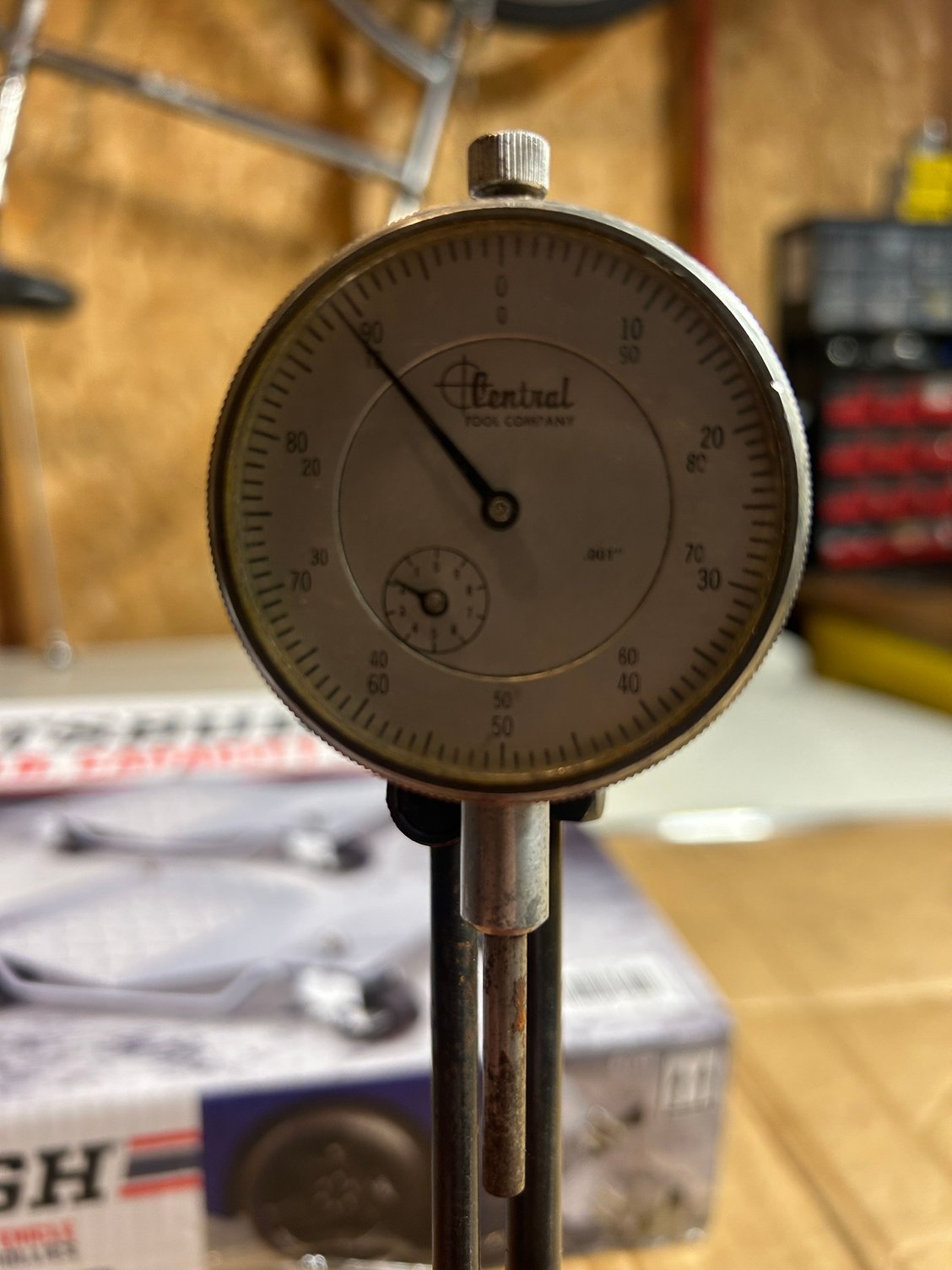

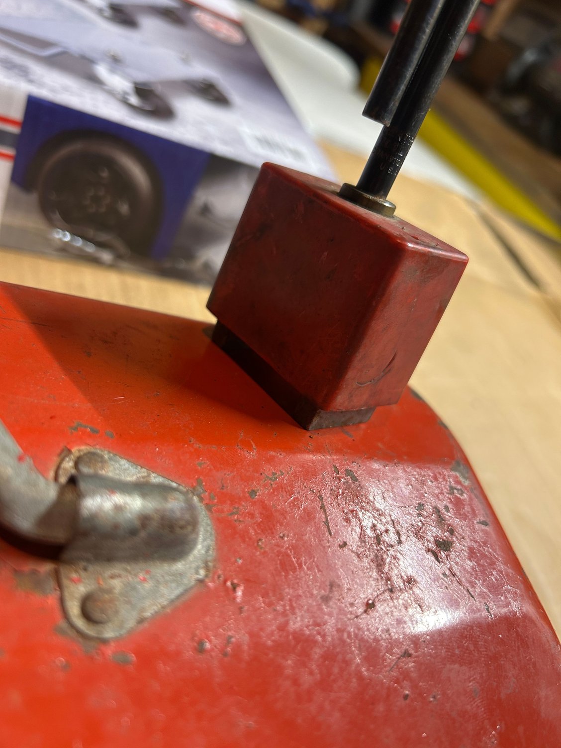

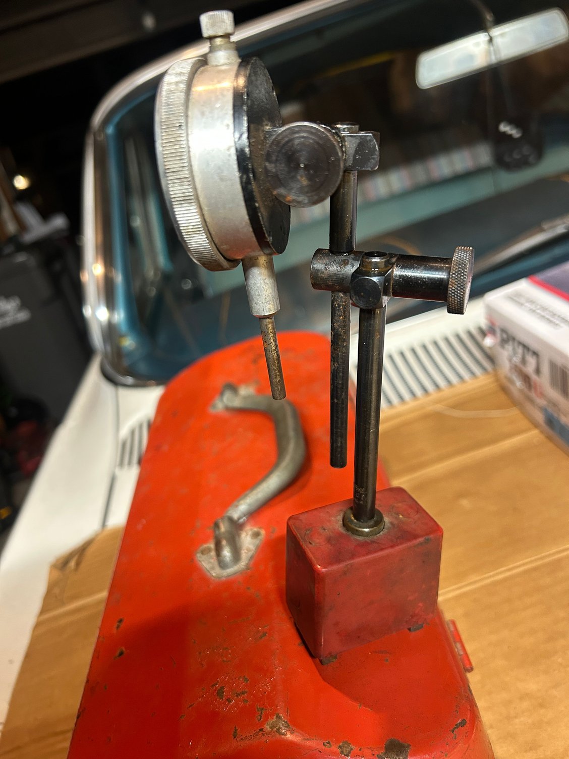

What is this device?!
This was in a tool box of random tools that my uncle had stashed away. He was getting rid of stuff. Can anyone tell me what it is? Thanks all!

It's a dial indicator. It's typically used to set the backlash on differential gears, check out of round on brake drums, warpage on brake rotors and much more.

Mike, thats a one inch travel dial indicator and magnetic base. You can use it for a multitude of things like finding TDC on a piston. True, you have no use for it now, but when you do, you'll have it. .

It can also check for wheel and axle runout in case of either being bent. I would keep it.

Is the movable contact on the dial indicator corroded? Make sure you clean that off so it doesn't get worse.

It checks things that move, not just things that rotate.
As Ralph said, it can check when a piston reaches TDC. Yes, things that rotate can be checked for runout as well.

As far as cleaning it up a bit, getting some of the surface rust off, what's the best way to go about that without harming anything on the indicator? Emory cloth?

That is a Central Machinery (Harbor Freight) dial indicator, identical to the one I bought from the "tool truck" in the 90s. Originally came in a blue or red plastic box like the photo below from an ebay auction. Reasonably accurate. In the condition yours is in, worth about $20. Clean the metal parts gently with 0000 steel wool and penetrating oil to remove the rust/corrosion. Might be worth $30 then. BTW, I also have that exact tool box as well. 👍
