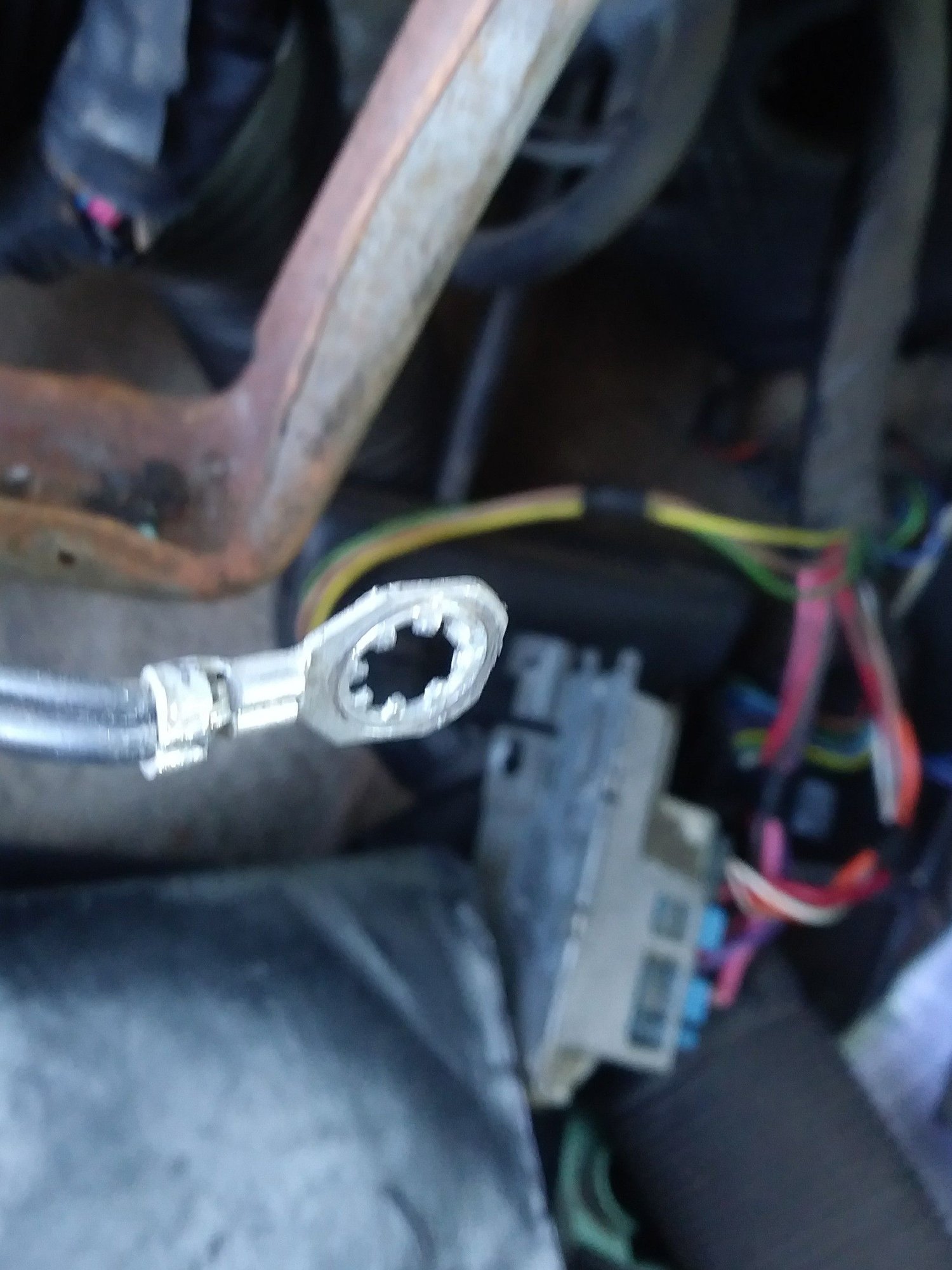

Lol guys. What is this called? I need to go to home depot to get some.

Take a pic with your cell phone and take that with you. If its automotive, try an auto parts store. Maybe you can find something at Home Depot.

I call them "ground things" but i know if i say that at the store, it would be no help

A locking ring terminal?

I've never seen them at Casa Depot, Automotive shop would be a better bet

It's a ring terminal. The ones for "regular" electrical connections do not have the teeth; that one does so it's probably for a ground connection. You likely need to look at an auto parts store as stated above.

I think if you google "star ring terminal" you will be close.

dorman probably has a ground strap in the help section of your autopart store
https://www.dormanproducts.com/p-16557-85669.aspx

You probably won't find one in a modern parts store or big box store either. You might be able to find a smooth ring terminal and a star washer that can be put under it though.

The Ace Hardware near me has a whole wall of small bins with these type of electrical fittings.

It's a ground strap serrated washer end - but you probably have it bought by now lol
