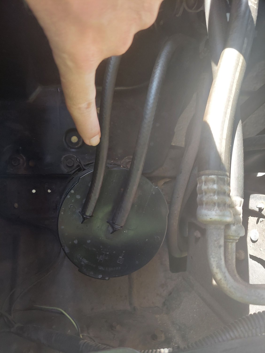

what is this for?
After my engine was rebuilt, this was not hooked back up. I have been looking through the CSM but have not found any reference to it yet. It's located behind the passenger headlights. If I had to guess, I would say that it had something to do with the Carb because there are 2 hoses coming out of it. One is labeled "tank" and the other "carb". The one for the tank is still connected, but the one for carb is just dangling. Since my Quadrajet was toast (fuel intake completely stripped out, and could not be rethreaded), it was not connected back up to the new Edelbrock Performer that he installed. Should I plug the line? Any ideas?

It's the evaporative emissions charcoal canister. All it does is recover fuel vapor from carb and fuel tank and allow it to be sucked back into the carb and reburned. Doesn't cost anything to run it and it will only affect performance if the air filter under its bottom plugs or the activated charcoal bed inside it gets packed too solid.
Look in the emissions section of the CSM. Should be a subsection of the engine section.

Look in the fuel and exhaust systems chapter, starting on page 8-4 in the 1971 CSM.
Thanks. I was looking and re-reading through the engine and carb chapters. I never even considered that it might be an emission control device.
Learn something new every day.
