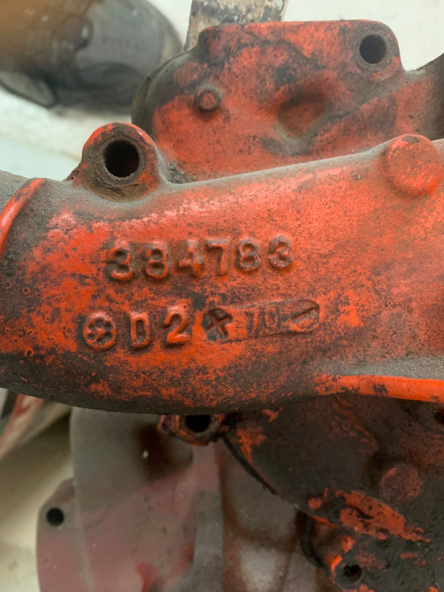

Water pump I.D.
Anybody know what this pump is designated for?

The 384783 casting number was used on water pumps on 66-67 motors without AC.I also believe 65 but not 100% sure.

Casting 384783 is a 5.1" pump used on non-A/C, non-HD cooling cars from 1965-70. The part number for that pump is 388182.
