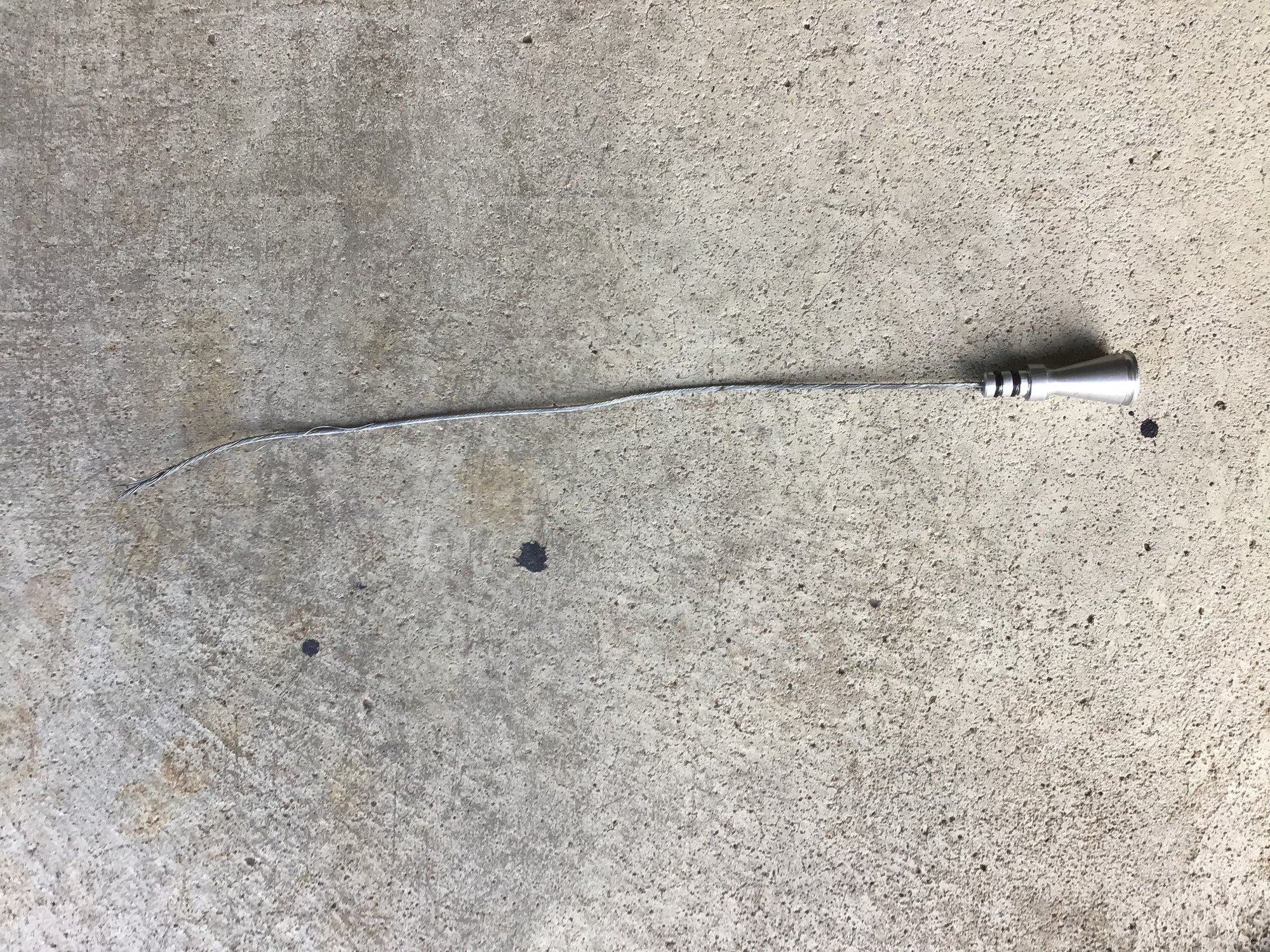

I went to check my oil this morning, pulled out my very pretty Lokar dip stick and the measuring part on the end of the cable had fallen off inside the pan. Tried to locate it with a magnet, no luck. I think it is non magnetic. Time for a cool down period.

The end of the dip stick is about 3/16 in diameter and about two inches long. It appears to be crimped on a cable which is attached to an aluminum handle. The handle end is held in place with a set screw.

You can see where the end fell off. Just wanted to give a heads up on this part. I should have checked for it possibly being loose.

Yes, the part that sell off is Aluminum so a magnet will be no help. I belive they are cast around the cable when manufactured. It may have been adjusted too long because I don't think the entire piece should extend out the edge of the tube in the pan and that is likely how it fell off. If it was completely out of the tube, it likely got caught on the edge when you were pulling it out. You can either forget about it and leave it in the pan, or pull the pan to get it, not many other options. Not sure what I would do, probably leave it and get another tube. I have a similar set up in my vista (engine and trans), not Lokar, maybe try another brand and just replace the stick part.
