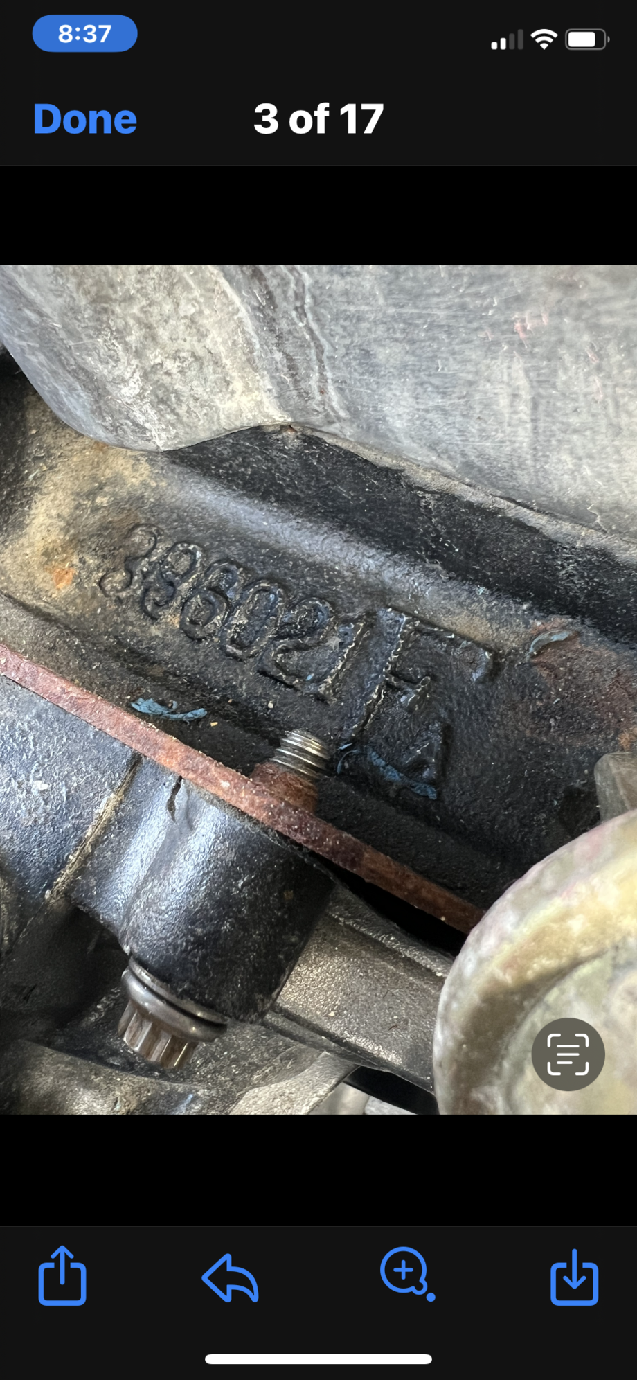

Vin stamp. 68-72 block 455
W
weird right?
its an F block but i have never seen a stamp like this?
last 6 of vin are 102351

Marine or agricultural block
but its a 68-72?

Originally Posted by JOHNNYOLDS442
but its a 68-72?
Not so sure about that. 72-76ish? Someone knows that casting.
396021 was always 68-72 i thought Fa was 73-76

The 396021 casting number as used from 1968-1976. The FA was used from 1972-76. And Olds marketed marine and industrial motors all throughout the 1960s and 70s.

What heads are on it? K perhaps?
Looks like aluminum aftermarket in the first photo.
