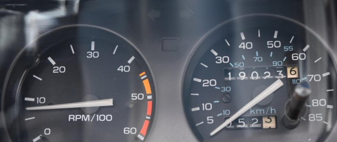

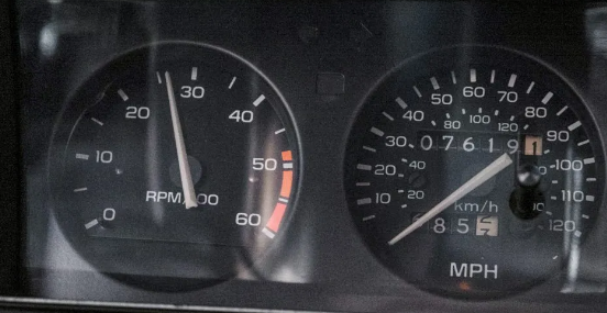

The Salon also came standard with dual outside rear sport mirrors, U21, aka Rallye Pak gages. Along with the leather-wrapped sport steering wheel and RECLINING bucket seats with console shift. 442 did not come with reclining buckets since it was a Supreme. On the pics you supplied, the standard 85 mph speedometer has been changed out with a 120mph speedo which was only available and standard on the 87 442. Lots of people think the 87 442 gage package difference was just the speedometer. Not true. Tachometers are different. The tachometer is still the same Salon tach that came with your car. Tell-tale difference is the 4400 RPM orange line and 5K RPM red line for non-442 tach. The 442 came with a 4800 RPM orange line and 5500 RPM red line tach. Only differences there on the tachs. You seem to still have your stock tach, which is fine. The rest (fuel/oil, etc., gages) are the same for all 87 G-body Cutlass with gages.
Note the tach and 85 mph speedo head on this Salon. NOT an 87 442 setup. However, it's the same setup as 85-86 442.
Slight change for 1987. Note tach and 120 mph speedo head from 442.
