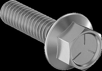

Take a look at these bolts available from McMaster Carr . . .
https://www.mcmaster.com/products/bo...x-head-screws/
Old May 24, 2025 | 10:23 AM
VERY nice find!

That’s a great find!!!!
not 100% but a pretty nice representation.
(and you’re correct on this one Joe)

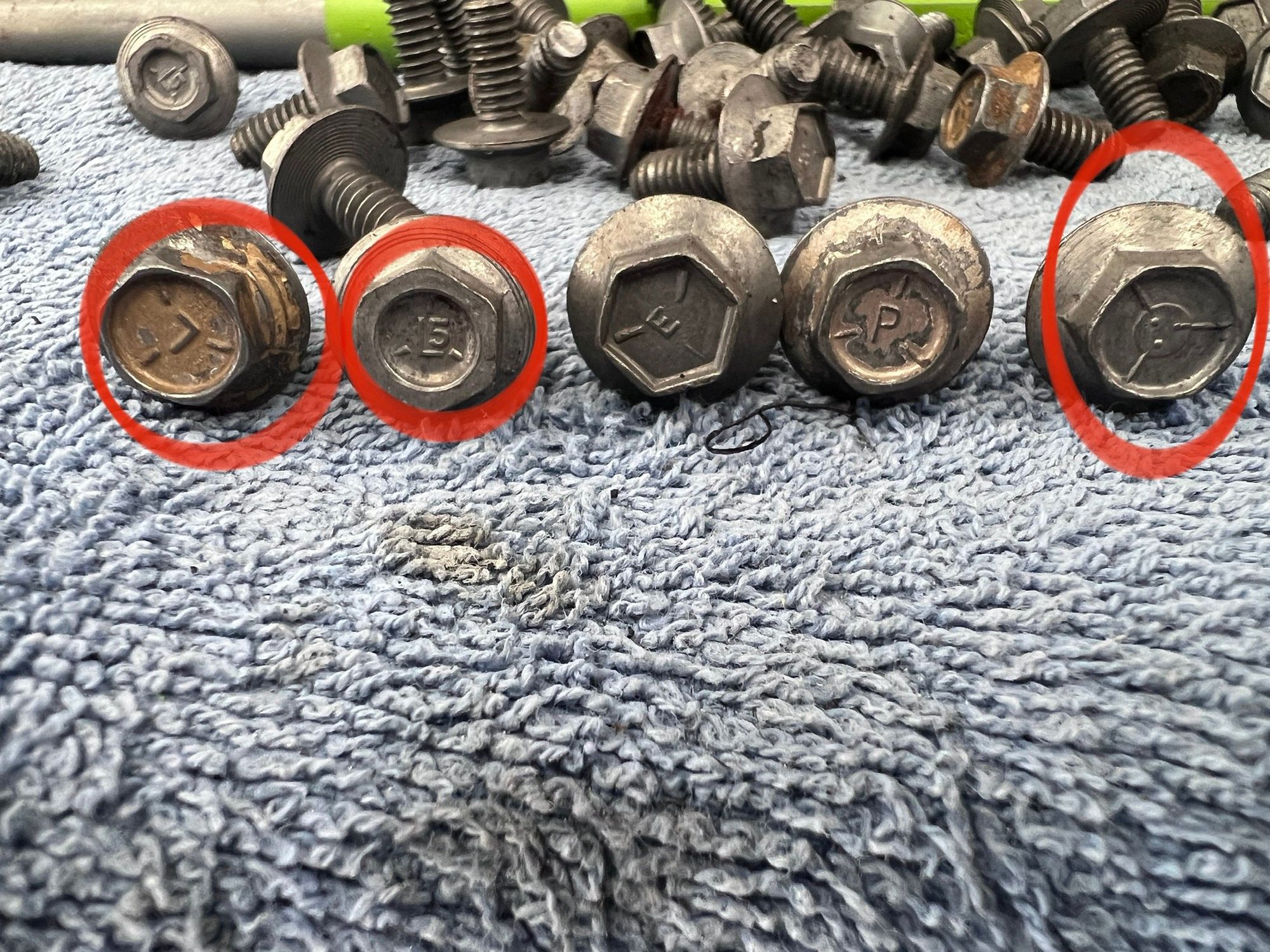

Not a great pic here but....Olds used a VARIETY of headmarkings on their valve cover bolts. Here are two Olds originals that are very close to the style and marking shown in the McMaster-Carr drawing.
>Three lines/slashes on both
>The Olds bolts I show also have 3 small dots on the headmarking....doesn't look like the McMaster bolts have any dots.
Sure, the "P", "E" and "L" headmarkings (w/the three slashes as well) may be more common but as shown in my pic, they apparently did have some w/no letter on them.

Patton, I’ve found all 5 of these on various 65’s I believe, but the 3 that are circled are known 65 bolts.

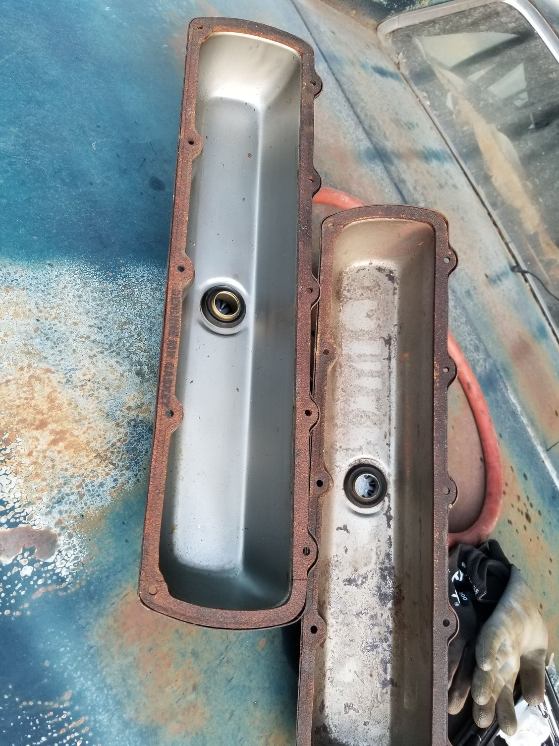

Peter, I found these early '64/'65 no baffle and no hole valve covers to use with Harland Sharp rockers. A hole saw and MOPAR grommets and baffled vent cans worked nicely for me. With your talents I'm sure you could whittle the openings to use the Olds grommets. Flange head bolts are available at most auto parts stores and Tractor Supply as well.
