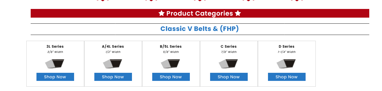

The factory parts book says those are 3/8" wide belts, which is 3L series V-belts.

The readily available non-cogged belts are 1/2", and they stick way out of the pulley. FYI.

This vendor claims to have the non-cogged 3L belts.
https://www.vbelts4less.com/

I'll rephrase- the non-cogged belts at your local napa are 1/2".
