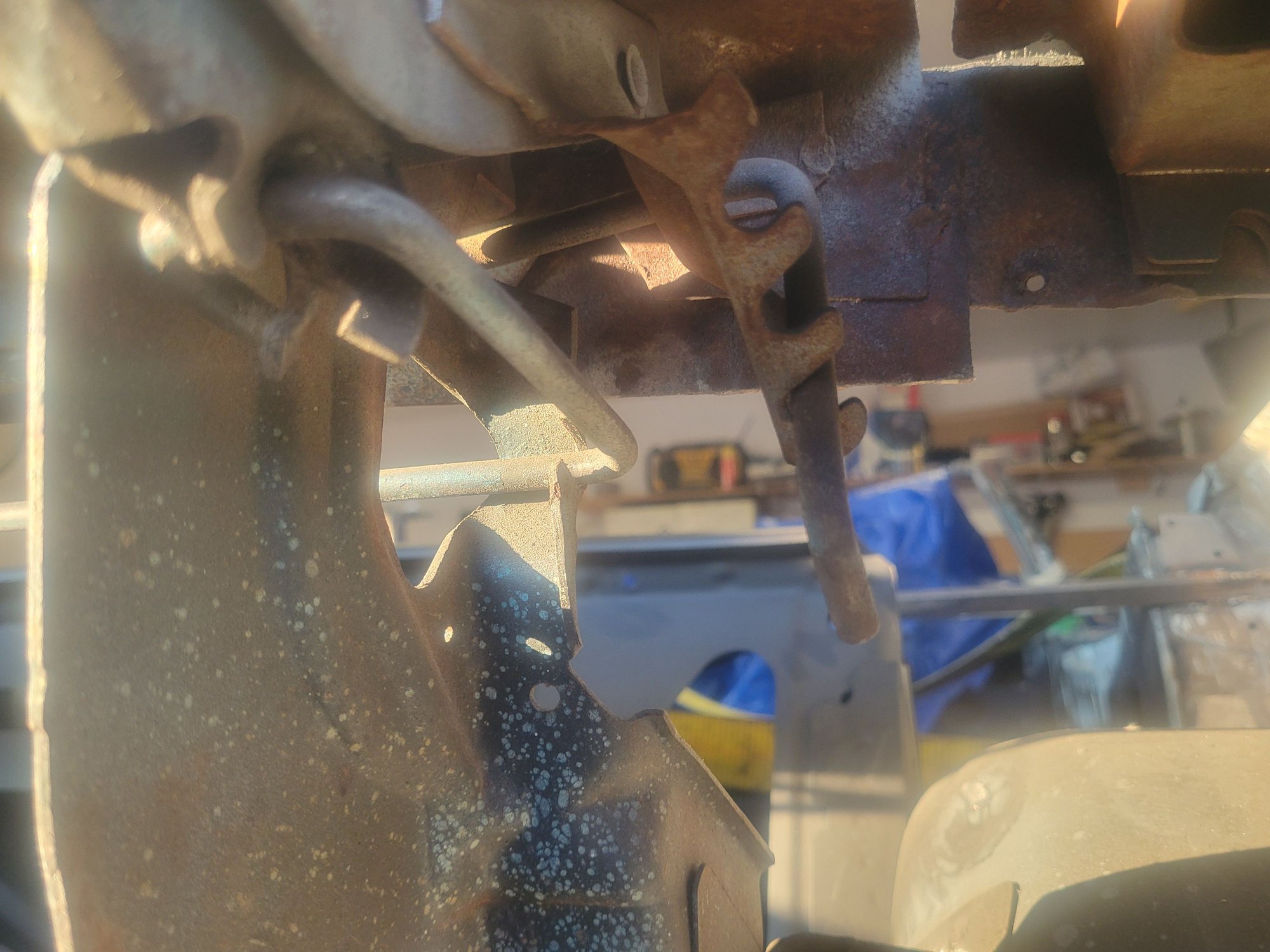

Old Jul 20, 2025 | 09:32 AM
kevdz79's Avatar
Joined: Nov 2018
Posts: 36

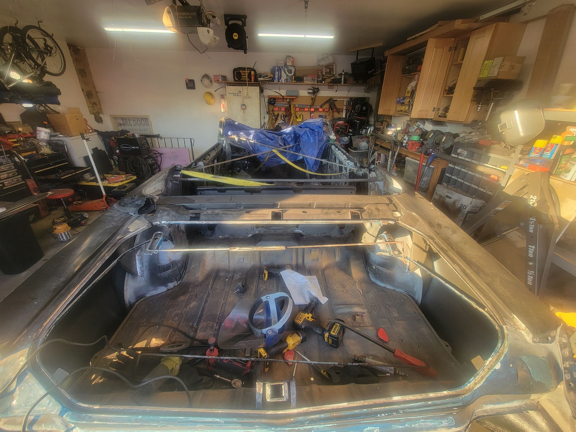

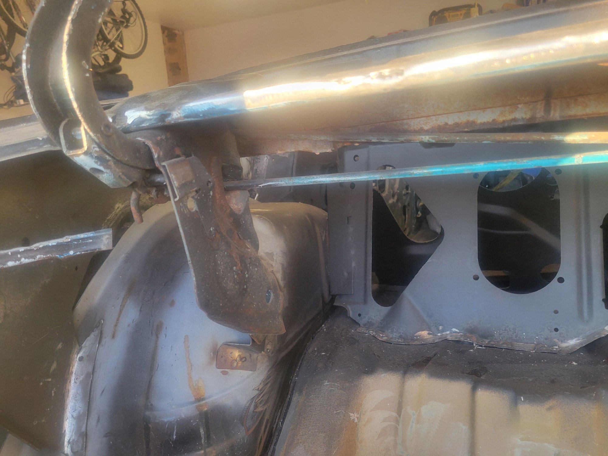

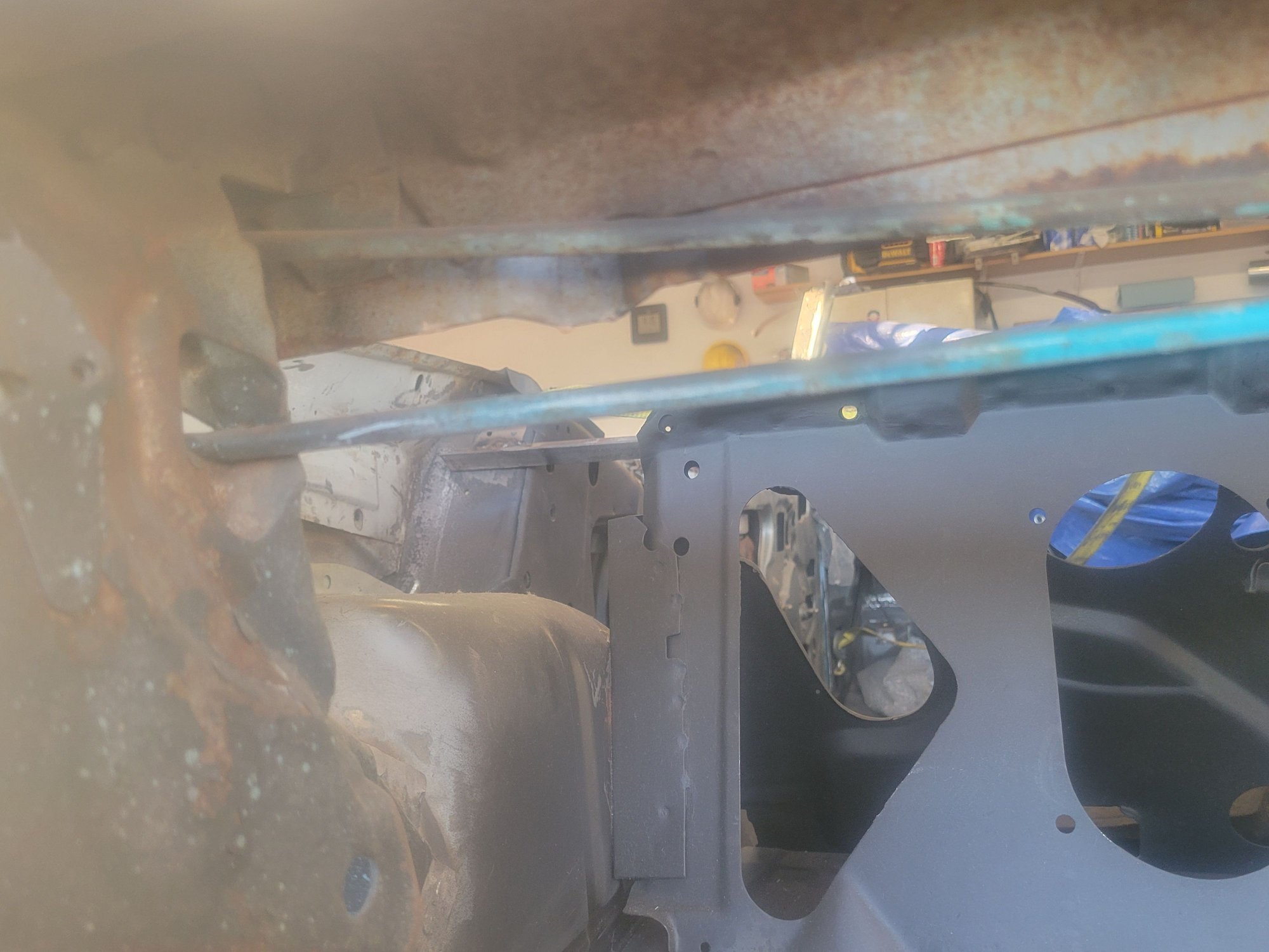

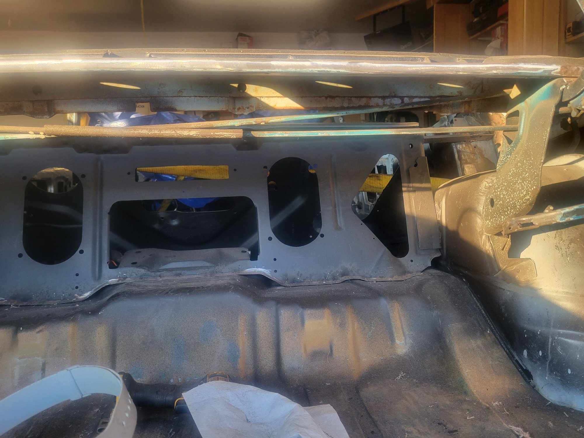

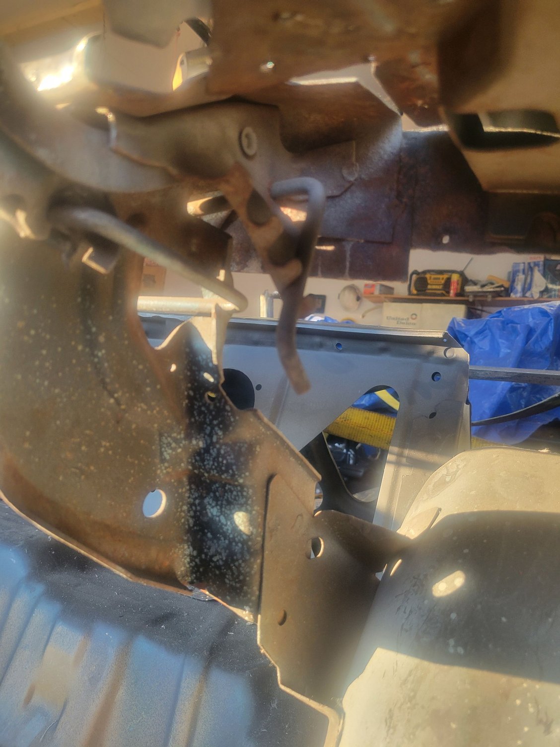

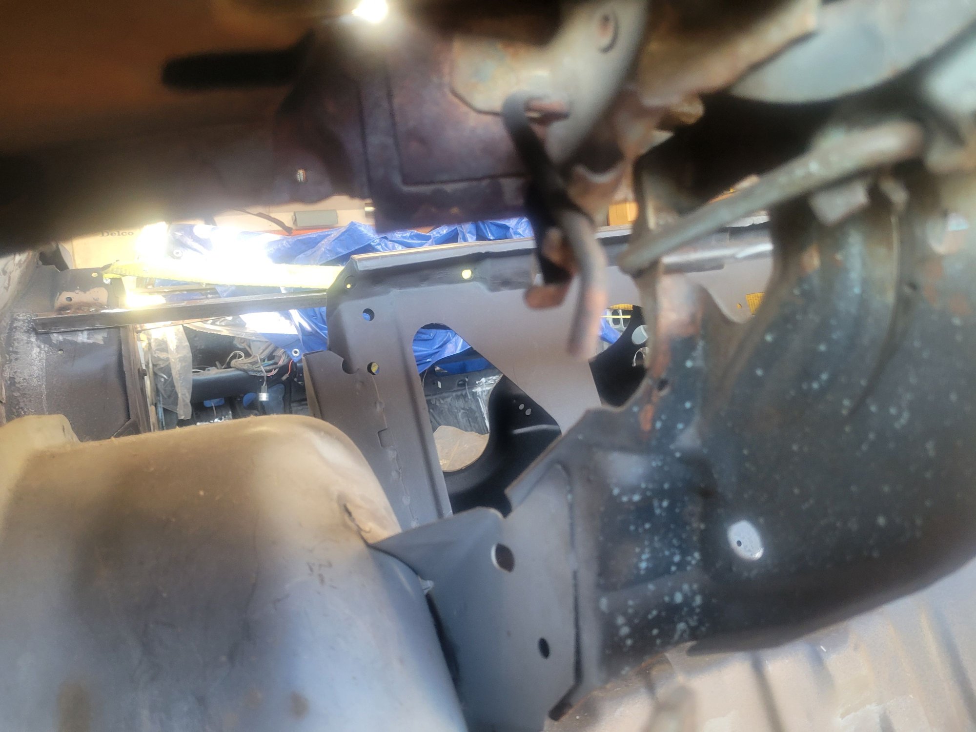

Drivers Side
Drivers Side
Drivers Side
Drivers Side
Passengers Side
Passengers Side
Passengers Side
Passengers Side
The spring is laying is the same position it was in before I removed it.
