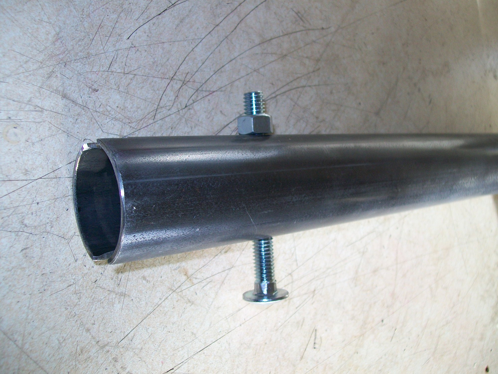

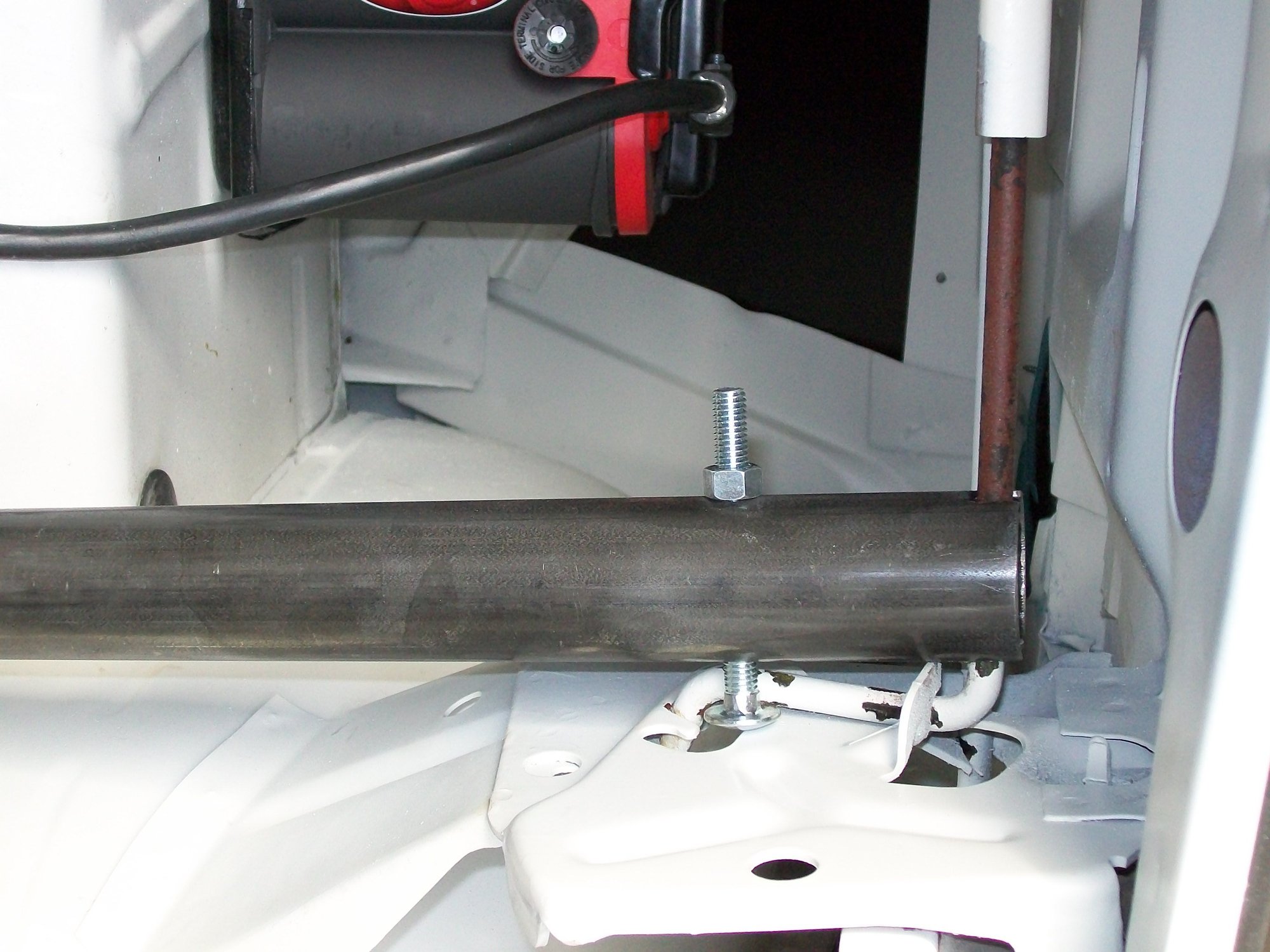

i have to re-install the trunk torsion springs in my 68 Cutlass Convertible. Would anyone know if there is a tutorial

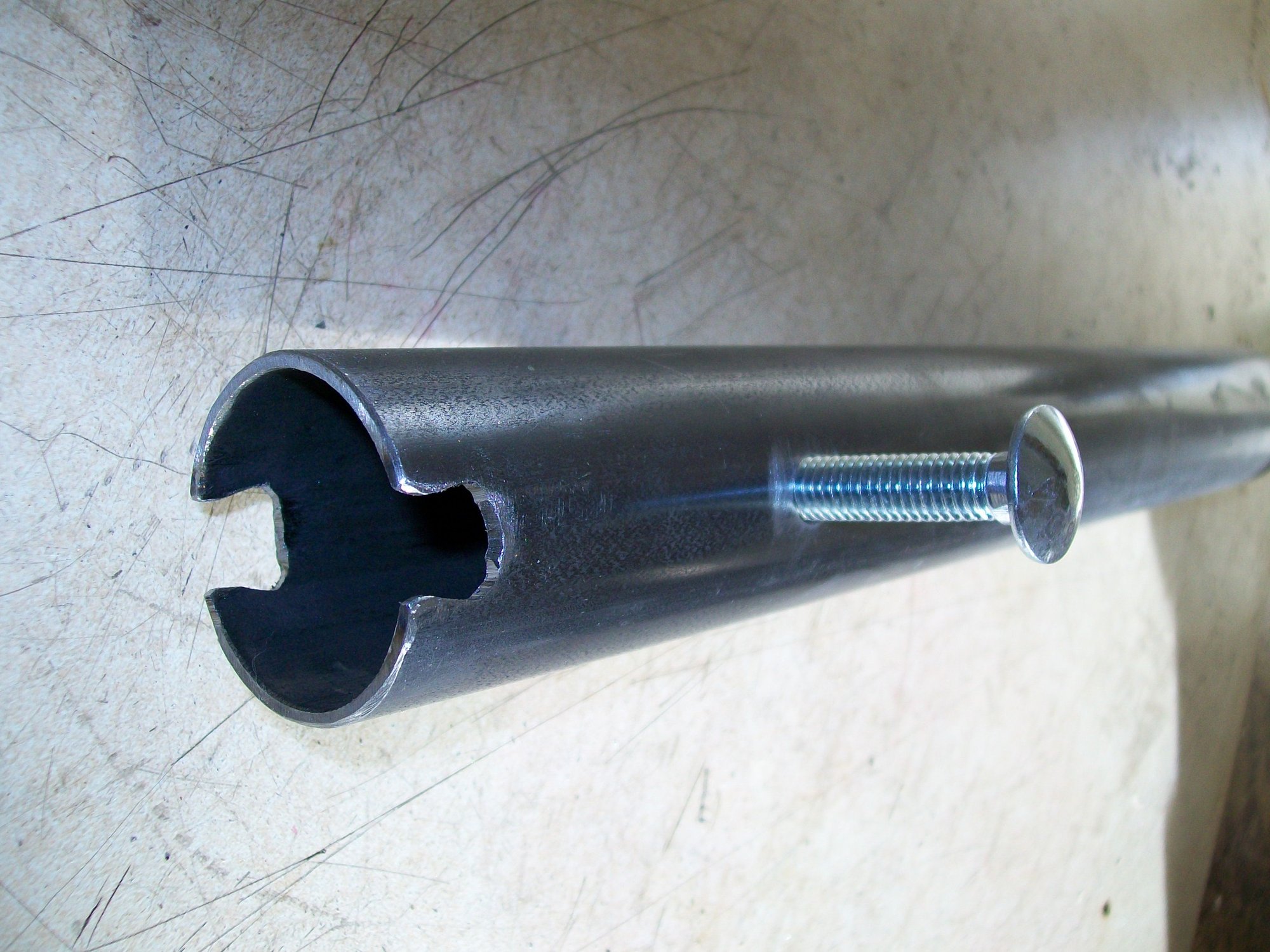

You can make the tool for easy installation from a piece of pipe and a carriage bolt.

thank you i will make one this week

I have used a long box wrench or for the real hard ones, a piece of electric conduit > worked good for me
