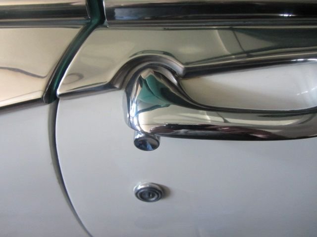

So I'm cruising YouTube and come across a clip of a concourse restored 56 Olds Super 88 drop top, as I'm wiping the drool from my keyboard i noticed something different besides the obvious , it was a drop top and mine is a two door sedan, It was the trim at the door handle !! so I started to scour the net for other videos and stills of 56 Olds Super 88's and they were all the same as I saw in the video's (at least on the hard tops and converts) now its not easy finding photos of 56 Olds Super 88 2 door sedans, I found some reg 88's but their trim is a little different as the upper trim does not extend past the rear quarter on to the door like the Super 88's do, I looked and looked and could not find one like mine, on mine the trim piece crosses over the door handle and there is a notch formed in to the door trim piece I will provide photo's of what I'm talking about now as I said It was not easy to find any photo's of Super 88 2 door sedan just a artist rendering from a 1956 Olds sales brochure and it's inconclusive although it appears it may be like mine. the hard tops 4 door sedans converts in every photo or video I can find show the the door handle not as close to the trim or no notch in the trim,
This makes no sense to me why would they make a different trim piece for one body style only (2 door sedan) when the hard tops and converts use the same., this is kind of driving me crazy (it's a short drive)
maybe a forum member who is a little bored can find out ?? here are some pics of what I'm talking about (Frank I know your super 88 is a 4 door but whats yours look like?) Photo # 1 is my actual veh.photo #2&3 are from Super 88 hard tops and photo # 4 is the artist rendering from the sales brochure it appears it may be like mine but hard to tell, I dont know that I'll be losing sleep over this but it is bugging me. there are several YouTube videos for 56 Super 88s you can see what I'm talking about.

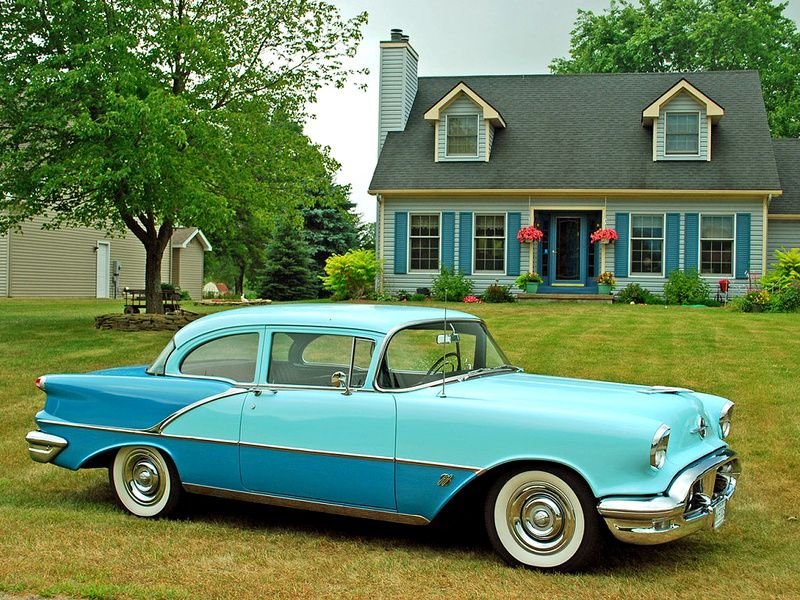

further research has me even more baffled !! as I continue to try and find answers I'm getting more confused I finally find a photo of another 56 Olds super 88 and it appears to be the same as mine with the trim butted up against the handle and then I notice the vehicle has a rocker moulding ! I have not seen this on any other photo's of any 56 olds 88's Super or non Super ?? then as I look a little closer does it not appear that on the two door sedans the door handles appear to be mounted higher on the door closer to the belt line ? maybe this covid staying at home thing is getting to me !! I just think it crazy to change these tings for 1 body style especially one that they produced only 5,645 of . photo #1 super 88 hard top,#2 Super 88 2 door sedan, #3 my door and handle trim,

Solly, here's my '56 Super 88 four door sedan door handle:
I can't find any other models that have the door handle integrated into the trim. Must be unique to the Super 88 two door sedan. Very interesting.

Two door doors are longer than four door front doors .
The handle sets farther back on the body , hence the notch in the trim .
Holiday hardtops used different trim in this area than post sedans .

WOW, thanks Charlie, a moulding chart, now that's research !! I noticed that in the illustration of the sedan it clearly shows the the handle below the trim just like the hard tops however the trim pieces clearly have different part numbers for the sedans than they do the hard tops as seen in the charts.
I know the door dimensions are different for 2 door vs 4 doors, I still think it odd that trim piece would be different 2 door hard top vs 2 door sedan vs convert.
just one of those things I guess, I know one thing I guess I will take special care to protect those pieces because the chances of finding replacements should anything ever happen to them is slim to none.

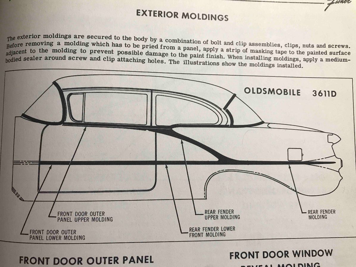

This is page 25 of the Body by Fisher 1956 Oldsmobile Body Information News. Although it's an illustration, it clearly shows the "notch" in the upper molding of model 3611D, otherwise known as the Super 88 two door sedan. The other illustrations in this publication do not show a "notch"
Well there you have it a trim combination unique to one model /body style only !!! thanks to all of you ! better research than I could have done !!

So found this picture posted some time ago by fellow member Oldsmoboggie, cleary handle and trim with notch, kinda closes the book on this, however I'm now noticing there appears to be no rhyme or reason to where Oldsmobile decided to mount Radio antennas, mine is on the pass side, I've seen them mounted on both sides.
