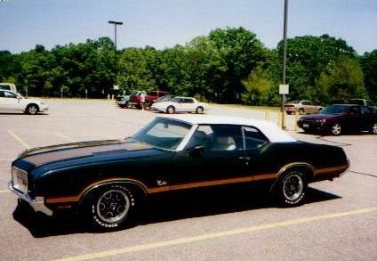

Yes, I should've mentioned, I lowered it with 2" drop spindles and 2" drop springs. 10 years ago, I found Good year Wingfoot hp tire for my green car that was stolen, but I can no longer find this tire. It is no longer available. I just love the stance and I wanted to duplicate it. I also looked for my receipts on the tires and can't locate it.
Here are the tires from my 71 Cutlass that was stolen. It was lowered with 2" springs and drop spindles
