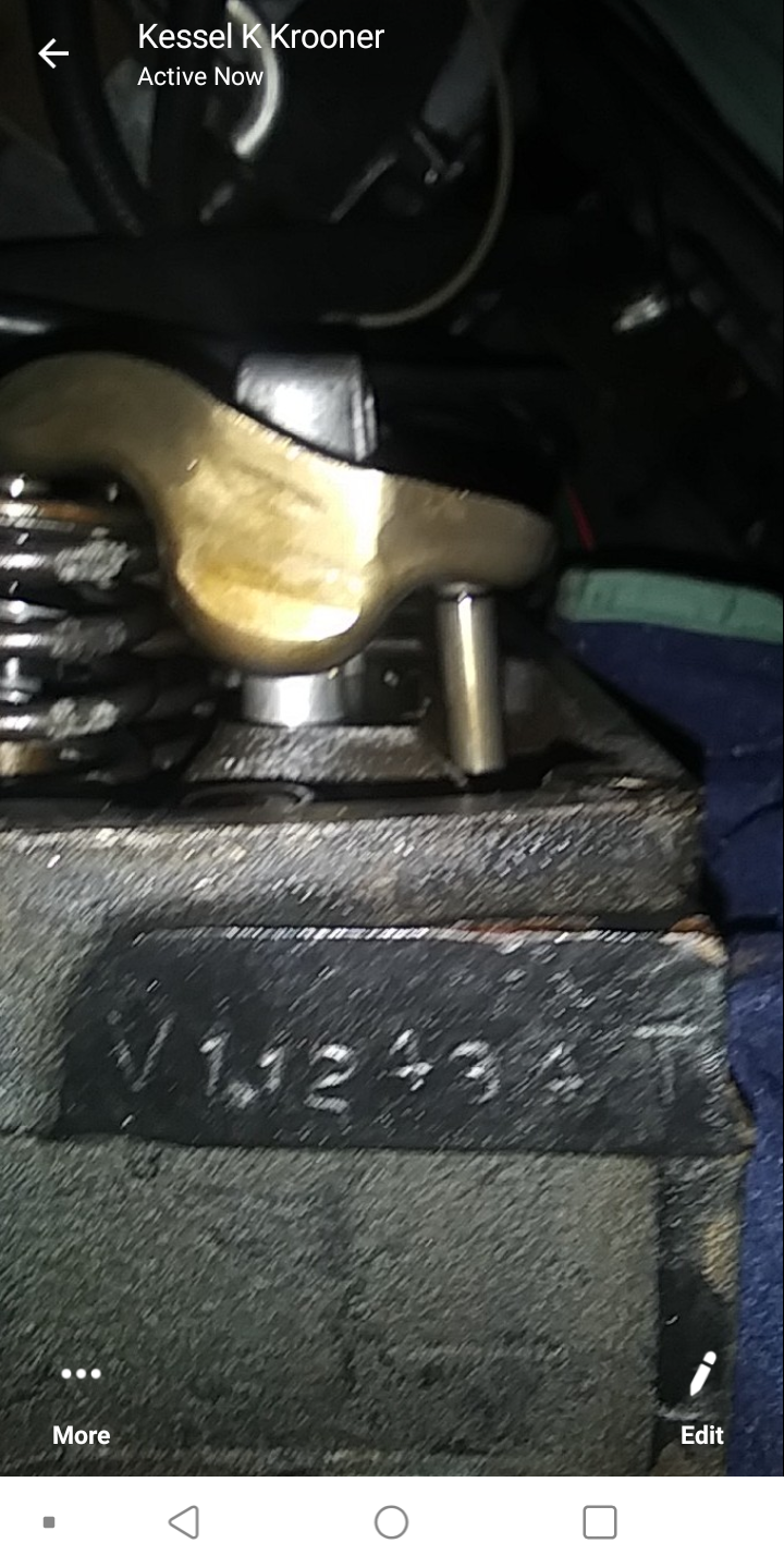

Are these w30 heads I have
Jul 12, 2020 | 07:19 PM
Oldsvette
Jul 2020
Was told i have a special find on my 455
Oldsvette
Find More Posts by Oldsvette
Jul 12, 2020 | 07:22 PM
66-3X2 442
Jul 2009
5,193
Birmingham,Alabama
66 442 L69 tri carb head. Not a W-30 unless it's on a W-30.
66-3X2 442
Find More Posts by 66-3X2 442
Jul 12, 2020 | 09:18 PM
1969w3155
Aug 2009
9,483
Muskegon, Mi.
Not the correct heads for a 455. What year is your car?
1969w3155
Find More Posts by 1969w3155
Jul 12, 2020 | 09:25 PM
hurst68olds
Dec 2010
1,580
Las Vegas, NV
Quote:
Originally Posted by
66-3X2 442
wouldn't that sequence number be too early for a '66 W30?
hurst68olds
Find More Posts by hurst68olds
Jul 12, 2020 | 09:32 PM
Koda
Aug 2013
12,810
Evansville, IN
Let's see if they are the correct casting letter first.
Koda
Find More Posts by Koda
Jul 13, 2020 | 08:03 AM
66-3X2 442
Jul 2009
5,193
Birmingham,Alabama
hurst68olds
Yes,I wasn't saying it could be a W-30 head but with it being a T stamping,the only way for it to be a W head would to be on a W car. Make sense?
66-3X2 442
