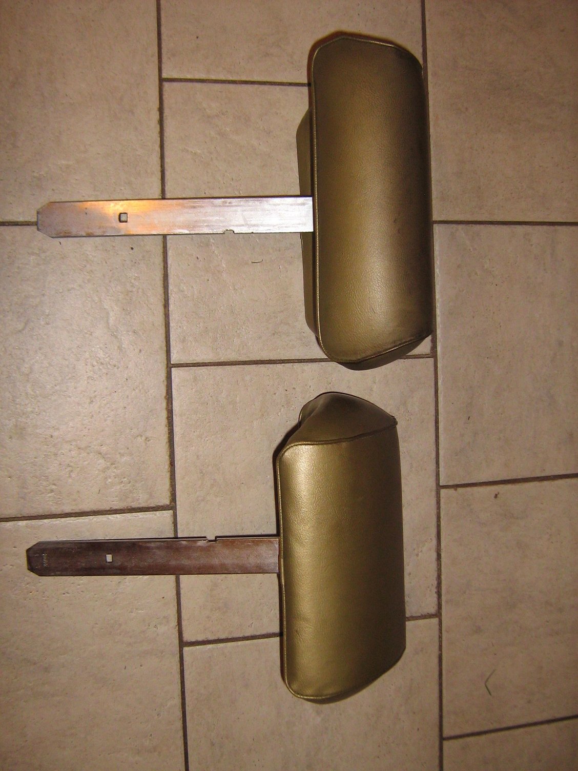

Are these bench or bucket seat headrest
From a '70 Cutlass parts car, were on a black bench seat.

1 flat bar is bench
2 round bar is bucket..i cant see your pics

To clarify a little, A, B, and E-body bucket seat headrests use the two round bars.
First gen F-body bucket seat headrests use a flat bar.

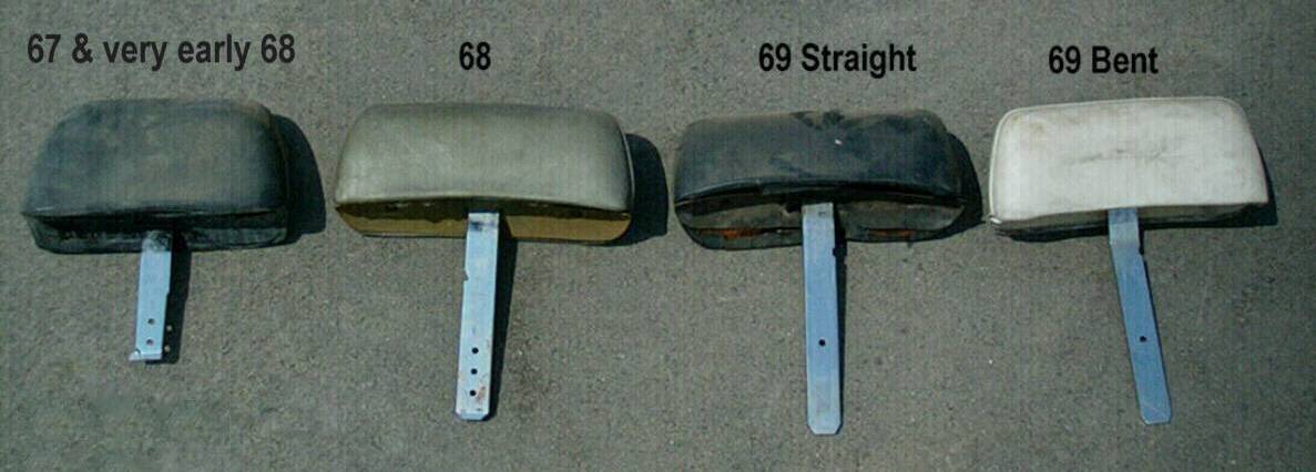

Bench seat headrests look like this

Awesome, thanks.
