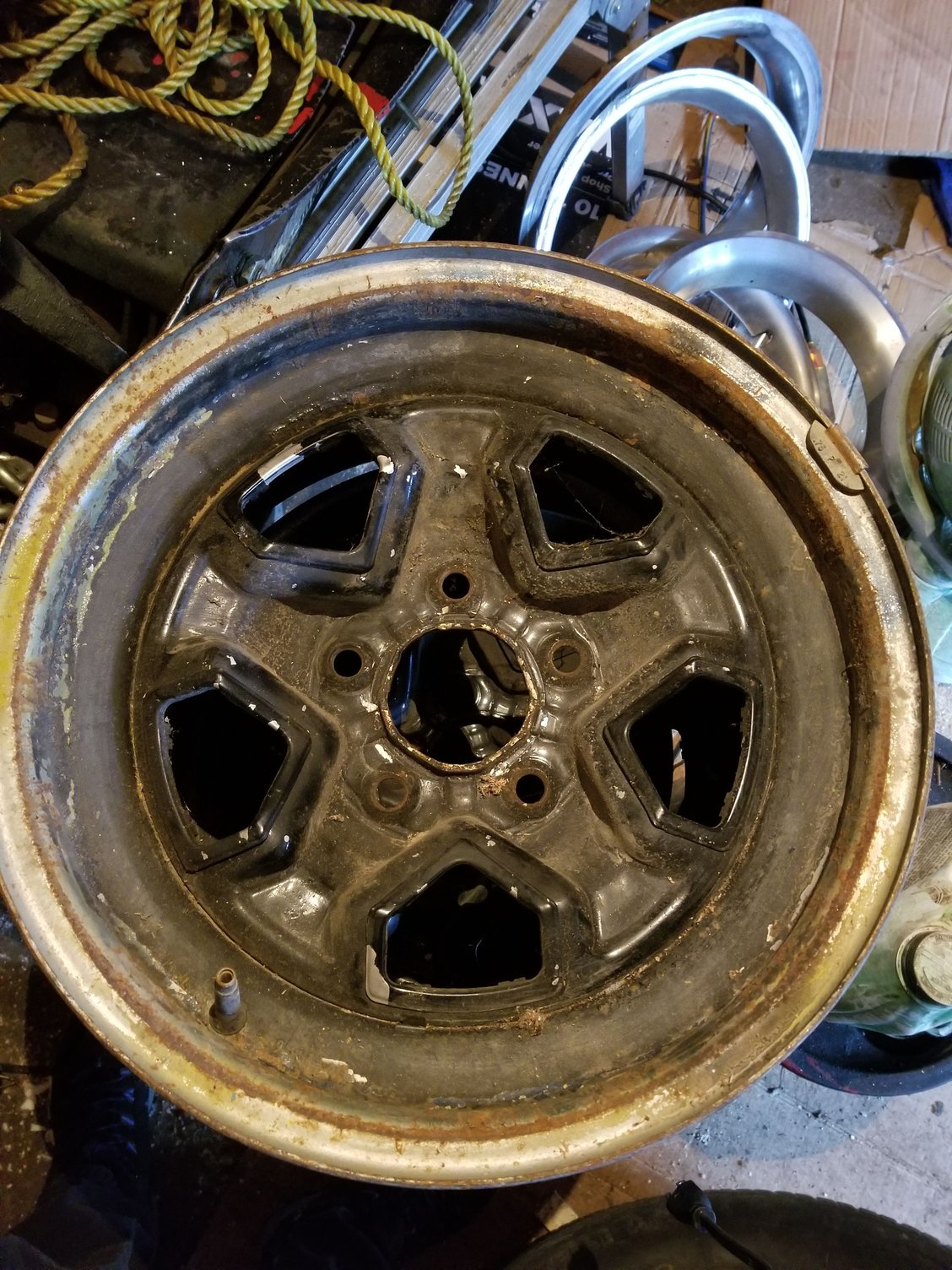

No caps. These are a factory rim, I will do pics today.
Old Dec 27, 2018 | 11:56 AM
olds 307 and 403's Avatar
Out of Line, Everytime😉
Posts: 10,109
From: Melville, Saskatchewan
Here they are.

442Harv's Avatar
Posts: 1,735
From: Tracy Ca
I thought you were talking about the Olds SS1 type wheels. The Olds SS1 caps will not fit that wheel

droldsmorland's Avatar
CH3NO2 LEARN IT BURN IT
Posts: 5,638
From: Land of Taxes
Thats a late 70s early 80s Chevy wheel. The center slips over the lug nuts. SS1-3s will not work.

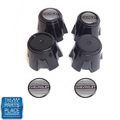

I found the 2.68" measurement for the SS1 bolt in center cap. I also see how the SS2/3 bolt on caps work. I may be able make some sort of Olds cap work.
Old Dec 27, 2018 | 09:37 PM
Posts: 10,109
These look like these center caps would fit. I would paint chrome and add Olds center decal.
