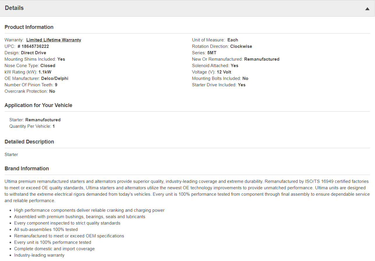

I’m seeking any and all knowledgeable opinions regarding the starter motor installation. As to what I have read, one must adjust the depth of engagement between the pinion and flywheel. The gap has to be set between the starter gear and flywheel gear. flywheel. I believe anywhere between .020" and .060". From the information I obtained.

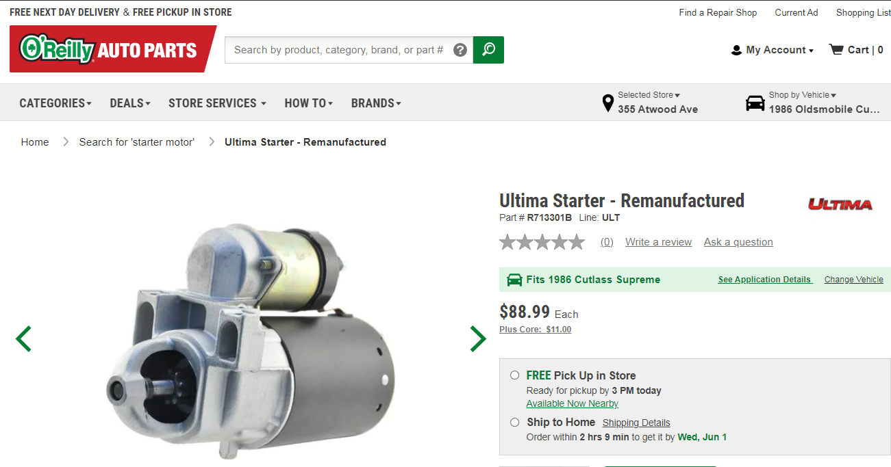

After 35 years, my starter motor (Original AC-Delco) failed. I have been using a local mechanic for a few years and I allowed him to perform the work. The labor rate was really cheap and the starter motor was as well. After receiving the vehicle back, the starter was malfunctioning. Instead of him ordering the starter, I purchased a remanufactured off Amazon (AC-Delco). He placed that starter in but failed to bolt on the heat shield, leaving a slight metal sound. I returned back for him to install correctly. I asked him if there were any problems installing the heat shield. The mechanic (no longer a friend) said, “Sometimes they fit, sometimes they don’t”. The starter motor was specked out as O.E.M. That starter failed within a year. Needless to say, I will no longer be returning there.
On the third attempt, I used a different mechanic who installed an Optima starter motor (Limited Lifetime Warranty). The work was done properly for as soon as I hit the key to start the ignition, I could immediately tell the starter was installed correctly. He told me that the the depth has to be adjusted, etc. as mentioned in the first paragraph. He further said no shims were required.
1.) Any and all input relating to the above is appreciated.
2.) What is the actual setting of the gears?
3.) Would a starter motor fail if not installed correctly.
* I also noticed that there was a minor oil leak appearing to be coming from the rear main seal. In briefly reading some technical information, the content stated if the starter is not installed correctly, there could be oil dripping from the rear main. Is this true? However, after a week of the starter motor being installed, there is no oil leak or leaks on the garage floor. Have not been under the car yet, but will eventually. All replies are welcome.

Some pictures of the starter motor installed.
By the way, I could not purchase for the price of $89.00 and give to him or he would not do the work. He charged me $160.00 for the starter motor and with labor $307.00. Quite a bit but the work was done right. Your thoughts on this. The first mechanic charged $89.00 for labor and allowed me to get the part after his first starter motor failed. So, double the price but well worth all the aggravation. In addition, I had to have the car towed on a flat bed.
Optima Starter Motor
Optima Starter Motor Specifications/Details

Actually, professional shops won't typically install parts that they don't supply because if there's a problem after the repair, it always turns into a pizzing contest over who's at fault. The shop says it's the customer-supplied parts, the customer says it's the shop. I can't say that I blame them. I've done too many side jobs in my young and stupid days where I fixed the brakes (for example) and two weeks later the customer complains that the muffler fell off.
Hello Mr. Joe. The part (Starter Motor) I would be providing to him was the same one he installed (As pictured) and purchased at the same place (O'Reilly). I have no qualms for the work was done right. Why can't people at least be honest?

The only way to measure starter pinion to flexplate clearance, which should be EXACTLY 030"- no ore, no less, is with the transmission removed. If you didn't pay for transmission removal and reinstall action, it was most definitely done incorrectly or not at all. They lied; sue the bastids!!!!!!!

Your car used a 5 MT starter. That design was probably the worst design Delco ever made. I have serious doubts it was original after 35 years.
Spected out by who?
Installing a starter would have nothing to do with a rear main oil leak.
The starter housing came in an American size and a metric size. The mounting holes were either 3/8 inch or 10 MM. The bolt size was also different to match the housings. This alone could explain the metalic sound. Not having a heat shield would not cause a metalic sound.
The 5MT starter also had various field case lengths. This is probably why the mechanic said sometimes they fit and sometimes they don't. See post 3
