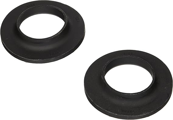

The springs are held in place by the weight of the car and the shock absorbers maintain pressure. The isolators can be had anywhere, below is what I bought for mine, Moog K6203-2 Coil Spring Insulator. Have not installed them yet.

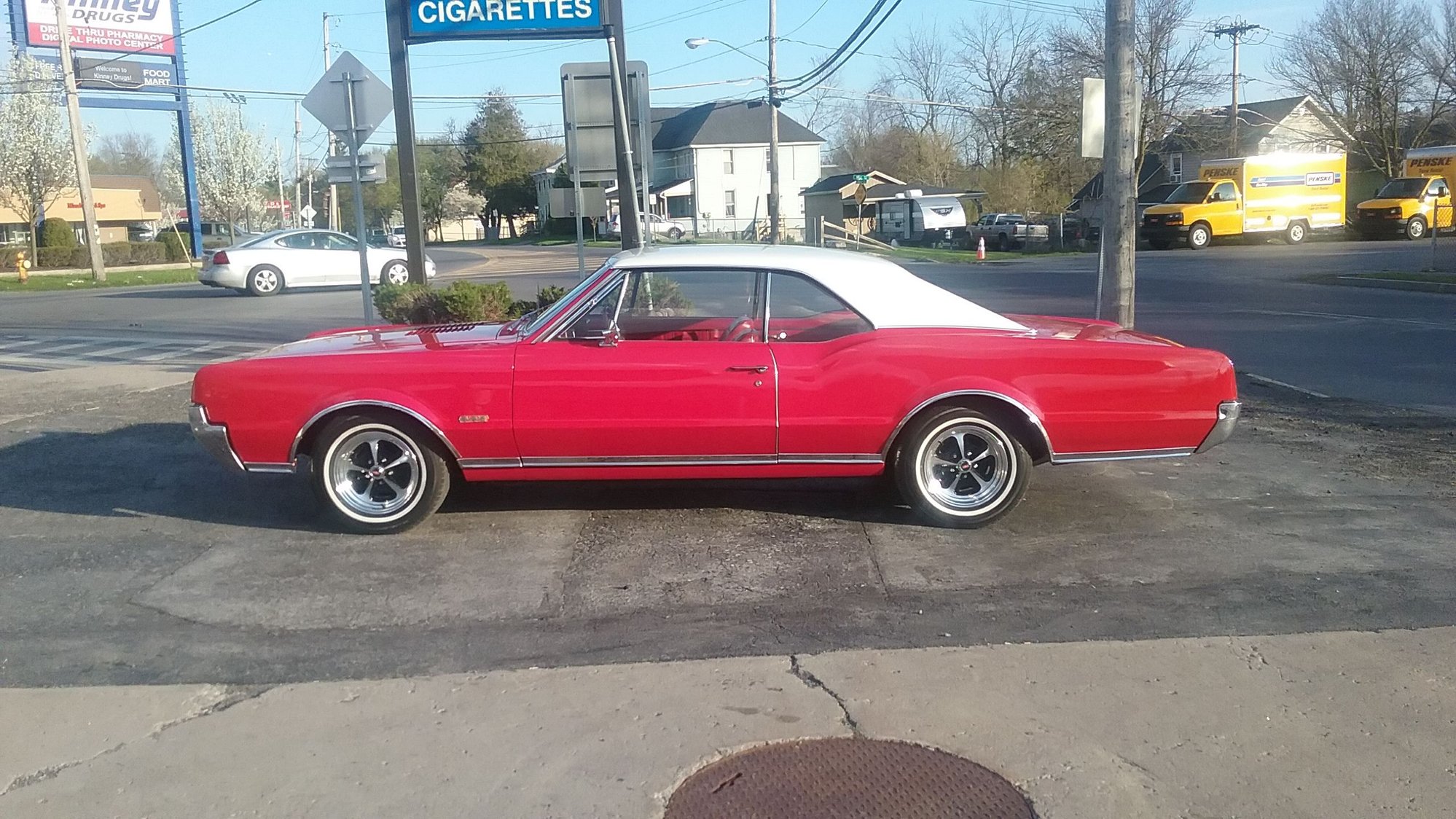

this how it sits now
Old May 7, 2020 | 05:36 AM
Posts: 5,568
That is a beautiful car. I've never seen springs just fall out when shocks were still connected. My guess is they are the wrong springs.
Old May 7, 2020 | 05:39 AM
442gs's Avatar
Joined: Oct 2013
Posts: 104
From: upstate ny
thanks, is the back end a littler higher than stock ?
Old May 7, 2020 | 05:52 AM
With the car sitting like that, those springs should not be loose with the right length shocks. The rear is higher than stock, would look nice with wider tires.

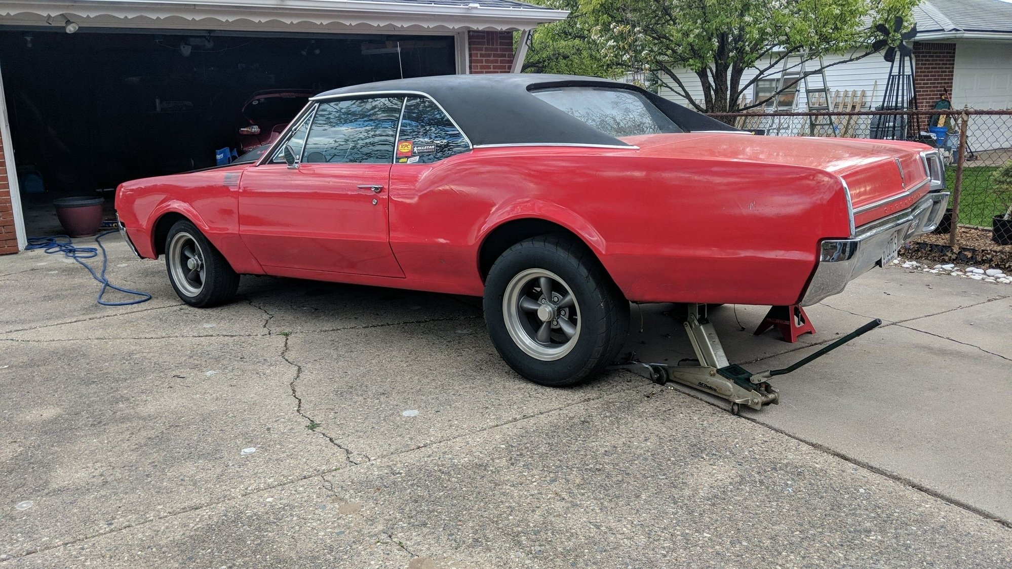

This is what my 67 looks like with the air shocks lifting the rear (ignore the jack, I was getting ready to take off the shocks). Unfortunately the car sits lopsided without any shocks so I think one of the springs is weak.
