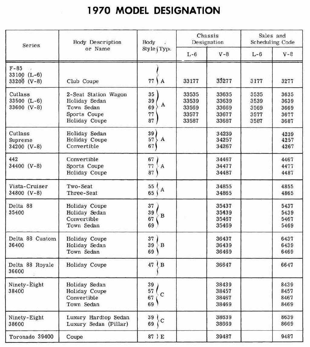

Depends on the model. All Oldsmobiles start with 3 because that means Oldsmobile.
Below is the model designation chart from the 1970 chassis service manual.
F-85s start with 331 or 332, depending on the engine.
Cutlasses start with 335 or 336
Supremes start with 342
Etc.
