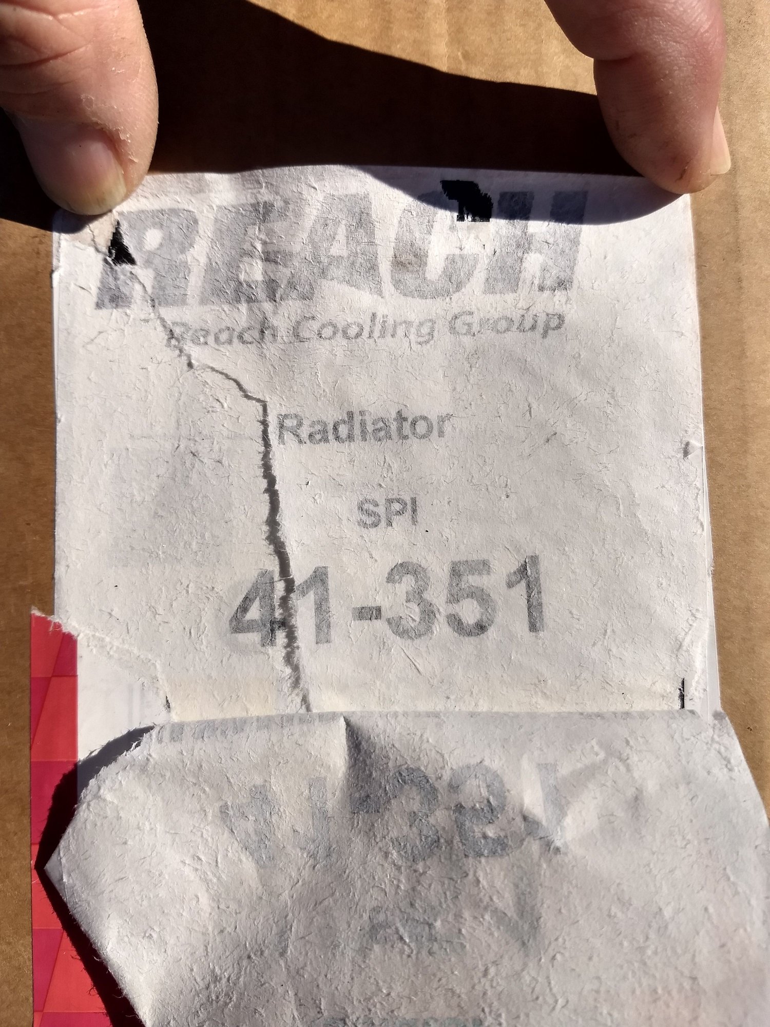

Before I post some pics, here's a little back story. I had two radiators with the same part number on hand just in case. One came from Auto Zone (that's the one I installed), and the other I ordered from Amazon... again, same part number CU351).
Now, here's where it gets interesting. The one from Auto Zone had exactly the "look" I was after (pay particular attention to the filler neck) (The other two labels are what was under the Duralast label).

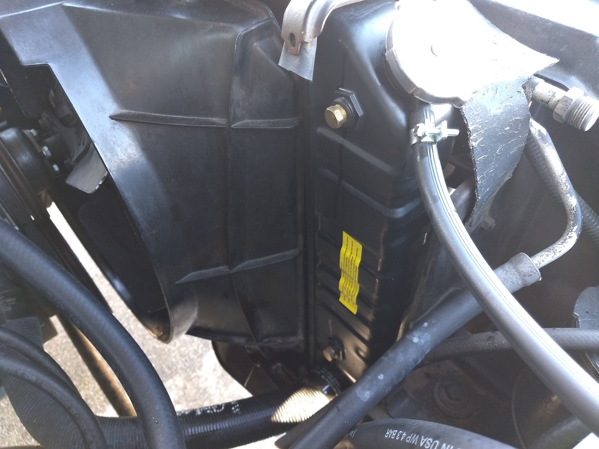

Ok, enough rambling, here are some pics after installation. And thanks to everyone who advised me during this project 😀

Could you enlighten me on that plastic hose clamp? I've never that.

Yup... that's a Gates Power Grip. Thermoplastic...the hotter they get, the tighter. I first used them when I put new hoses on a while back, and I couldn't be happier with them. Nice clean look. Only drawback is you have to cut them to get them off, but it's worth it to me.

So the 72 filler necks are at a 45º angle? The original on my 71 is straight up like your second picture.

Looks nice enough. How's it work?

Thanks, may try that on something.

Works like a champ...195-200... about the same as before.

You may be right, but I like the "cleaner" look of the angled neck😀

Nice! Ironic: the same part number for different units, both from the same "manufacturer." I guess the PN goes for the application, and not for the unit.

Indeed when it comes time to remove those gates power grip hose clamps, it can become a mess. Some have cut into the hose to get them loose. I bought some hook shaped blades that fit into a regular box cutter. They can get in between the clamp and the hose without cutting the hose. Have it handy, on a cruise like Power Tour for example I used to keep one in the small tool box in the trunk..The link below is what I have. The other downside is you will need a heat gun or at least your wife's hair dryer to shrink the clamp. That could be an issue on a cruise if you need to replace a hose, water pump etc.
