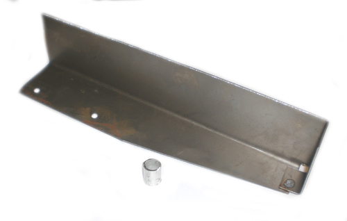

Sorry to hijack your thread Mugzilla,but I have some questions regarding the coolant overflow tank mounting.
I just recieved one of the reproduction coolant overflow tank kits,looks like it will fit pretty well but,
the mounting bracket is raw,were these brackets mounted raw? or painted from the factory?
What type of fasteners should be used for mounting? It did not include any. I can't stand to look at an engine bay with mis matched or improper fasteners being used.

One that was NOS I had considered buying showed the bracket painted satin black. The hoses were black with yellow and purple indexing. .

Here's some pics of the reproduction tank I picked up,the add/full lines are on one side of the tank as shown.Just need to gather some fasteners and paint for the bracket,then I'll be installing it.

Shows a painted bracket
By the look of the pics, they appear to be either 3/8 or 7/16 self tapping metal screws. Easy to get almost anywhere. There's usually a nut and bolt supply store in most large cities. Check out the phone book or web in your area. Heck, check out a local bodyshop and ask them where they source out parts. The probably easiest and best thing would be go to the wrecker. Find a host car and start stripping bolts off it. Then restore them. I think Eastwoods has a kit for doing the phosphate restoration.
Thanks much for the great pics.
Same bottle but your brackets are different than the reproduction kit.
Your pics confirmed what type of bolts it looks like the factory used.I haven't had any luck finding any yet.The search continues.

Here's a pic borrowed from the parts place of what the repro looks like

The brackets are probably just the basic semi-gloss black like all the brackets are. They may have dip finished them originally, lots of runs with mottled skinning and fisheyes.
Eastwood underhood black is just right, any good quality semi-gloss works but the Eastwood stuff is nice.
