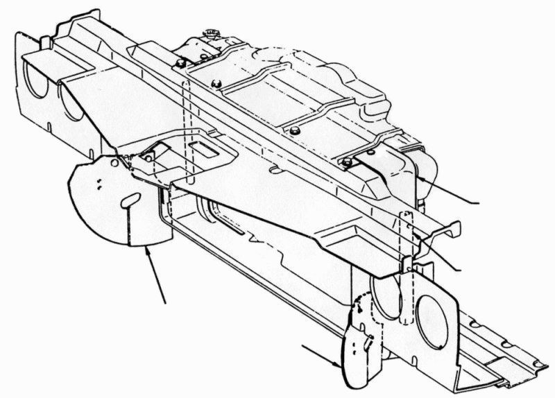

Does anyone have a pic of these installed they are missing on my car and ordered the parts but not sure exactly where they go

Here is fairly good photo.

That's a great pic of the splash shields any pic of radiator seals ?

Your looking at them. See the rubber forward of the radiator cap and the same on the opposite side. All are available from your favorite resto house. If your describing the rubber that seals the radiator to the core at the front face of the radiator those are available as well (not shown here).

Here are the locations of the typical 'seals':
Fusick's image of seals locations
The leaders point to the (vertical) radiator side cushions, 'shroud seals' (at upper corners), and 'splash' or 'lower' seals (at lower edge of radiator).
