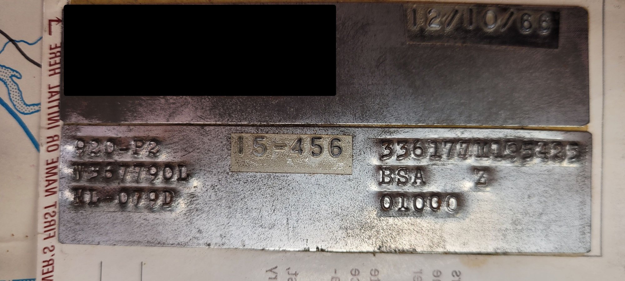

I am looking for help to understand all the data on the Protect O Plate from my 67 Cutlass Holiday Coupe. Last night and today I tried "Googling" this info to see if I could find anything and I have had no luck. In fact, I stumbled across this Forum when I was searching. I got some the "easy" stuff out of the way like it's a '67 Cutlass Holiday Coupe, made on the 5th week of November in Lansing MI.

The plate has, on the top row, Trim Color, Paint Color, VIN
Second row, Engine serial number on the left
Third row, transmission number
From the VIN, and the other stuff, you have a Pewter (P) Cutlass Hardtop (3617) with a black roof (2) and black bench (920). You have a 330 low compression engine. (W######L). ML means 2 barrel V8 setup Jetaway transmission.

Get a copy of the 1967 Cutlass 442 Assembly manual. Go to the first Section 0, Page 1.01 and it will show you the Protect O Plate codes. The 01000 shows it has power steering. The BSA means it is a Buick differential with a 2.78 ratio open. The ML means it is a Jetawy transmission followed by the date code. The 920 P2 is the trim code.
