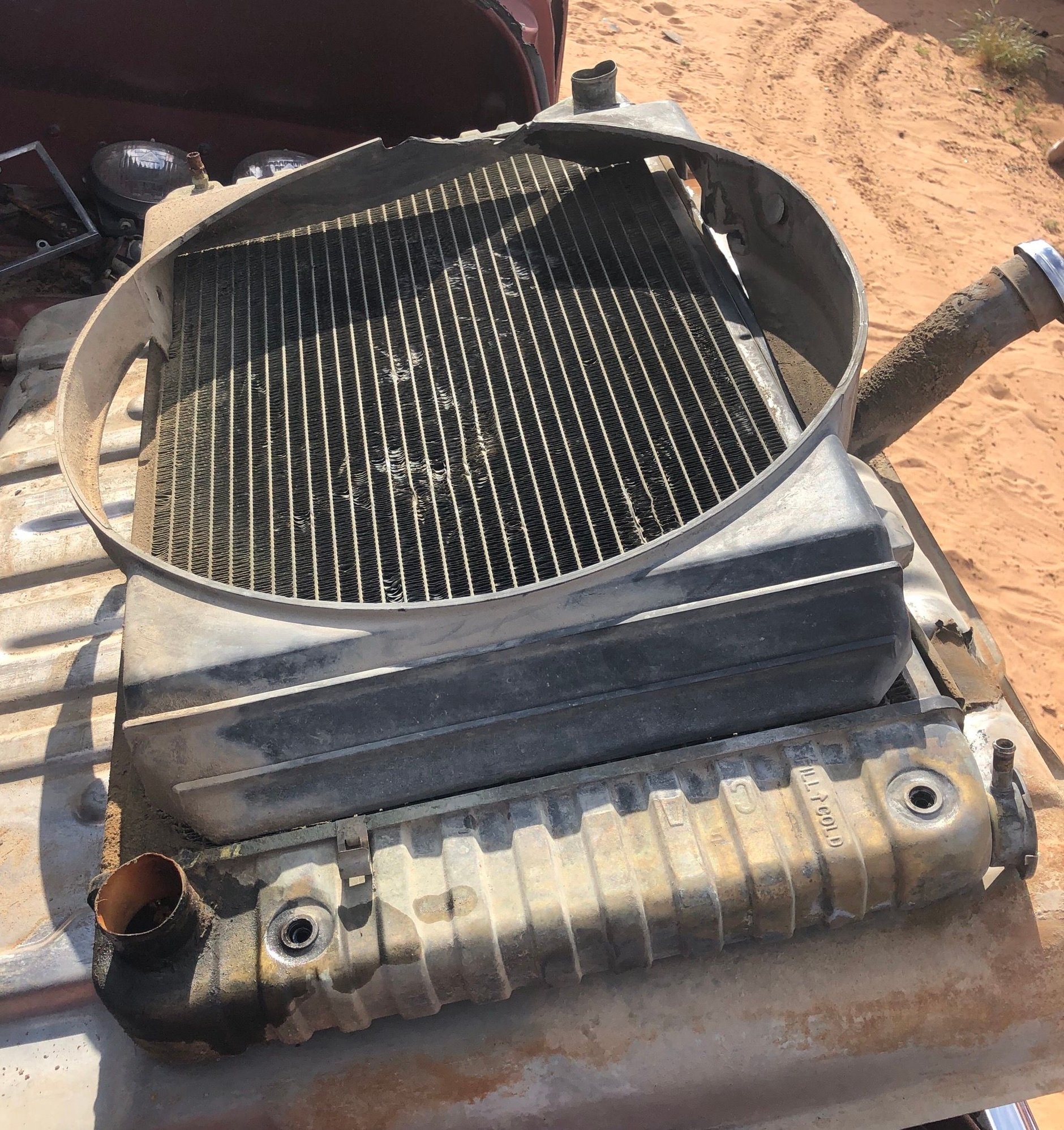

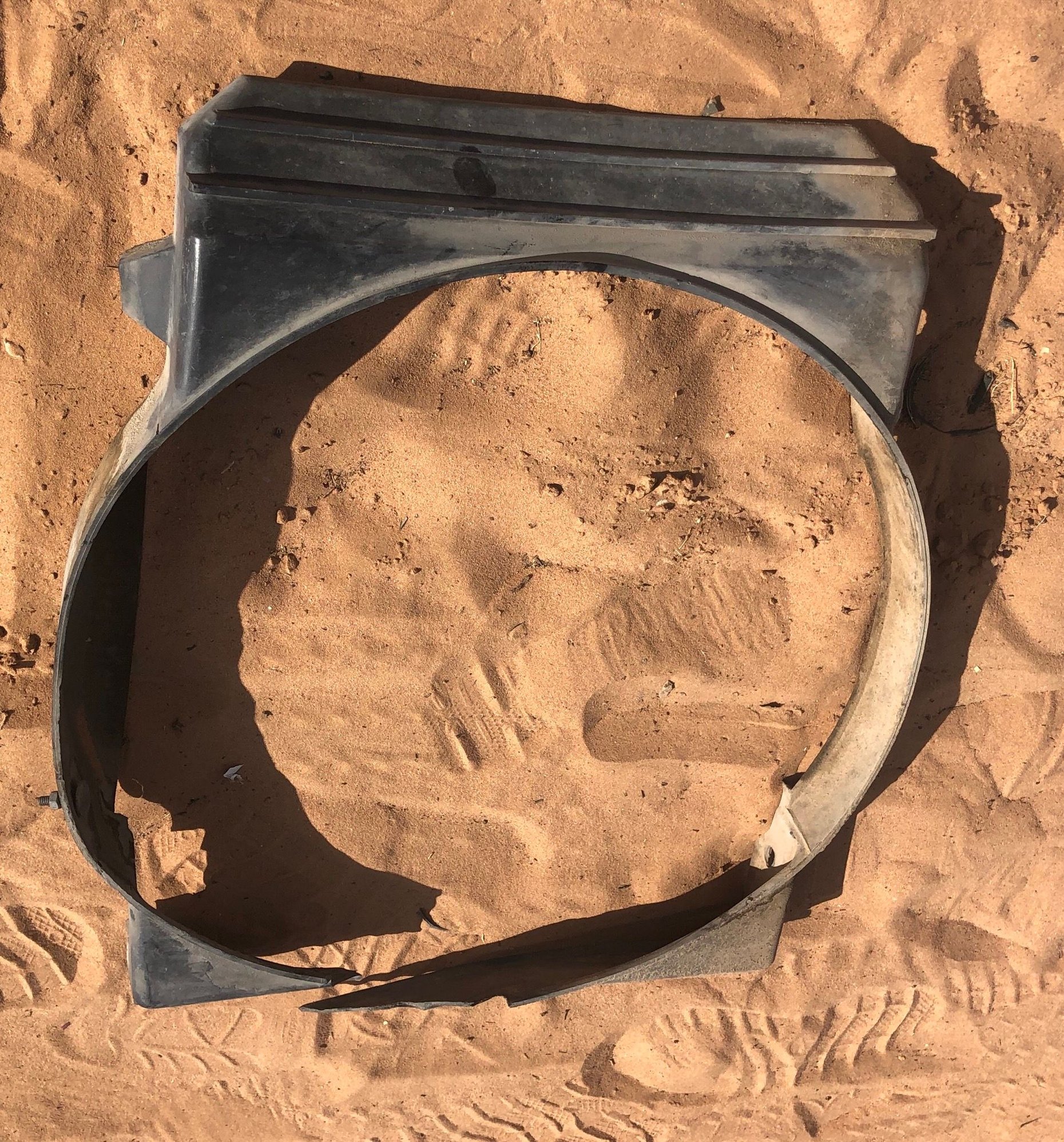

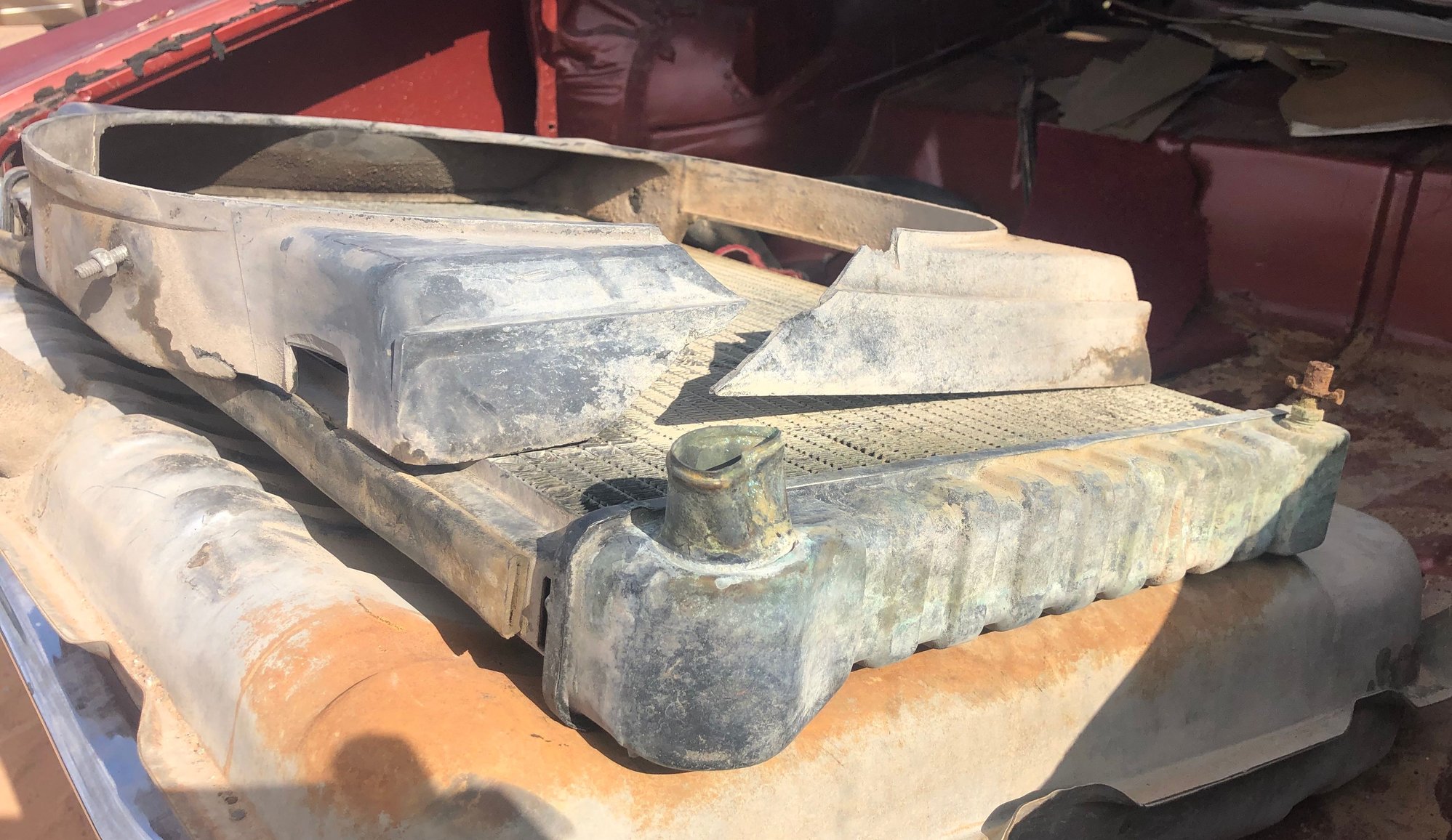

Radiator
Yep the original shrouds do not seem to be durable. This one I pulled out of El Paso car was broken, and missing several pieces. The radiator may? Be savable
, but will be fairly expensive to get out of yard. Price, core, tax, and environmental fee. Plus it is $600 ish now, even here, to refurbish an original radiator. Most small shops have closed, due to ever tightening rules and regulations concerning the chemicals and processes that they use. Most of the ones that survived, now are in the business of selling you a new aluminum job with plastic tanks.

Just an idea for a fan shroud: get a hold of a piece of plastic and a soldering gun and "weld" the cracked shroud back together. Been there done that and it works.
Old Aug 17, 2020 | 04:40 PM
RandyS's Avatar
Joined: Apr 2012
Posts: 2,972
From: New Mexico
You can also repair it with fiberglass matt. I repaired a hole in one that way a couple of years ago. That being said, with a new radiator and 4 blade fan, you may find that you don't need a shroud. My first 66 back in the day did not come with one, and my red one doesn't have one either.

If you are going to try and repair the plastic shroud, you can get one of the plastic welder kits from Harbor Freight or even a big soldering iron and use black zip ties for welding rod. The zip ties are polymer and don't harden as much as the actual plastic when heated to melting temps. Soak them in water for a day or two before using and they will be very soft and flexible. I repaired the plastic fuel tank in my old Dodge pickup that way. Werks fine, lasts long time!
