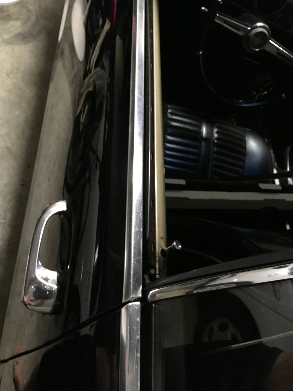

B85 option ?. Does anyone know who may sell the “correct “ window felt kit for a 1966 442 hardtop car WITH the aluminum reveal mouldings? Fusick sent me a set, does not work on cars that have the rebeal moulding, they now tell me they don’t carry that one..I was given a parts number for OPGI, IT does not fit either..even tho the ad says with special mouldings...wrong one.. I called PUI as I was told they make them. Cannot get a response.see attached photo, any ideas?

They are definitely aluminum.. cutting that steel top piece off the current ones looks like it would destroy The piece..big car may be an option if the sweep on the 1/4 window is the same length, other wise it be a mess.. crazy..

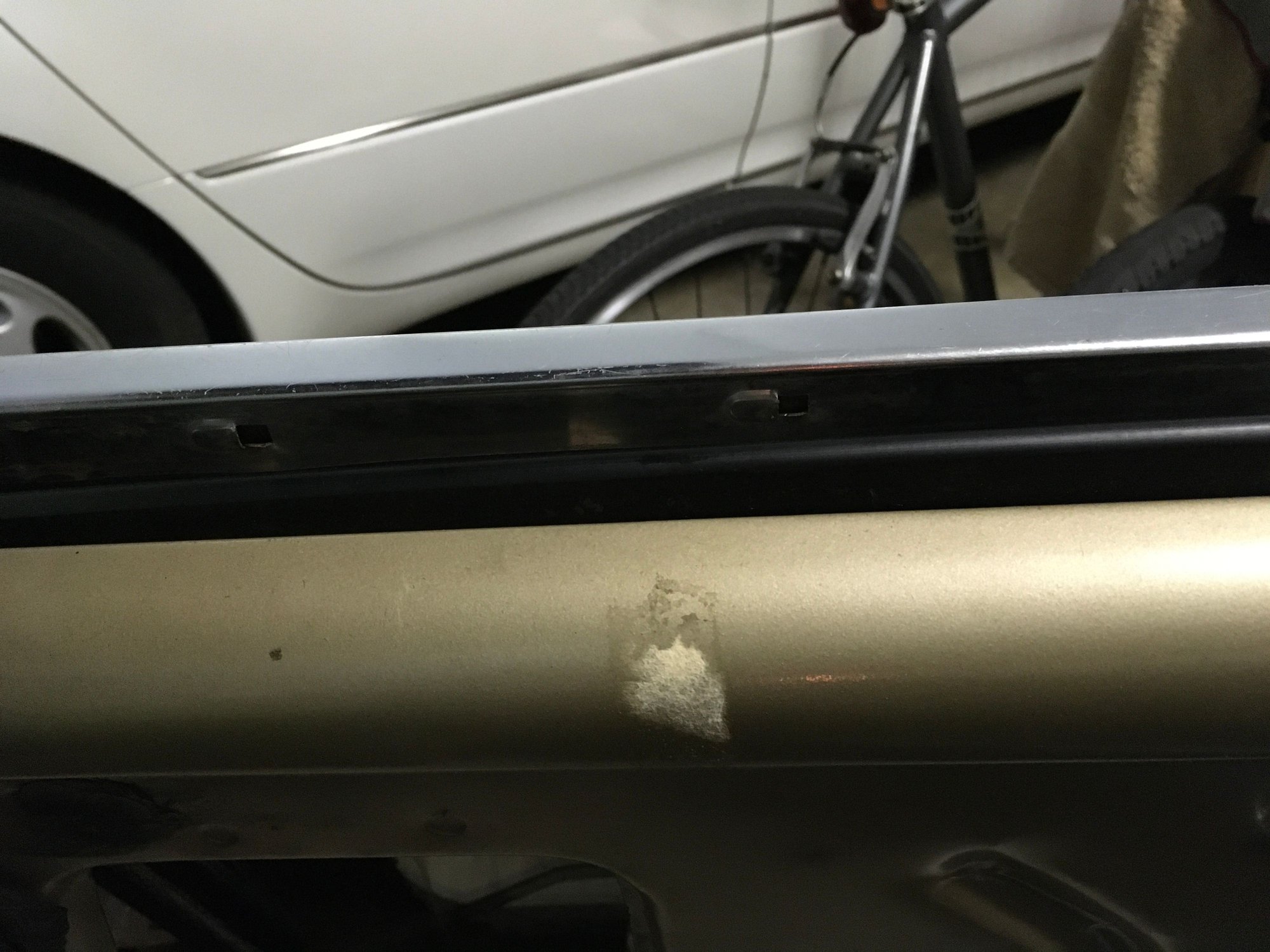

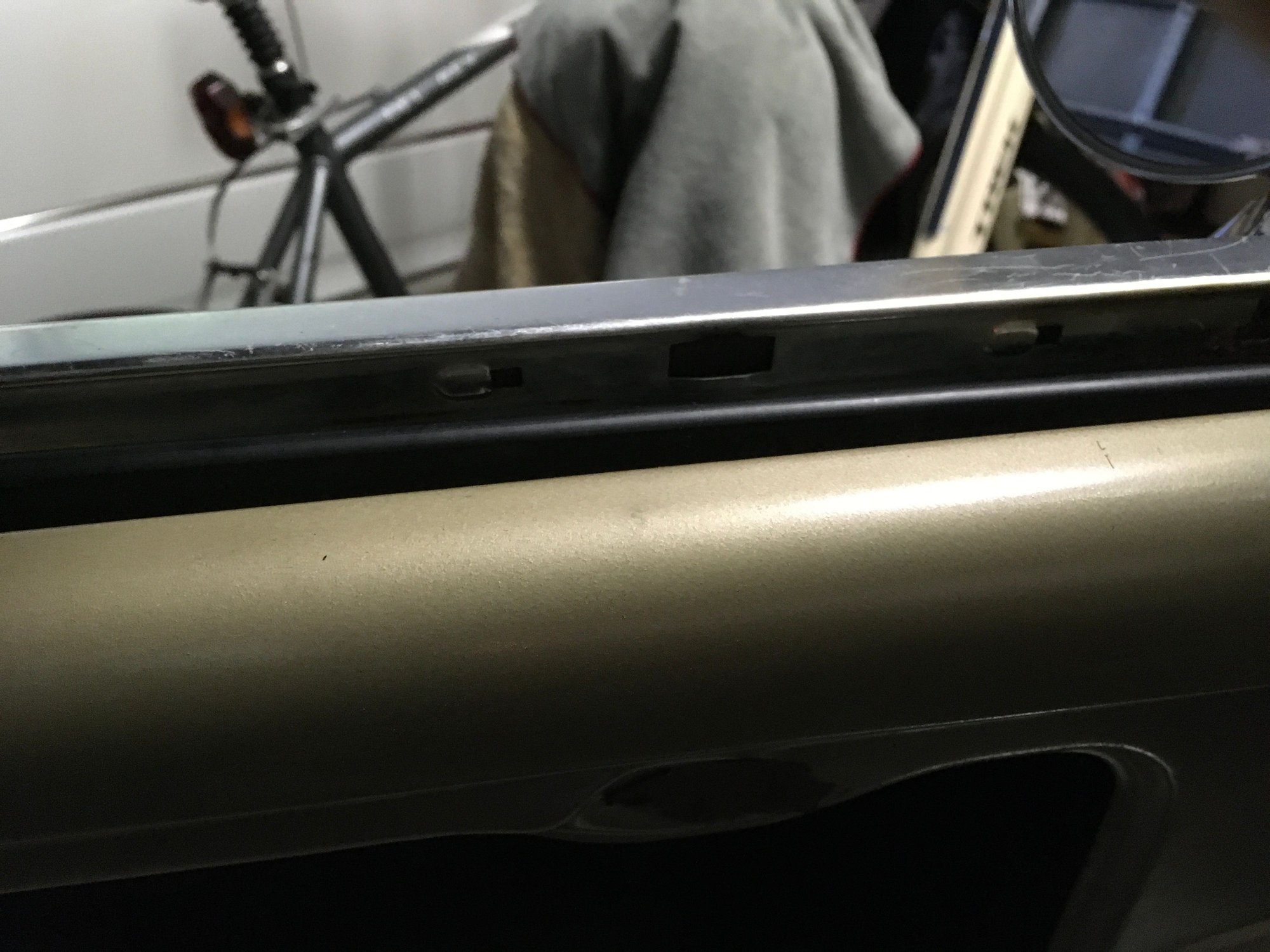

Randy, Show me a pic of yours please. On my car the slots in the metal door are not visable until you remove the reveal molding, there are little square holes in my reveal molding to clip onto. I would have to cut holes in molding to match door holes, somehow remove the chrome flat strip on the new set and then clip into slots..share a photo of yours so I can see what you are saying please

This is what my reveal molding mounting holes, slots look like.

Looks like I missed rubber on the outside molding vs. felt on the interior. Sorry. That outer molding is missing it’s rubber to my eye. On big cars, the windows are insulated from the door metal by the door panels, likewise for the quarters.
The interior has slots for felt from what I can see. I think the factory called their materials mohair. The replacement mohair I’ve got is thin & cheap, not fuzzy and thick like the old factory stuff. The thickness is what made windows not rattle around going up & down and when you close the door.
