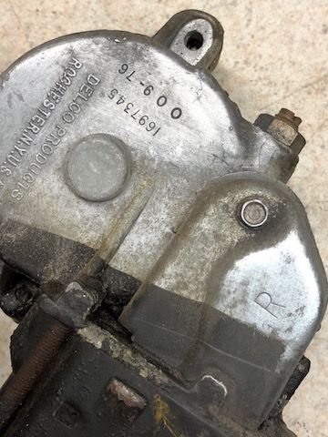

You should have 2 "left" motors and 2 "right" motors. I don't think the "B" or "D" letters identify left or right. Not sure to what they refer.

Old Nov 5, 2018 | 06:46 PM

I believe the L & R indicate left & right, I don't know what the B & D indicate. I have 4 motors dated 1975 & 76. Two have the L stamping and 2 have the R stamping. The part numbers are different than your's but that could be from the manufacturing date of the motors. Here are pics of my motors:
