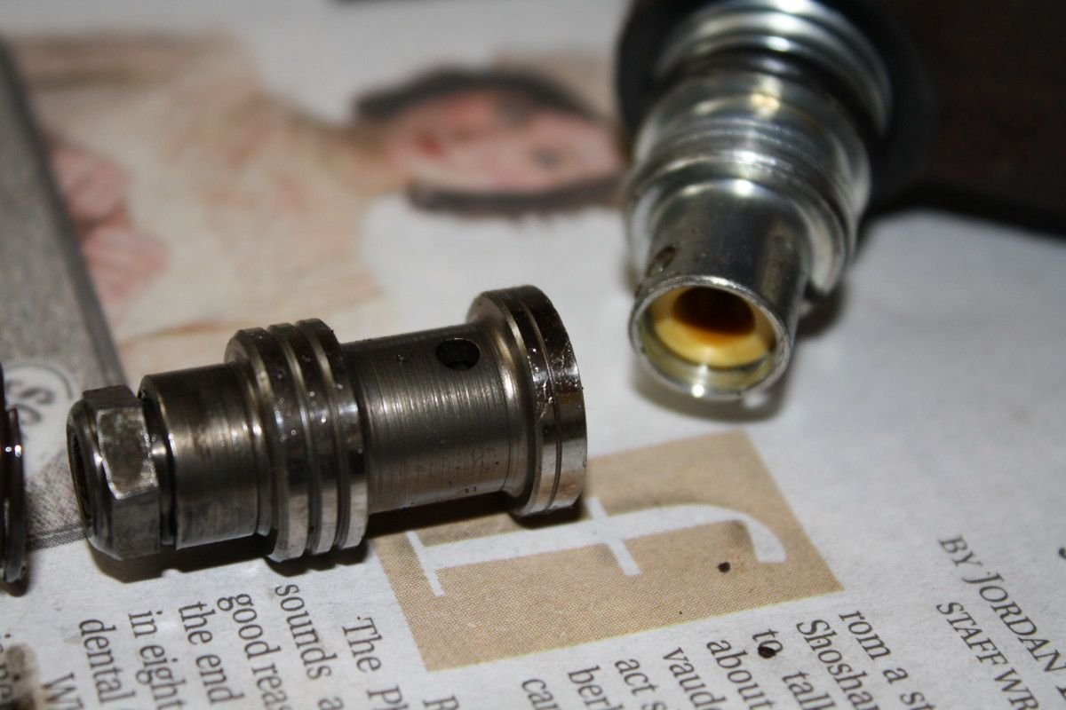

This is certainly the most likely cause, but if this does not work, check the flow control valve behind the high pressure outlet fitting in the pump. It's possible that you loosened it while replacing the hose.

I advise reusing the original pressure valve if you get a parts store reman. They're not always correct.
