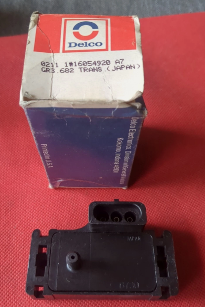

Be careful with boxes that say made in USA, etc. Even the Delco boxes. For example, the preferred OEM style differential pressure sensor on a mid-80s Cutlass VIN 9 engine (original p/n) says "Made in USA" on the box...yet all the factory ones were made in Japan. WTF.
Look closely:
This one they got right. Most I've seen of them has Japan on the box, but who knows what they did.
Look closely:
Not all of them!!
I know for a fact the Delco electronics plant here in Kokomo made map and other pressure sensors since the early 80s. My dad and uncle both worked in those departments.
On an unrelated subject, I toured the factory many years ago. The area where the silicon crystals were “grown” was interesting!
During the computer chip crisis a few years ago, it really pissed me off to see thousands of GM trucks stored in that parking lot waiting on the very components that were once manufactured inside that factory.
