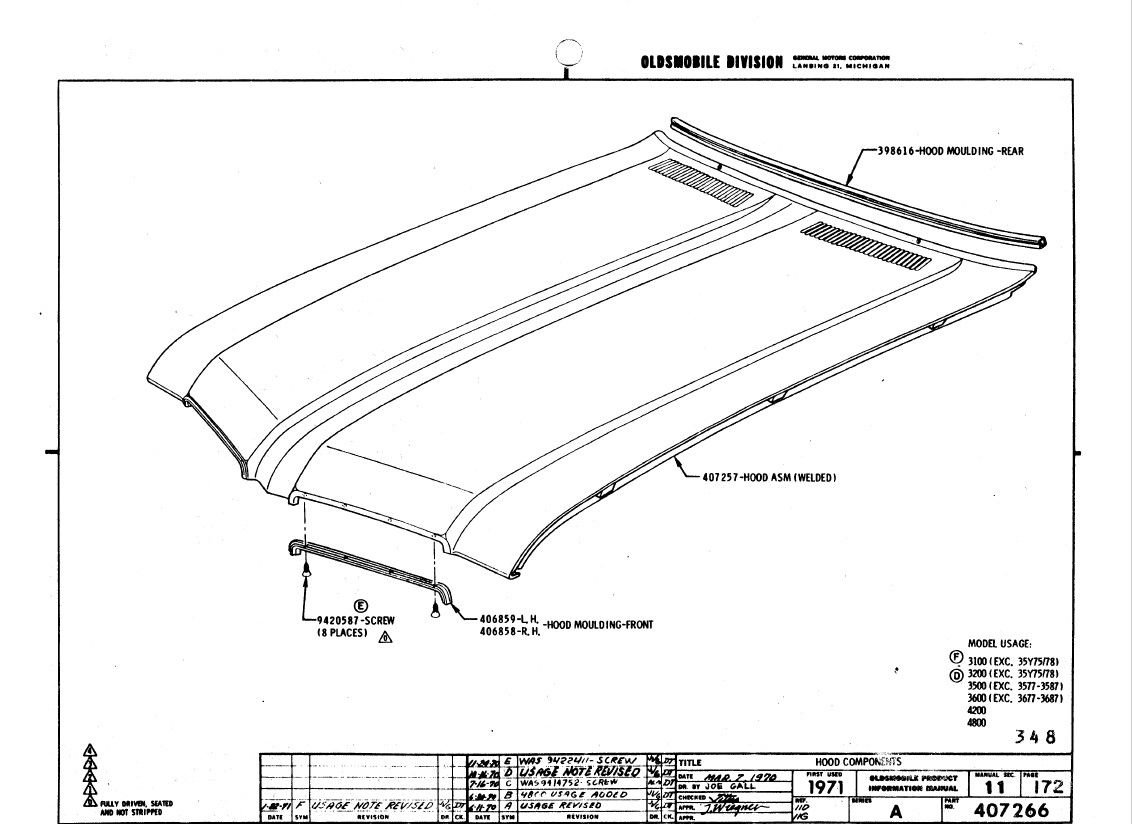

Old Sep 8, 2022 | 11:51 AM
Posts: 26,066
Old Sep 8, 2022 | 11:54 AM
Posts: 26,066
1970

Official parts book recognition is that it's called an "extension" for the hood "panel" that it bolts to. For all intents and purposes, the tooth is considered part of the hood on 69 and 70 F-85 models just as much as the chrome trim that bolts to the hood is. The 70 tooth is a bit longer (and just as deadly to your scalp), but in 1970, they had two parts numbers, one for F-85 without 442, and one for 442. I don't know anything about the tooth for 1970, so it may be it comes pre-drilled for emblems. 69 only listed one.
The 71-72 had no "tooth" and the stone shield was the plastic piece between and under the grilles which extended up from the . You'd have to loosen/remove the bumper and grille assemblies to get the piece out from the car. PITA.
The part number for the 69 tooth was 403961. And oh, there's a gasket that goes between it and the hood. P/N 404518 which fits 70 models as well. It's held on with short little 5/16"-18 screw bolts from the top that uses extended U-nuts on the tooth. The P/N was 390647 for the U-nuts. Need 3. Latest superseded P/N is 12338146. Auveco had them too under p/n AP8814 in an "Auveco Pak" of 3. They're fairly easy to find by size. As far as the bolts, you may can use Auveco p/n 10362. It's a bolt that's 13/16" length, with the hex head with washer built in. Looks like a radiator top plate hold down bolt. I can't recall the exact length of the original bolts. Don't forget the small trim bolts that go on the hockey-stick trim from behind on the sides.
Here's a sorta neat fact about those 69 "tooth" pieces that bolt on to the front of the hood. All the over the counter GM replacement parts I've ever seen had pre-drilled holes in the center sections for either the S/rocket emblem or the center "4" on the 442. The 69 H/O was the only "tooth" in 69 that I am aware of that did not have any pre-drilled holes, and the parts books did not specify any special part number for it. So if you suspect that 100% original 69 H/O you're looking at isn't 100%, this is one of the areas to look at. You can see the dimples on the back of the bosses where you could drill any and all holes you needed for Cutlass or 442 applications are already there.
