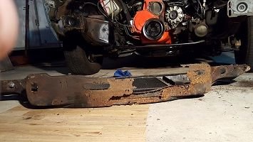

76 Omega Core Support Damage
I am in the process of repairing my 76 Omega core support. I welcome all advice, input, do's & don'ts.
I have also searched for information on replacement bushings. Such as dimensions, which makes and models that are interchangeable, etc. This info is not covered in the literature I have.
My mind tells me that the bushings used in the prior generation x-body could be the same. Am I on the right track?

The 1975-79 Omega is a Nova with minor sheet metal changes. Nova mechanical parts fit. The subframe is nearly identical to the one on the 1070-1981 Camaro/Firebird.
