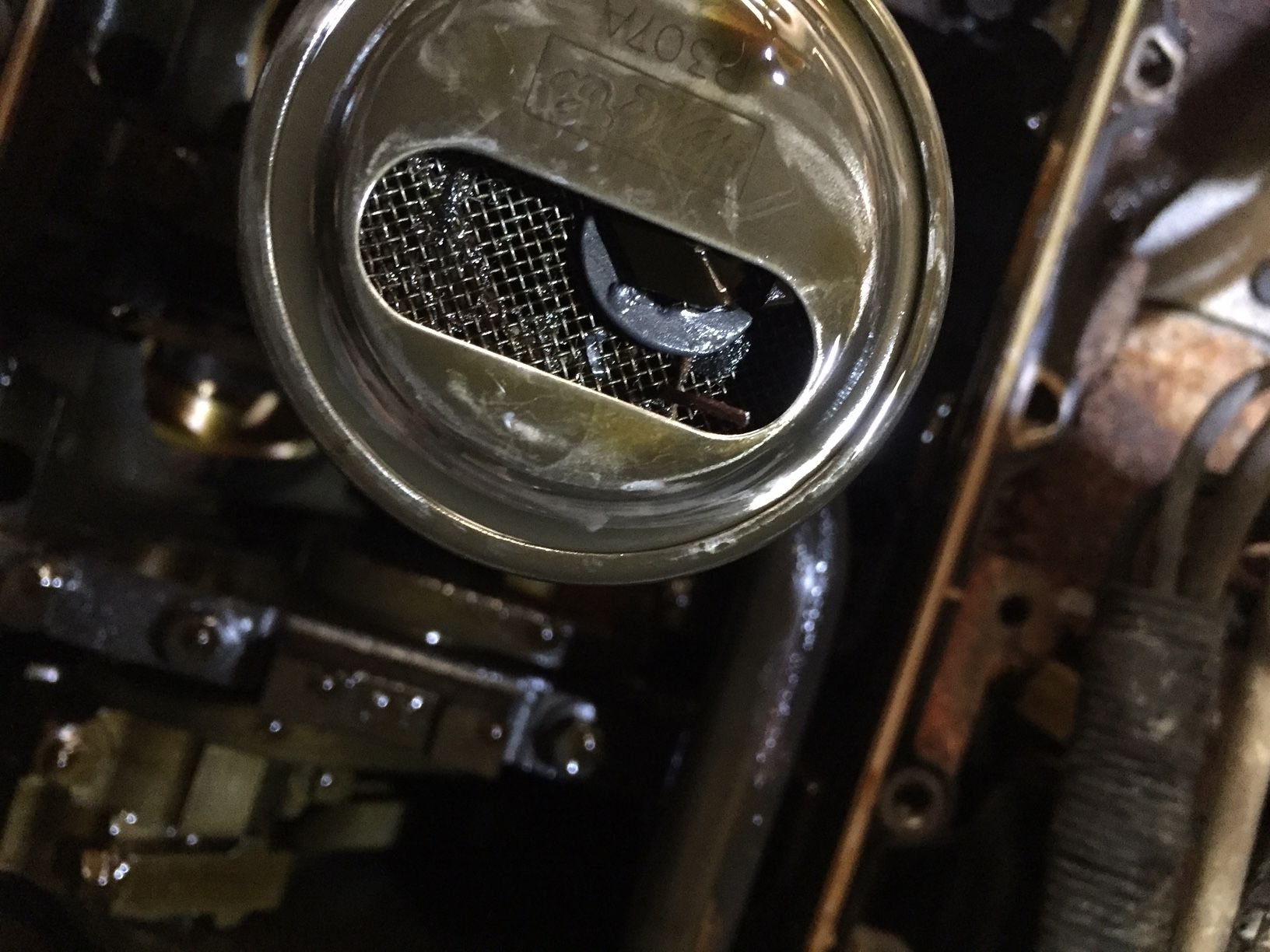

Here's what nightmares are made of: chewed up timing chain guide shredded in the pick-up screen of the 5.4 3v engine from my '04 F150. You want to talk about low pressure, the pressure on those things won't move off "normal" until pressure drops below 7 psi. Ran in various stages of that for at least 50k miles of knocking phasers and 10k miles of timing chain rattle; a full timing rebuild and it was good as new, so if your engine isn't making angry noises, you're probably fine, or at least will be with minimal effort. If your only issues are low pressure on a gauge, try a different gauge (not the dash gauge), and pull the pan for an inspection (try a boroscope first, you may get lucky and be able to see clearly). I'd certainly pull the pan and look for a clogged pickup before changing out bearings, especially cam bearings.

Agreed. Similar on that Ford (which has since been replaced with my '16 Silverado): as long as pressure is above 7 psi, the gauge needle points right in the center of the gauge regardless of pressure. Really just an idiot light, which has caused more than a few 3v engine replacements when they'd eat their chain guides. Hydraulic chain tensioners with seals that blow out placed BEFORE the cams, phasers and valves in the oiling circuit works great until it doesn't. We had a work truck eat its chains by 35k miles because of stupid rubber seal.
Thicker oil to raise oil pressure is just delaying the inevitable, IMO. On that above truck, switching from 5w-20 to -30 is common for overall longevity, but when you start having to jump to 15w- or 20w- oils, you've got a bandaide situation. How much time or money one spends to care, though, is subjective. They key, though, is ensuring the oil pressure numbers one is working with are accurate, especially if voltage is involved.
