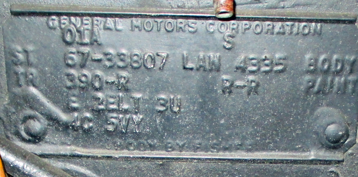

I believe the data plate is gone it has been to cold to spend much time trying to see If its gone or covered up with rust proofing

Finally got some time to look at the car the data plate is gone. Is there anyway to tell form the serial number what model it is all the badges have been removed. other than

The appearance pretty much identifies what this car is, a 67 Cutlass Supreme Sport Coupe. It appears to have AC although it may have had a bench seat originally since it looks to have had the front seats replaced. The serial number can be decoded somewhat but I dont think it will tell you the trim tag info such as date produced and options noted on trim tag.

Yes, the second and third characters of the VIN are the model line and the fourth and fifth are the body style. I'll bet that your VIN starts out 33807xxx, which would make it a Cutlass Supreme Sport Coupe.

Yup, based on the all red tail lights and backup lights in the bumper? Cutlass Supreme Sport Coupe. 1967 the CS was the only model that the 442 package (L78) was available for. This could also be a turnpike cruiser (L66) if it has a 400 CID 2 bbl engine. Not likely it was a 442 because the hood is wrong and the nameplate on the dash has Cutlass Supreme on it instead of the 442 logo. Still, check out the engine; if it's a 400 you just might have a scarce car.
Too bad the data plate is gone, but the VIN tag on the A pillar should tell you what factory it was built at. The cowl tag for your car would have some information that might have been helpful if you were looking to go back to original. It would look something like this:

Thanks for the info the vin no is 338177m is this helpful.

Are you sure it is not 33807? That is what it should be. I wonder now if your car had the vin tag swapped and trim tag removed so they could not be compared?

The car in the photo is a Sport Coupe, which came with a 338077 VIN. The 338177 VIN would be for a Holiday Coupe, which is a hardtop.

This is a 338077 (your car) which is a Sport Coupe (aka post coupe) Note the framing around the door glass and quarter glass. You also have a B pillar just in front of the rear quarter glass.
THIS is a 338177, aka "Holiday' coupe. Aka HT coupe. Notice the difference around the side door and quarter windows? This is something you can't do with a post coupe

A GOOD picture of the VIN plate would likely prove very interesting.

Does this year have the vin on the frame ? If so it might be the post car vin or the ht vin

Yes, the vin is on the left rear frame horn, between the wheel arch and the bumper bracket. Would really be tough to see without a lift and some cleaning.

The frame stamp is not a complete VIN, only a VIN derivative. It is only nine characters, not 13, and does not contain the important second through fifth characters of the VIN, which are the model and body style. Of course, the last six characters may or may not match, depending on if this body was put on a different frame or not. And frankly, how many here have cars that have had a frame swap?

Vin on the frame the last number match the vin then you know it was a body swap for sure, might not had been intended as fraud but was. It's a gamble. I was thinking it would have the whole vin and it would match the post vin sad that it's just a partial you could have researched that vin to see if it was a red flag. I wouldn't touch the car tell you figure it out! contact the seller see where you can get there

Further to what Joe stated, I know that frames produced after 67 will have the same VIN Derivative stamped into specified frame locations (2) that will be found on the engine stamping pads and some transmissions. I have not seen the VIN Derivative on a pre 68 frame though. The VIN Derivative follows the formula:
Division (eg: 3 = Oldsmobile)
Year (eg: 2 = 1972 model year)
Plant (eg: M - Lansing, Z - Freemont etc)
Last 6 digits of manufacturing VIN
So the VIN derivative of my car (as example) is 32M208783 which I have verified on my engine and TH350. Haven't had the body off to find the other frame stampings though. I'm sure they're there though.
