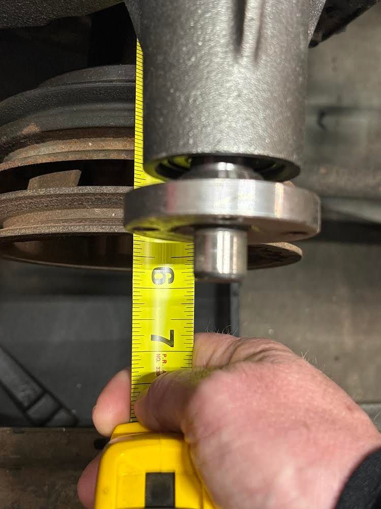

It’s a 66 F85 Deluxe with a 330 with no A/C, no PS, no smog. Alternator only. As I mentioned, if it has to have an extra groove that’s not a problem. The measurement from the pump housing to the end of the pulley hub is as measured in the first picture from the timing cover. Seeing as this is the only option they offered it’s proving to be a pain either way. I’ve read multiple times that the longer shafts have higher flow which is beneficial when we do some minor modifications in the future.
Measured from timing cover
From pump case at base of shaft

The first measurement is the one that matters. That's a 5.6" pump. Your car would have come with a 5.1" pump. The pump you want is an Airtex AW773 or GMB 130-2773. Amazon can probably get one of those to you in a few days. That's still going to be faster than finding the right pulley. Hopefully you didn't turn in the old pump as a core.
