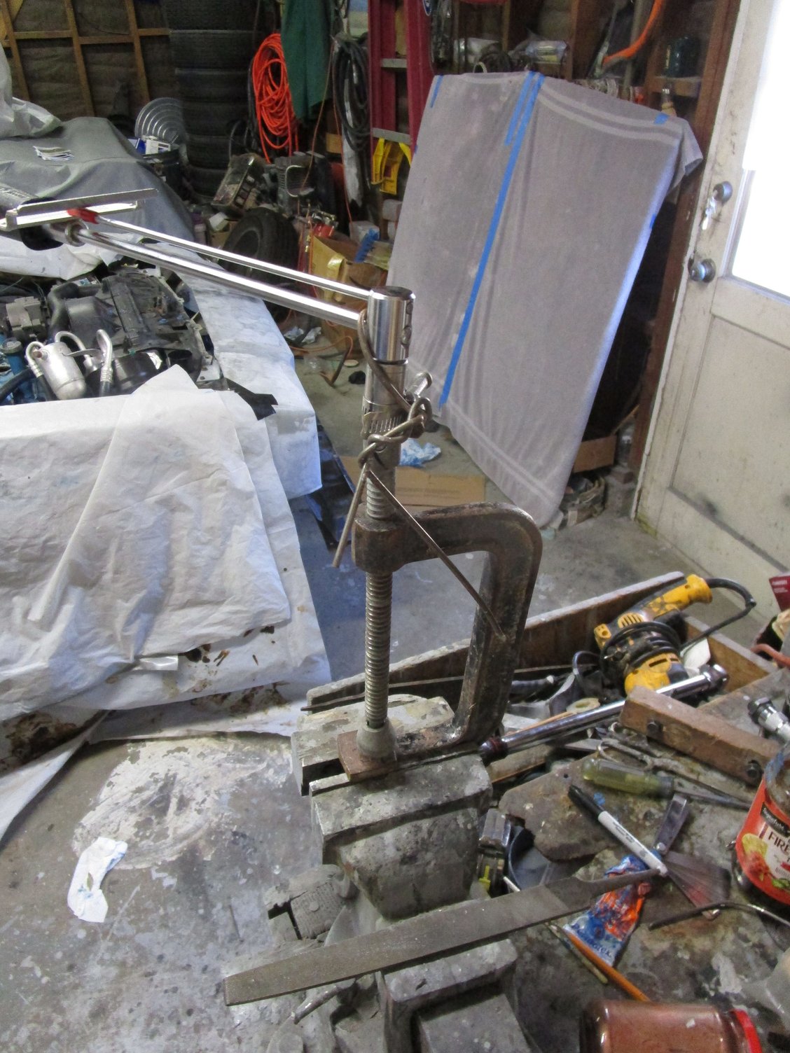

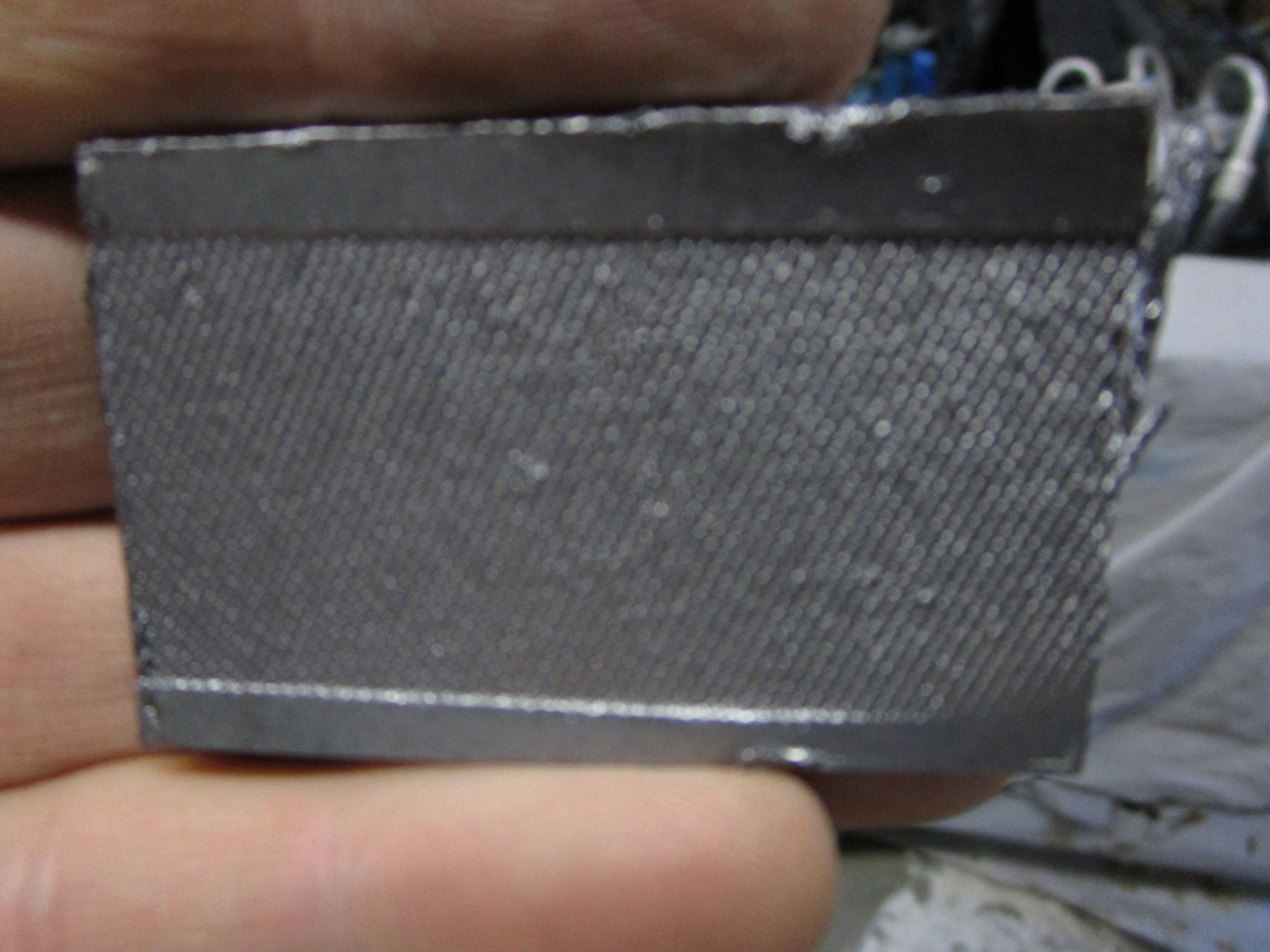

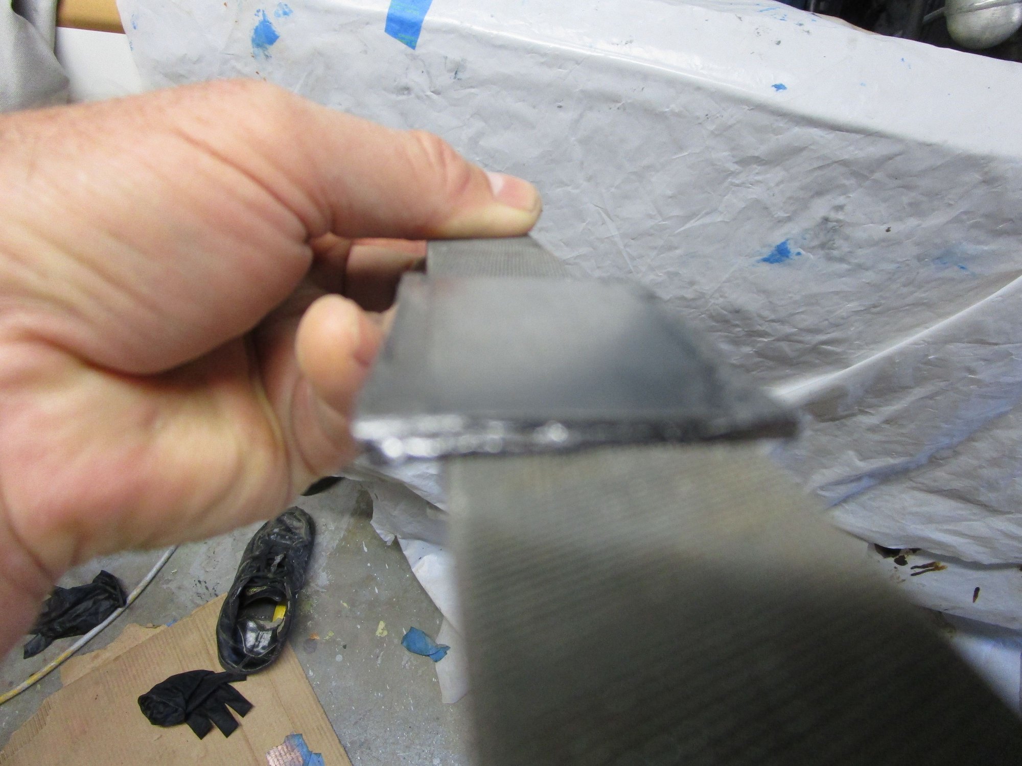

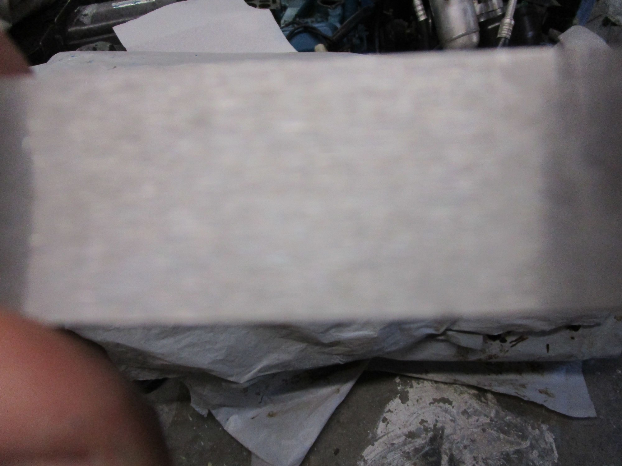

So looked on the internet if there was any proof to the Remflex claim that the material fills pits. Surprisingly I could not find any examples, not even from Remflex just their plier crush test.
So did some Pollock Engineering, and since I am a Pollock I'm good with it and I am sorry if I offended any other Pollocks out there..
So I can up with a crush tester.
I put a C clamp in a vise, I found a 3/8 drive socket about the same size as the C Clamp head and used a hose clamp to hold them together, then connected a torque wrench, used some wire to tighten clamp while torquing.,
I put the Remflex between a flat file and a piece of precision ground steel..(to 0.001")
I will be using 20 ft. lbs (240 inch lbs) as this is what I was told by Remflex to torque my manifold to as the test Torque. The goal is to check how well the Remflex fills in the nooks and crannies.
The Remflex crush test file side is obvious, the ground steel has some indentations from grinding. See photos

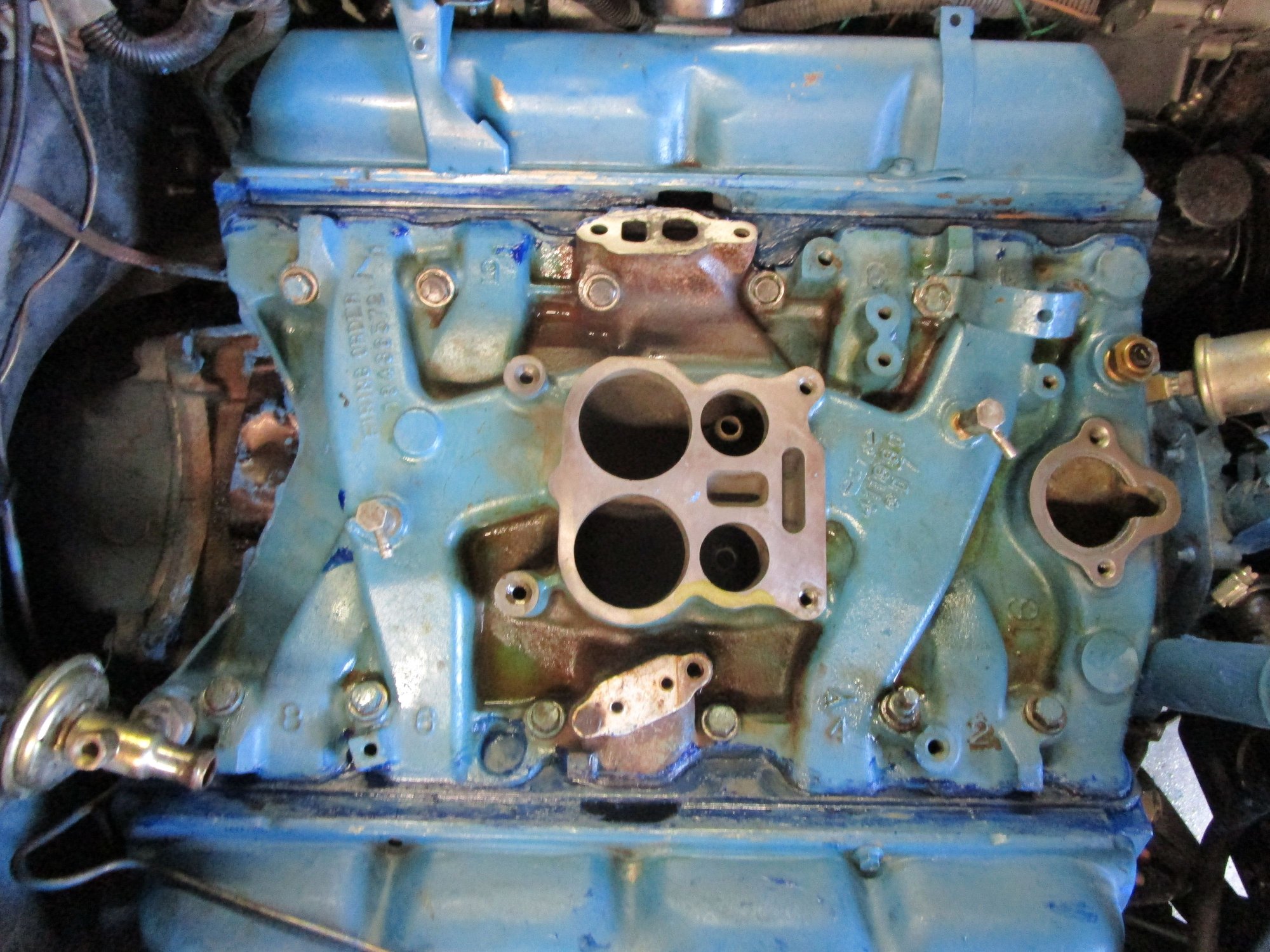

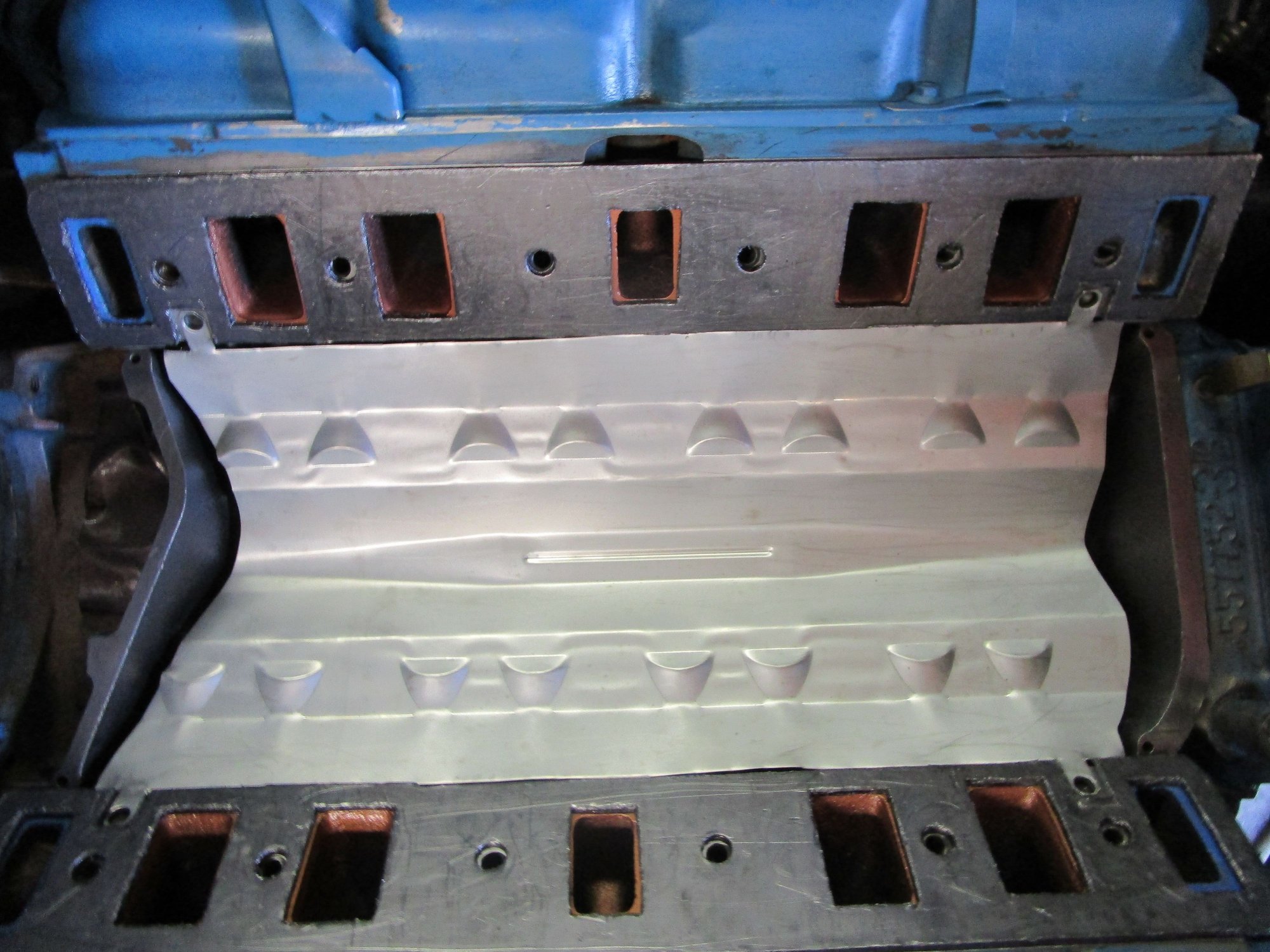

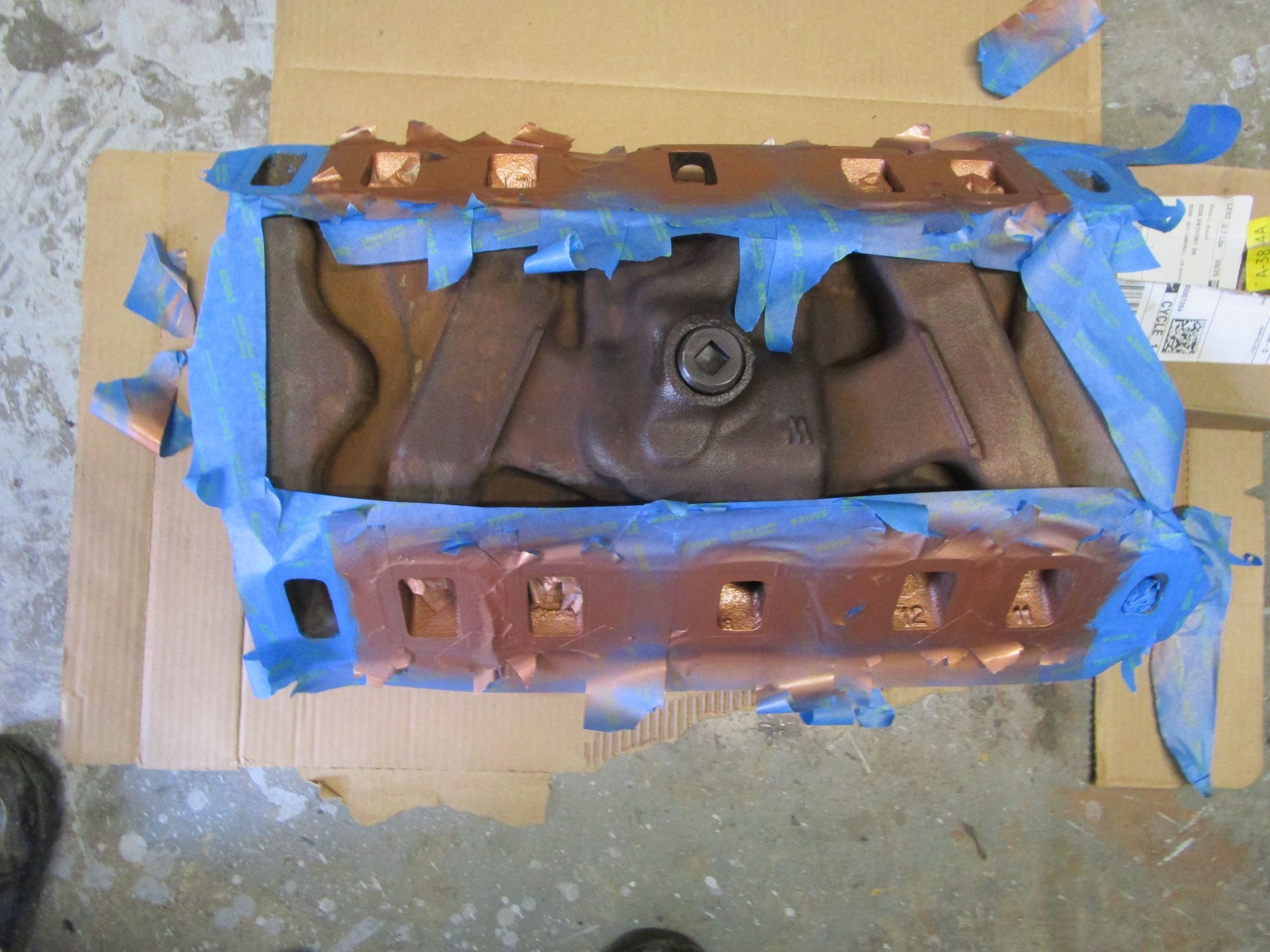

OK installed the intake. More Pollock Engineering.. So when I cut the Remflex out, it is a bit jagged. Also my concern about backfire pressure and if Remflex can hold it. So For the intake and Heads I tapped off about an area of 1/8" around each port of them. I sprayed copper spray around each iintake and crossover port and a very thin coat of ultra blue rtv around the coolant ports. I ran a thin bead of Permatex Permashield around the perimeter of the heads and intake to help further seal it. The previous night I sprayed copper spray into a jar and let it thicken up, After I placed the gasket on the heads, I painted with a small brush the inside of the cutout Remflex to help hold any Remflex crumbles and well has help resist backfire pressure. Sealed the ends of the block with Ultra Blue RTV. I like the way the Ultra Blue sticks and as many times I've tried this, I have never had a crankcase leak here. Torqued in small increments, to the final 240inch lbs = 20 lbs. Took about 12 tries over 3 days to get it to settle down to torque specs. . See Photos
