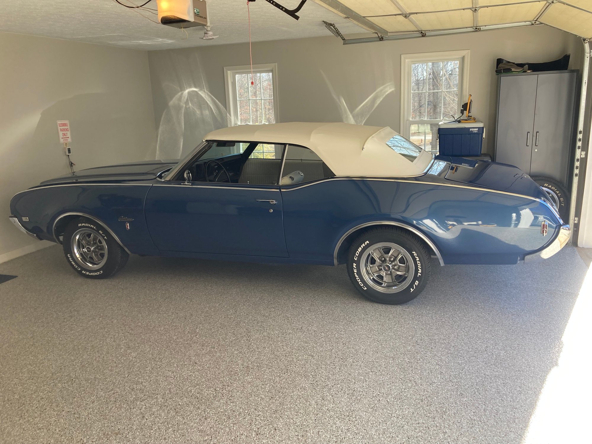

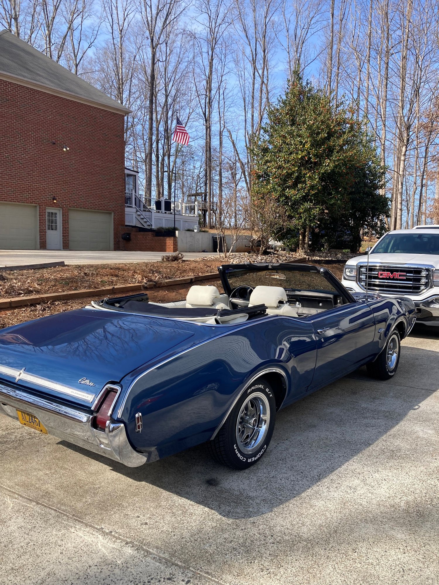

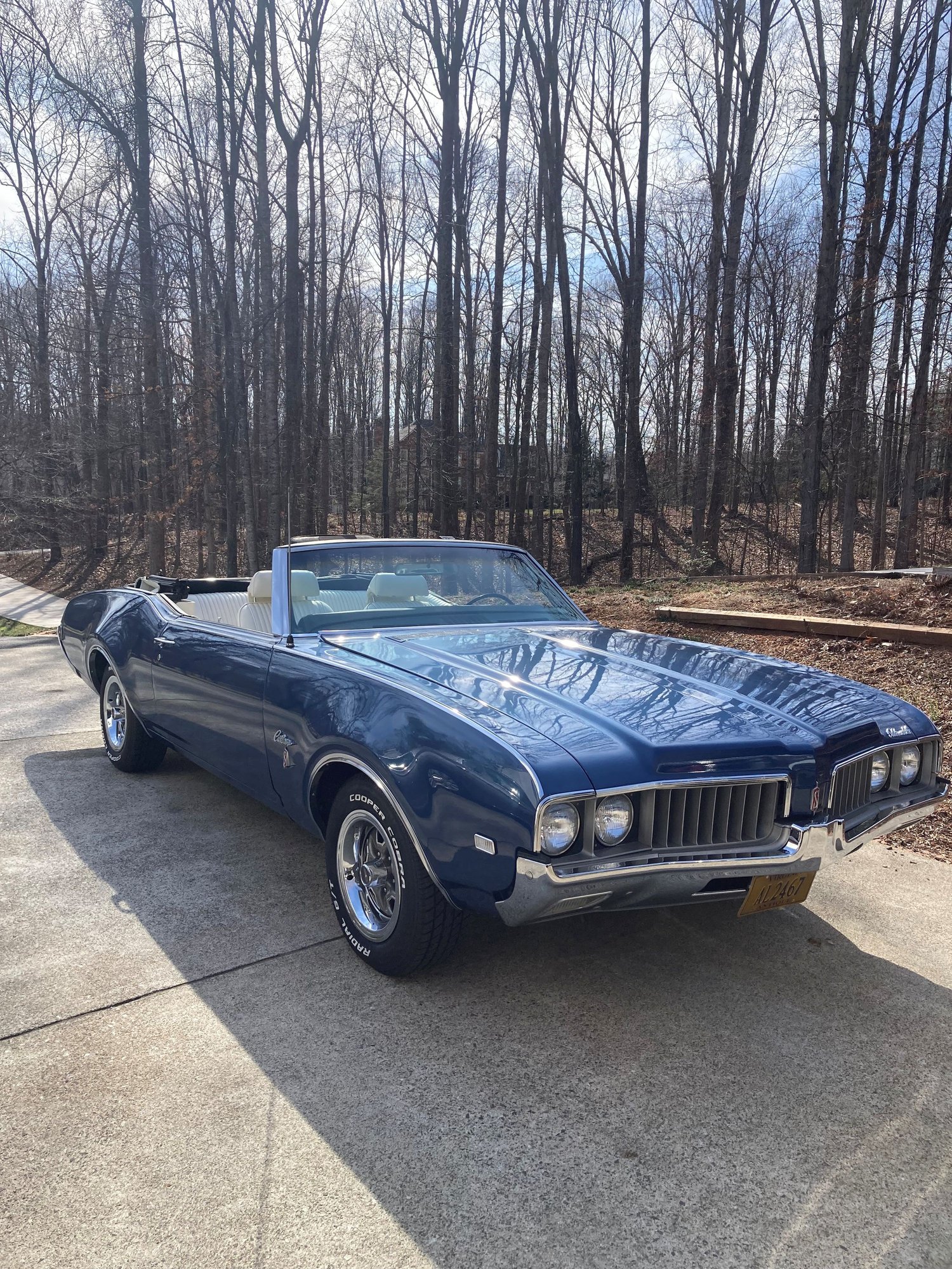

Some pictures

Nice looking car!

Wow... Nice ride

Blue Cutlass , the pictures of your car / the rims are Olds Super Stock / 5 x 4 3/4 . If you change to a 12 bolt Chev diff , would that not be a 5 x 5 bolt pattern ? if yes , then would not fit the Super Stock rims .

I never knew this. I put in a 12 Bolt Rear made by Moser. My wheels fit. Huh.
NO, Chevelles, Camaros, Monte Carlos all have the 4 3/4 bolt pattern and use the 12 Bolt Axle. 5 on 5 was used in the larger bodied vehicles
