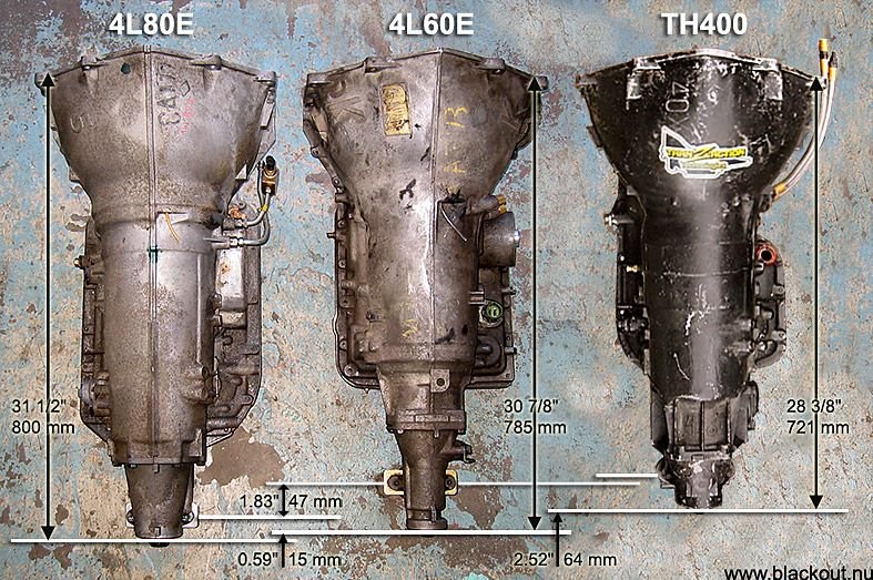

Is there a modern OD auto trans that will fit a '70 A-body without cutting the transmission tunnel?
Thanks.

Define "modern". Also, automatic or manual? The 200-4R is the easiest OD automatic swap, but it went out of production 30 years ago, so I don't know if that meets your definition of "modern". Yes, it requires internal mods to live behind a real motor.

I was thinking something lalong the lines of a 6L90, something that will not need to be beefed up.
Thanks.

Your first post specified "without cutting the transmission tunnel."
Have you even looked at the size of one of those? Even a 4L80E requires some tunnel massaging. You're talking a trans from a one ton truck. It also weighs nearly 100 lbs more than a TH400.
And note that the problem isn't length (which is somewhat longer), it's width and height. Those extra gearsets and clutch packs need to go somewhere. And do you really need a 4.02:1 first gear with two overdrive gears? That's for pulling a five ton trailer.
Old Jan 18, 2021 | 04:49 PM
Some photos to consider
4L60E on the left, 6L80E on the right.
6L80E in a Camaro tunnel.

Thanks Joe. I thought more modern transmissions were more compact.
