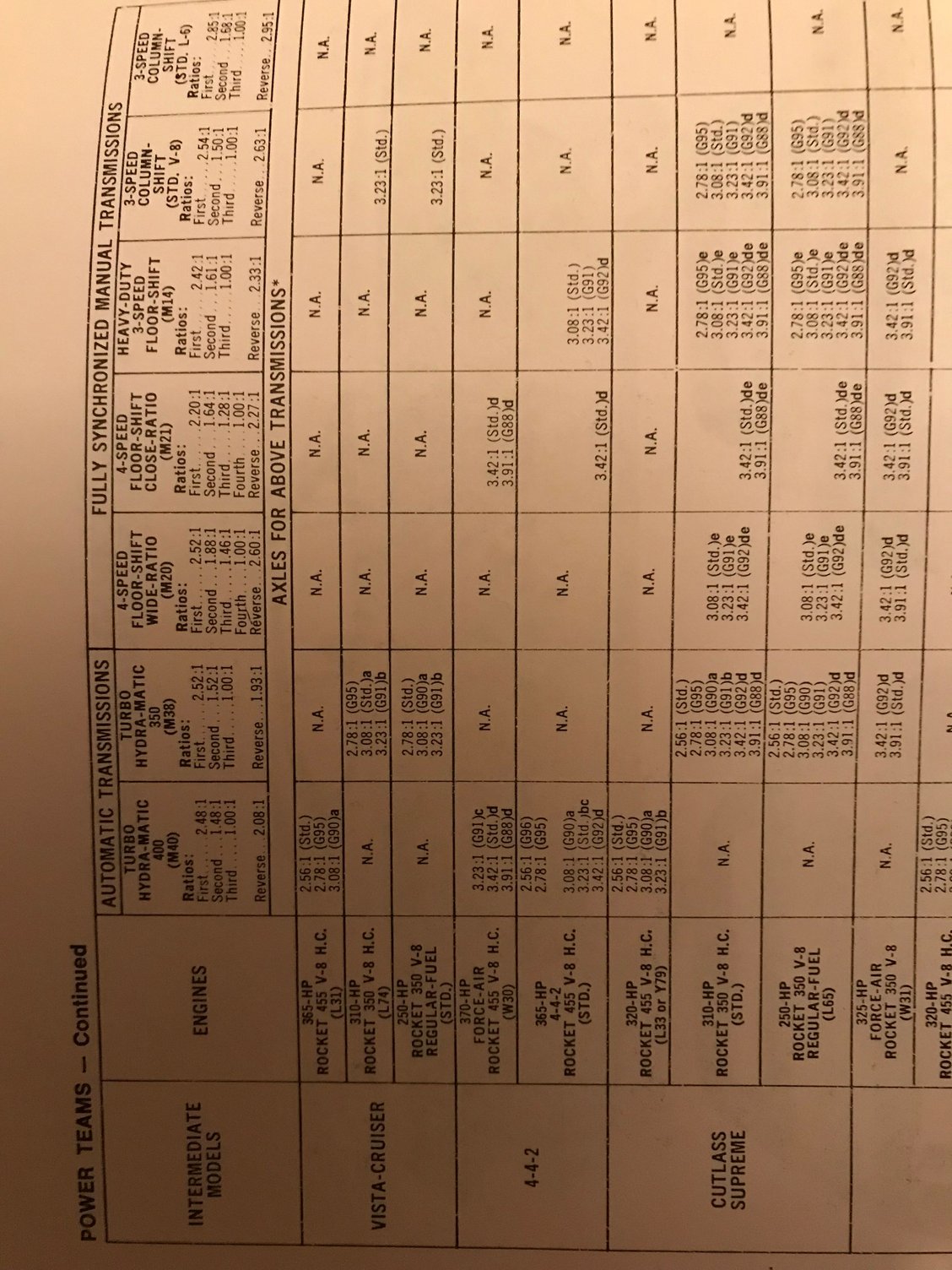

Does anyone here have experience driving a stock ‘70 W-30 with an M-21 and 3.42’s ? What was your driving experience ? If you had the tranny out of the car to “be gone through” would you change any of the internals if you were not satisfied with the stock setup ?
Old Nov 24, 2020 | 04:50 PM
66-3X2 442's Avatar
Posts: 5,193
From: Birmingham,Alabama
The theory behind using a M21 is the gear drop between 3-4 is less than a M20. These cars are heavy and need all the help getting moving. The Olds is a torque engine and the gear drop doesn't hurt using the M20. Think of it this way,drag racers use the steepest low gear they can get. I have no experience with the car you're asking about but plenty of experience using the Muncie trans. If it were me,I would change the gear set to the M20.

Must have been a lot of disappointed new owners of W-30, LS5, LS6 and GTO vehicles with M-21’s in 1970.

Old Feb 13, 2022 | 08:52 PM
Bigmikey65's Avatar
Joined: Jan 2020
Posts: 790
Am I correct in saying that the only 4-Speed manual transmission available on a 1970 W30 was the Muncie M-21 Close-Ratio with the 2.20 first gear OR was the M-20 Wide-Ratio with the 2.52 first gear also available ? With the M-21 Close-Ratio transmission 3.42 rear gears were standard and 3.91 gears were optional ? From what I have read it’s not exactly clear cut.

I bought a 1970 Corvette with the Special High Performance 350 and had it for 45 years. It came standard with an M-21 and 3.70 axle (SLR 8.14). It was difficult to get a good launch without trashing the clutch. Even a clutch dump at 5500 rpm resulted in only 100 ft of wheelspin and a 13.70 at 107 mph.
I learned from that experience. And when I built my Vista Cruiser I paired a 2.66 first gear with a 4.10 axle for an SLR of 10.90. The Rocket lives up to its name in first--even leaving at idle.
And, yes, an M-20 was not an option on the 1970 W-30. An ex-brother-in-law had one with gearing of 3.42 (SLR 7.52). It was lifeless from a start; above 40 it was unbeatable. A 4.66 axle would have woken it (SLR 10.25).

It’s pretty bizarre that you could only get an M-21 in a ‘70 W30 when you had the option of getting a M-21 or M-20 in a ‘70 W31, Cutlass Supreme and some other models. Both tranny’s were equally capable - I wonder what the reasoning was ?

The M-21 was considered the ultimate for racing because it had equal percentage rev drops between gears. It was expected that you would order a numerically-high rear gear to create a suitable SLR.
The stick shift W-30 was considered a racing vehicle.
The M-20 had roughly equal rpm drops from 1 to 2 and 2 to 3, but had a much bigger drop between 3 and 4.
