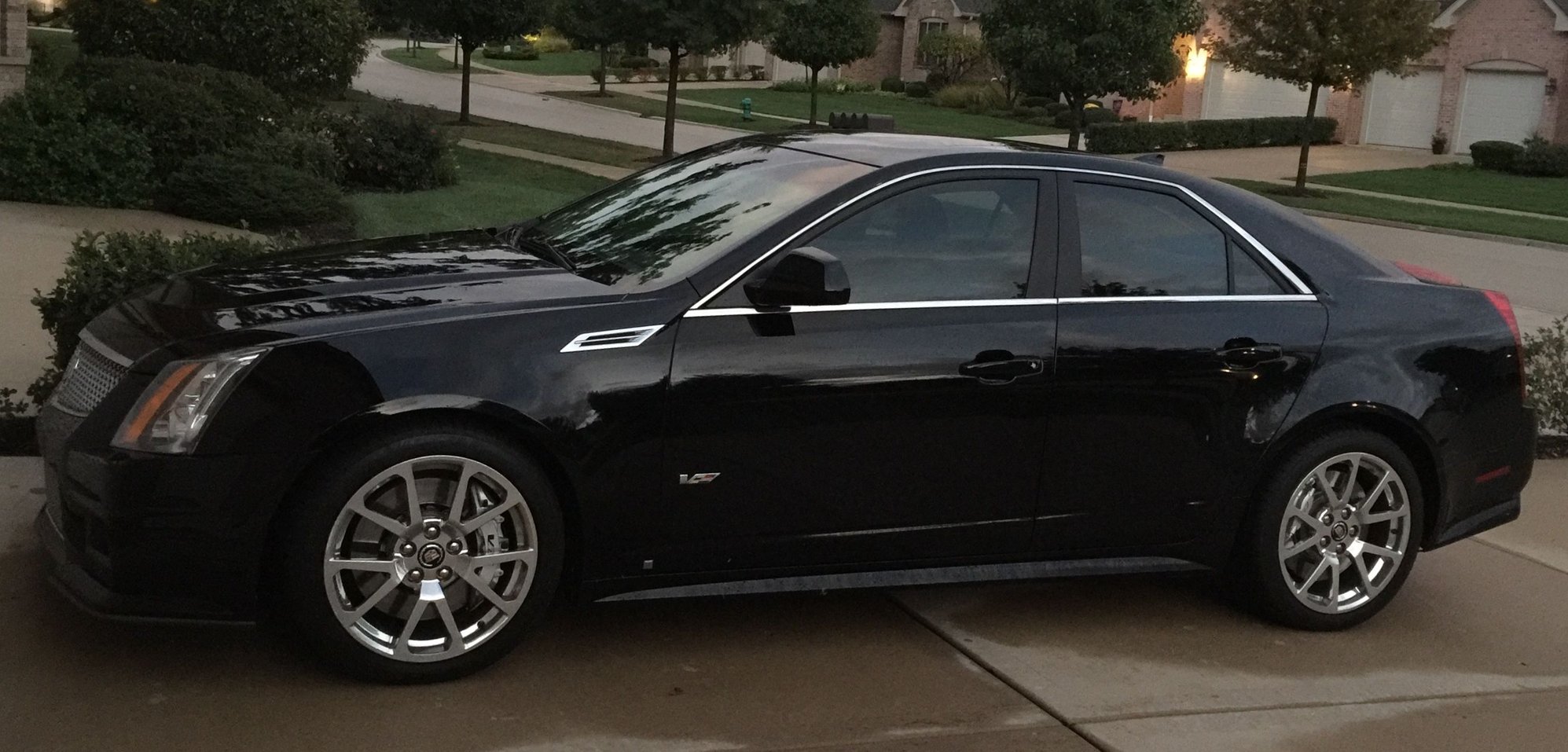

Overdrive transmissions are an idea that, once it gets into someone's head, it never leaves. They're simply not necessary for most rear ends and encourage driving faster at cruise than the rest of the car was designed. Most people don't upgrade suspension, steering, brakes, seatbelts, but have no issue with doing 85 in overdrive at cruise with very little ability to slow or steer at that speed. Good luck.
Those darned kids going fast! I can tell you when I was a young lad I cared not if my brakes worked properly or if I could go around a curve. So, great points here. First car a 69 Chevelle w/ a small block, powerglide, and a 3.08 open rear diff. It was perfect for a hooligan. Not very fast but w/ a decent cam it sounded like you were.
Nowadays, I had a CTS-V that ran bottom 11s. That's too fast for a kid but they all have them including the Hellcats.
