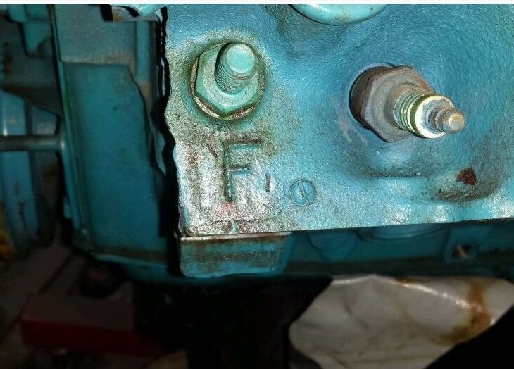

The seller of this 455 actually went out of the way to point out that the "F" heads are actually doctored "E" heads, including showing the casting number. There really are honest people left in the world.

The way to tell is to look at the casting number, not the letter. It's easy to change an "E" into an "F". It's very difficult to change 403686 into 404438. In this case, the seller actually showed the 403686 casting number in addition to the altered "F"

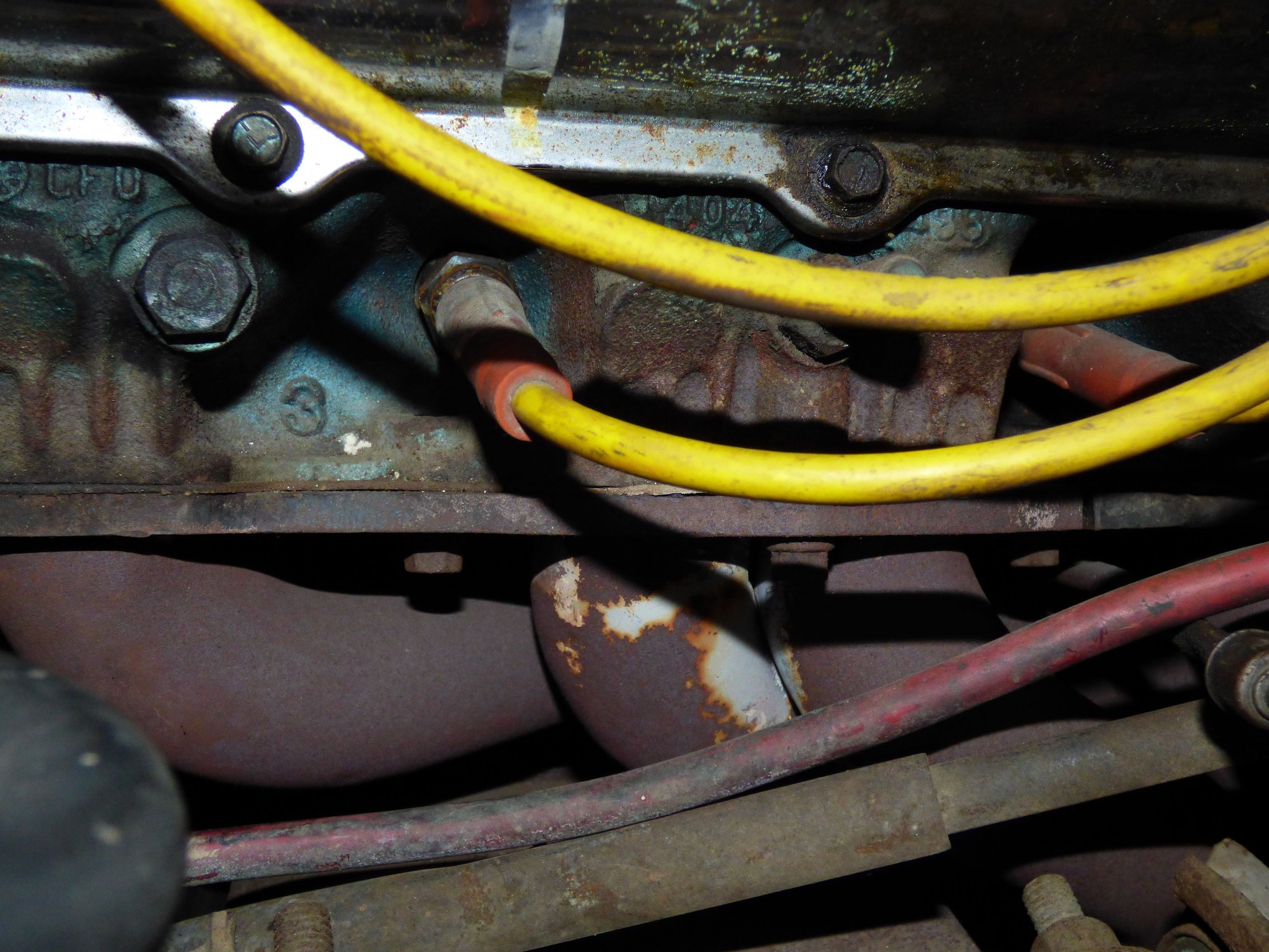

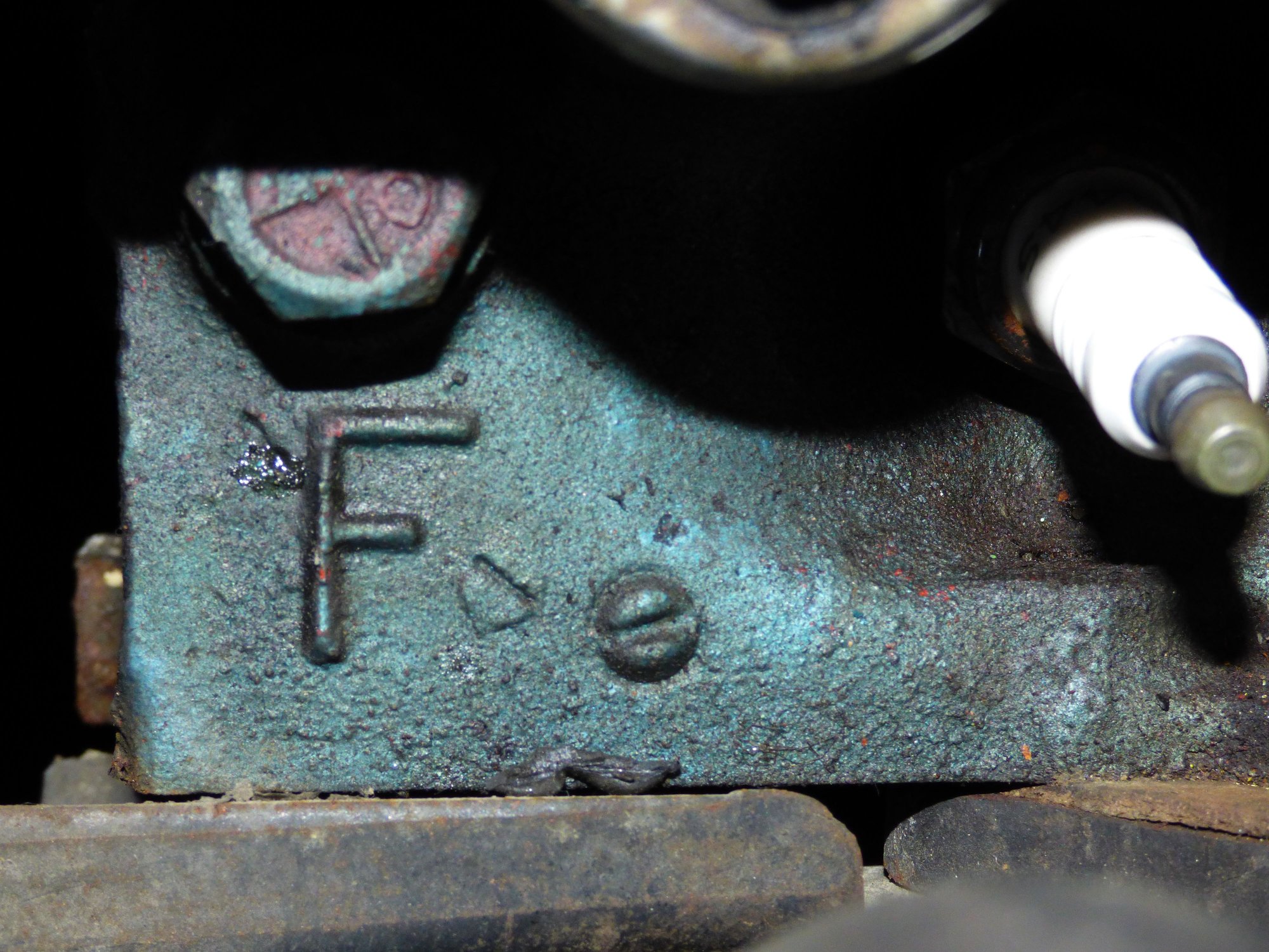

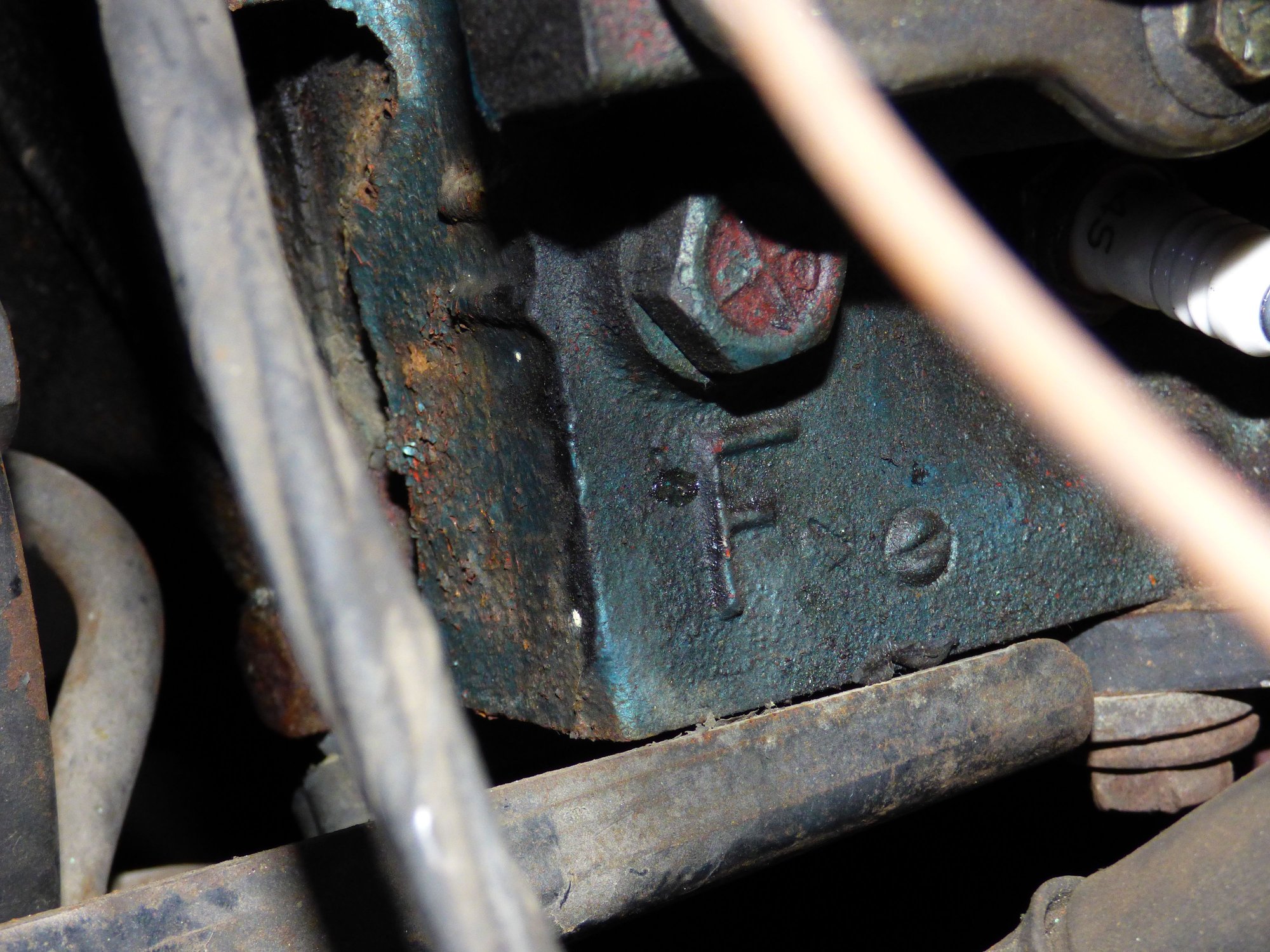

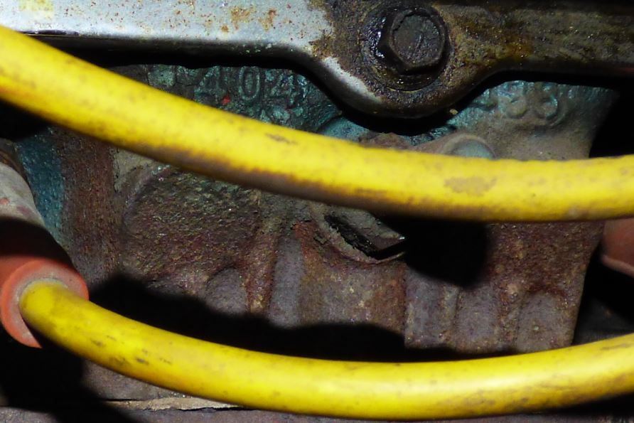

Went out and took some more pics. Trying to help because so many have helped me here:

Very different font on the altered E, were any of the F's like that or were they all sans-serif like the real deal pics here?

ebay altered E f head pic

Ah, I was looking at this one...but now that I look again, that's on the block, right?
Yes, here is the one I have from under the car:

Well that F in post #10 looks almost like one of mine but I an 99% sure that I never altered just the main ID part. I do the big ID and the 6-digit. I leave the underside proof of original casting intact.
I see around this "F" what appears to be the edge of the modified area, about 3/4" square, with some discontinuity to the texture. A close inspection with a magnifying glass should make it apparent.

If anyone has any ideas why there is some signs of red on mine, I'd like to hear what that's all about. It has given me an uneasy feeling and although it may be fine, I'd rather know sooner than later if it isn't.
