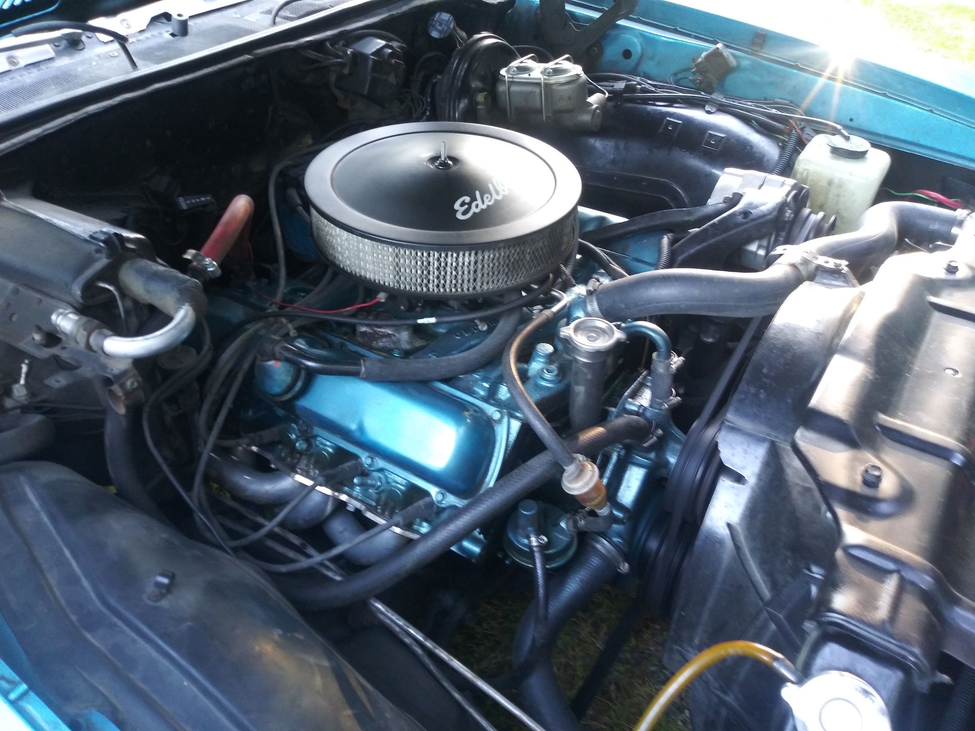

Not sure if there's anything else, but after 1700 miles on the 1st oil change its gone through a little under half a quart of oil. After 4700 miles the motor longer looks new which is okay. The car runs at about 185 degrees. The timing seems to work best at 14*idle, 34* with mechanical advance and about 10* of the vacuum advance restricted (about 1/2 the range of travel). I have the idle set at about 700 rpm and it really purrs at stoplights. Not exactly sure how quick it is, but it will smoke both tires and hasn't embarrassed me since I replaced the carburator. Strange thing is, it will only do about 120 mph at about 4900 rpm in about 1/2 mile and gets right up there, but just hits a brick wall at 120. Not sure if this is normal, but I really don't need to go that fast anyway. I think the gas smell was a leaking hose clamp just above the fuel pump which I tightened. Will need to drive it to know for sure. I don't believe the car is running rich. Pulled a spark plug and it is a sandy color and the spark area is shiny. Picks of plug and motor:

If the ultimate goal is to drive and enjoy, I think you made it. Good looking car.
Your timing and tuning settings are inline with mine. I'd say your top speed is indicative of power output pushing an aerodynamic brick that these cars are. You're making more power than I am. Have Fun!

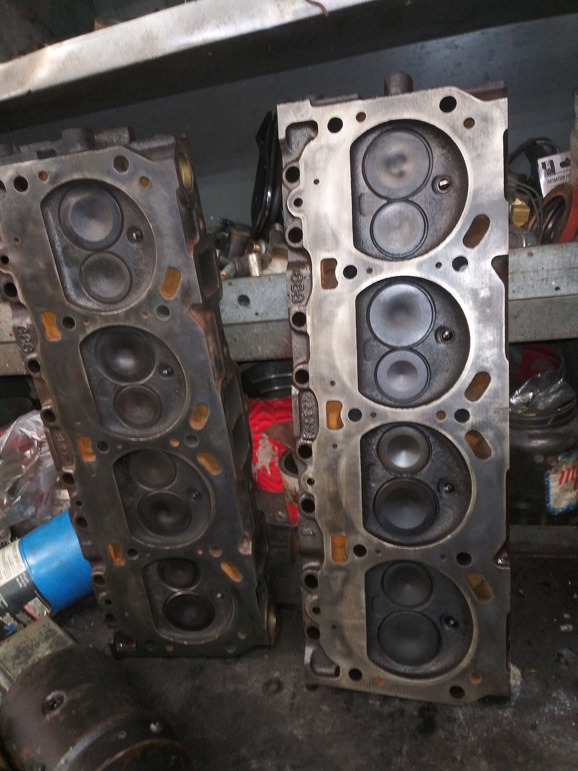

I'll assume many things are similar. What's different? I can only assume your engine is in better health than mine. Meaning mine is high mileage and a bit worn bumping 200K. I still have a quadrajet, unknown headers low comp. and an Engle JM16-18 camshaft. It will do mid 15's in the quarter at about 90MPH. I think with the weight considered and doing some math, I have about 215hp give or take,at the tire. I think you have more considering the top end speed. MIne won't do that.
this is what the motor looked like when we pulled the heads. The previous owner said it was recently rebuilt but you never know until you pull the heads
