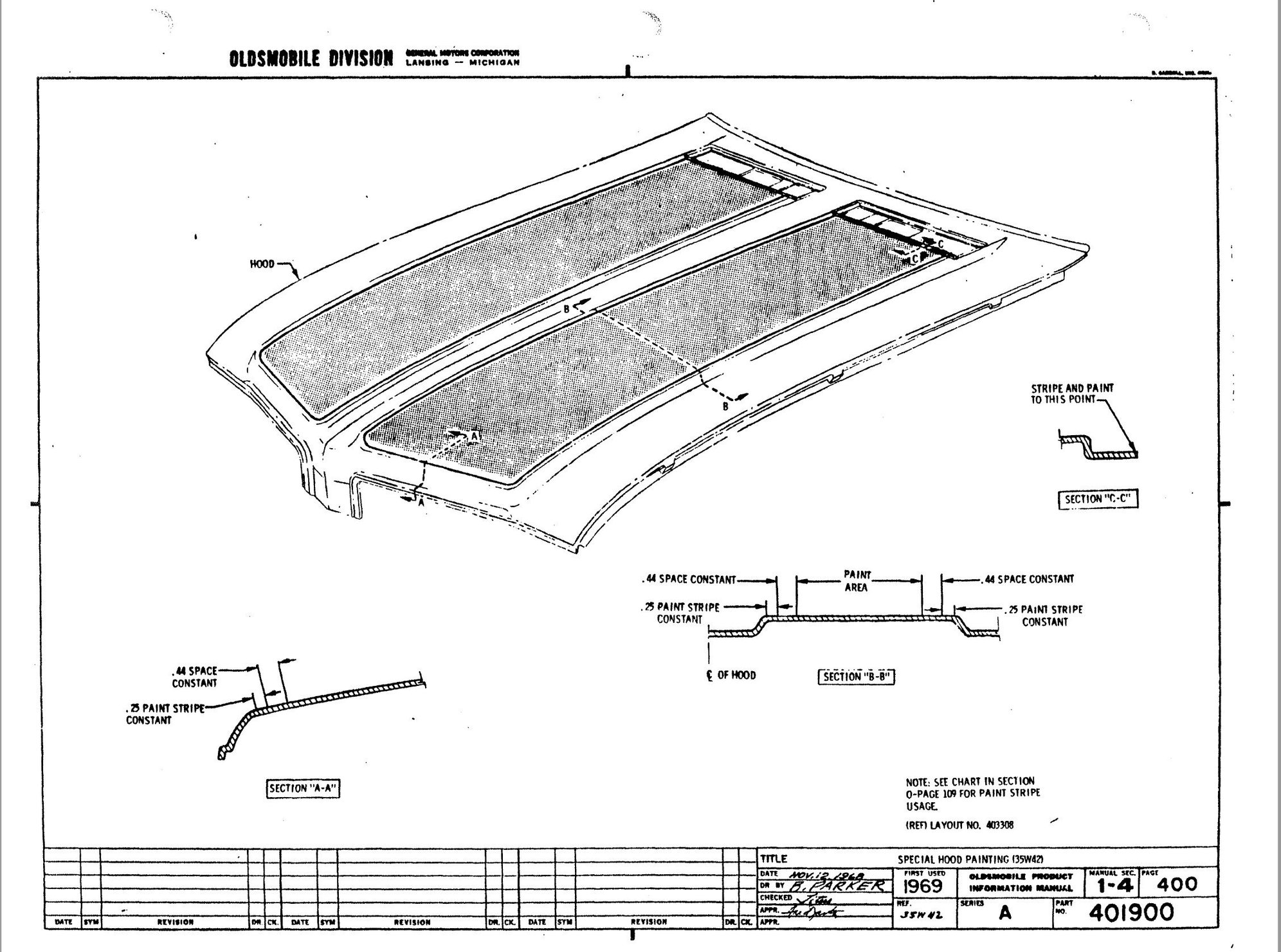

I need to have my 69 442 in the body shop to fix the door. I thought that I would look into adding hood stripes while it is there. I need to know the exact size and placement. Is there a place I can get this information. Thanks

Pinstripes???
Or the fat stripes?

Thanks, that's just what I needed
