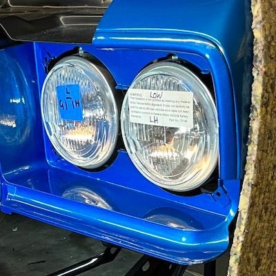

I replaced my sealed beam headlights with the Hella H4 E-code kit in bccan's post above. I added relays at the same time so I can't comment on headlight switch, circuit breaker issues. You will need to open up the hole in the headlight buckets to make room for the rubber boot that seals the backs of the Hella housings. I like that they are glass and not plastic (as are some replacement kits, including most LED kits), one other thing that I especially like about the Hella kit is the flat face of the bulbs compared to the stock T3 bulbs. The flat face is pretty subtle but I think it adds a modern styling to the front end. Here's a close-up pic of the Hellas:
