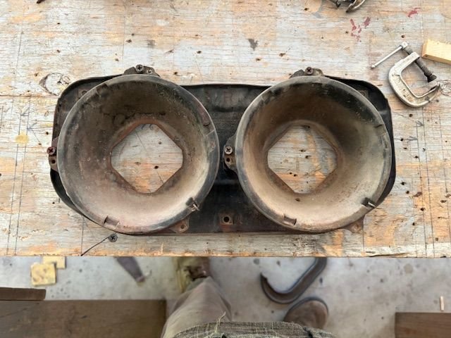

Just worked through the headlights on the 72 Cutlass. Since I was into working over much of the right front and side of the car, I removed the assembly and worked it over on the bench. This requires grille removal (not difficult)and then the complete assembly can be taken out by removing three 1/4” cap screws from the back side. My plastic trim was broken but I think that it could come off the car attached to the metal headlight assembly. The three small screws holding the trim ring are machine screws on my car. I think 6-32’s. Not plated, so rusty. I blasted and painted it all, back on the car now.
Off the car
Off the car

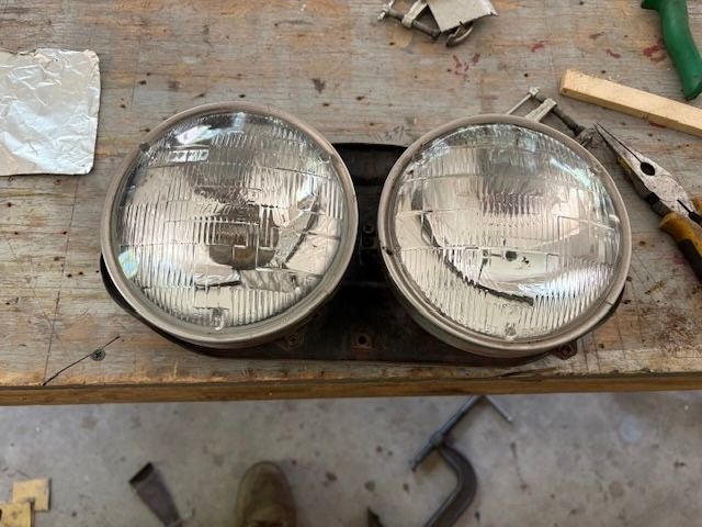

Trim rings off, revealing the light bulb holders.  They are held in place at two Adjuster screws and on retaining spring.  Grabbed the spring with a vice grip and it came up and off fairly well
Trim rings off, revealing the light bulb holders. They are held in place at two Adjuster screws and one retaining spring. Grabbed the spring with a vice grip and it came up and off fairly well

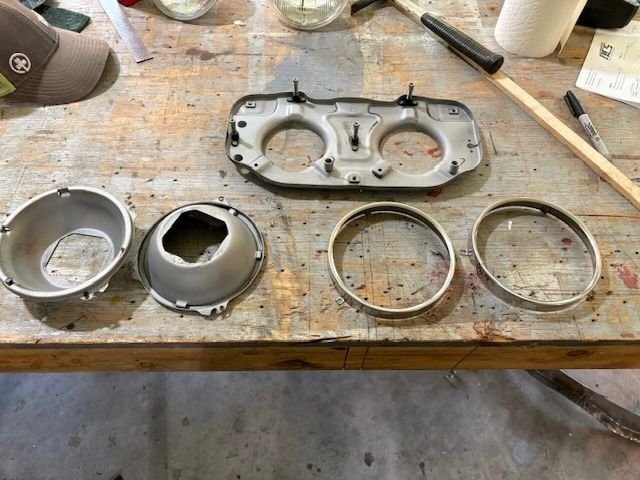

Sand blasted it all, except trim rings.  Lacquer thinner to remove previous red overspray and then ammonia based metal polish.  They cleaned up well

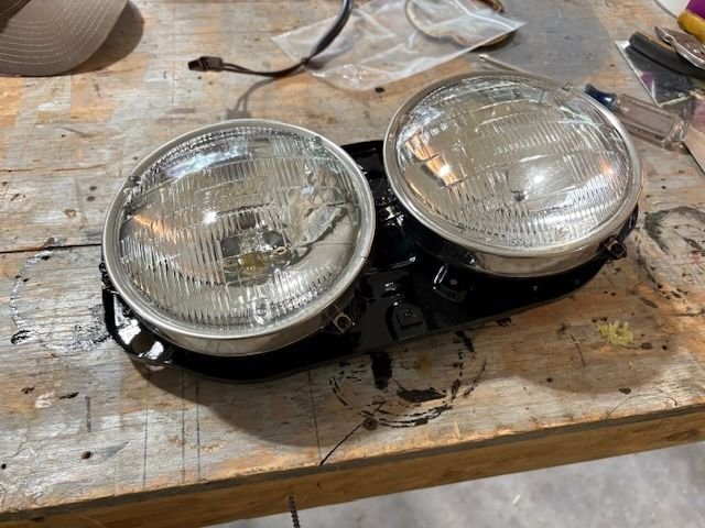

Complete assembly after cleanup and paint.
