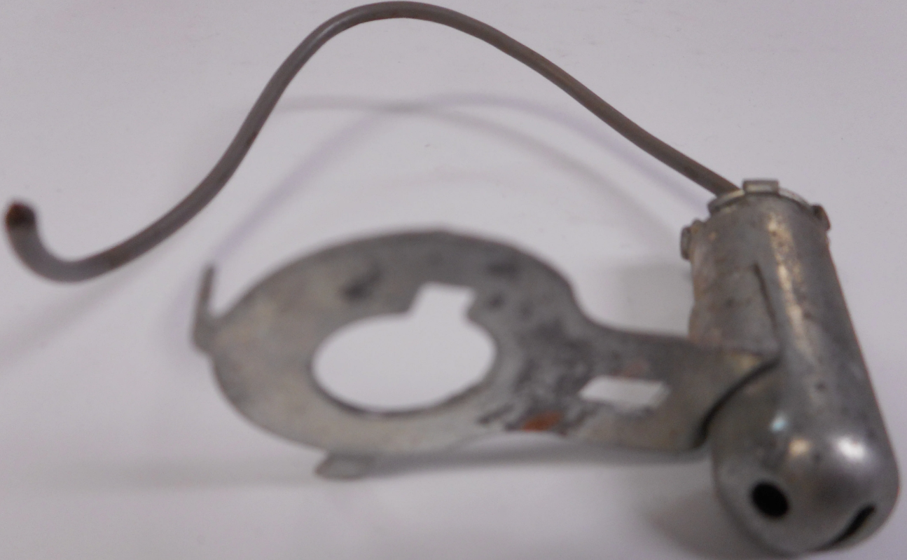

Hello,
Can someone tell me where the wire connects for the headlight **** light for a 72 Olds Cutlass (Base Model)?
Thanks in advance
Art

The grey wire dash illumination curcuit in the dash harness. This is the wire that powers all the dash illumination lamps.

Located in the 1972 CSM wiring diagram...

Thank you!
