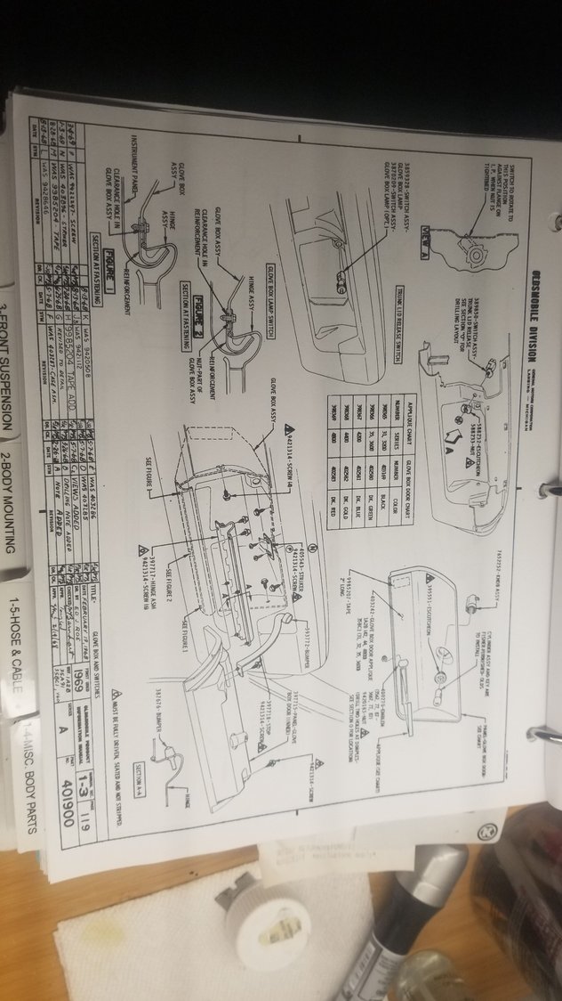

How did you install the hinge? I’m having trouble and it’s very confusing. The new box is in, then I believe the hinge, and then the door.
Old Jan 6, 2023 | 06:34 AM
Phoenix8990's Avatar
Joined: Dec 2018
Posts: 1,162
From: Asheville NC
Hopefully these diagrams will help a bit.
Steve
These diagrams will help a lot. Thank you!
