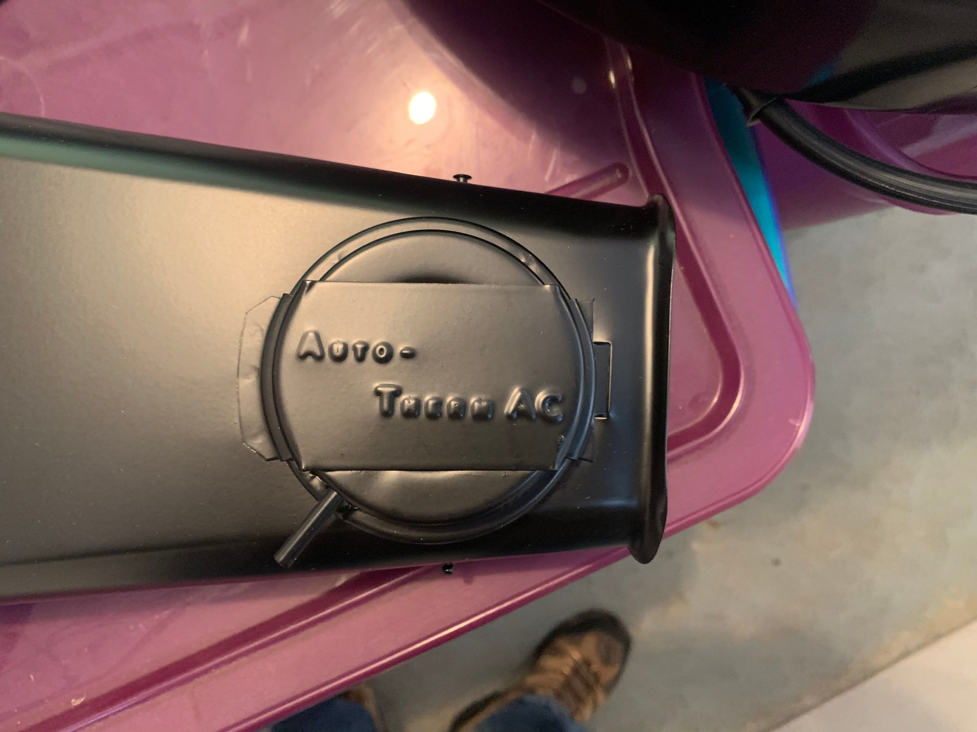

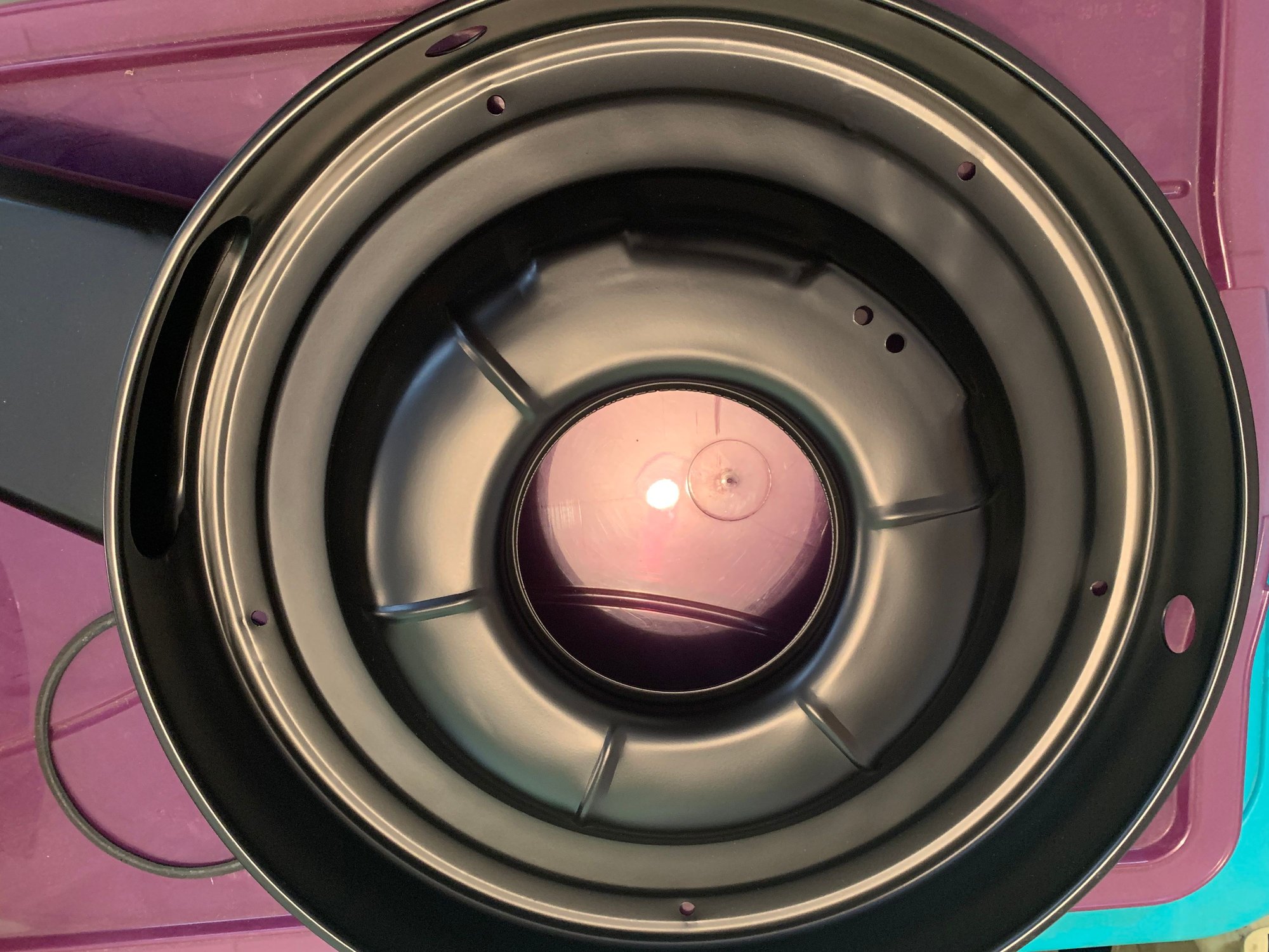

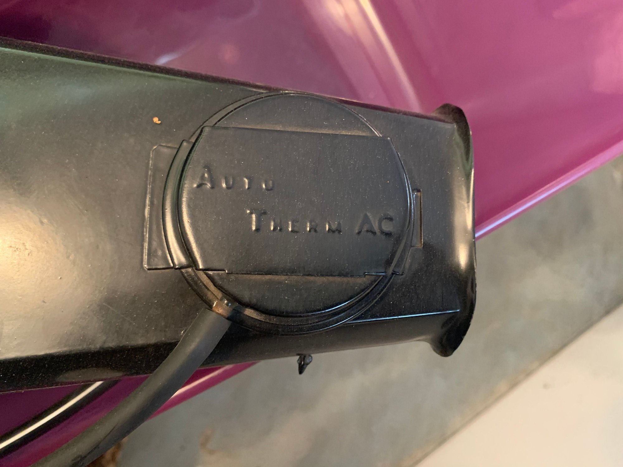

Old Apr 22, 2021 | 07:35 AM
Jungle Cat's Avatar
Joined: Jan 2021
Posts: 378
First is factory with the little vacuum gizmo. Aftermarket has none.
Second is reproduction

Old Apr 22, 2021 | 07:43 AM
Posts: 12,798
There's mold lines in the flapper that are different between the two.
ask and ye shall receive. Unless you have 15 year old eyes you ain’t going to know. Difference is negligible.

We’re there any differences in the Air Cleaner Base Assembly by year ? Was 1970 different ? Some have said that 1970 was slightly different due to the California NA9 emissions option.
In Jungle Cats pictures there is a hyphen between Auto Therm AC on the repro but not on the original ? Why ?
Old Apr 22, 2021 | 08:25 PM
Posts: 12,798
You'd have to ask the people that reproduced it.
